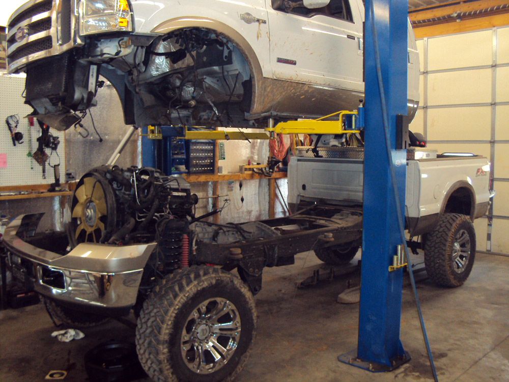

if Ford is such an engineering master why didnt they design a 2 pc. oil pan system ??
Because it would cost more and leak.
i mean really !! a thing like an oil pan you're gonna make accessible by lifting the freakin motor ??? idiots.
You should see what they do on newer vehicles. To do any internal engine work on a 97+ f150 you have to lift the body.
Ever seen a 6.0 getting heads done?
And it's only getting worse. Blame consumers.

that's insane..
