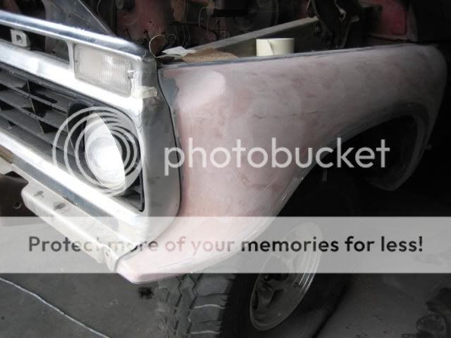

That being said - here are the most recent pics of a project I have been talking about doing for a long time and finally got rolling.
After not having much of any option for larger flare fenders for the 73-79 F series I decided I'd have some made.
Autofab makes a 3" per side flare or a zero flare with 3" taller wheel opening, but since my 74 supercab will get a widened front end and I have a couple other buddies doing the same - I figured we needed another option for fenders.
Keep in mind this thing is just set on the truck for the pics so the alignment/gaps aren't right, and also it needs to be finish sanded before making the mold off of it - but you get the idea.
Let me know what you think.

I think you got a flat tire.
That being said. Looks pretty good, a little too wide though, unless you are going to be running a really wide tire, then it might look okay. But for the size on it now, it is too big IMO. Keep us updated though, I was kidna thinking something like that for my 71.

yeah - I didn't realize one of the tires I threw on it had a slow leak.
As for the flare - before I took the truck to the fiberglass guys I just put some autofab beams on it so I could fit 35's on it as I wanted to show them the tire size I would be running.
When the truck comes back and the real build starts the suspension will be widened about 3-4" per side and it will fill out the flare.

looks like itll work great! How did you form the fenders? Did you just pile on body filler or glass?
Built up with glass and topped off with bondo to make it easier to form for final shape.

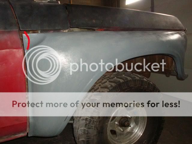

Front revised a bit
And rear as well.
Not 100% happy with the back so looking at one small change and from there the molds finally go in process.

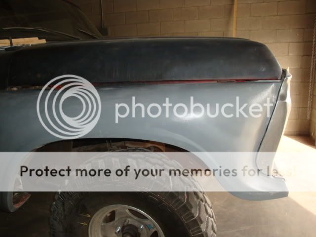

Until then I got some picks after a long wait and another 1 day run from So. Cal to Vegas and back to pick up the truck.
I can finally say I have my fenders
These pics still don't show off the fenders too well, since the trucks not painted and I had to fake the trakc width, but you get the idea.
Since the front end is still stock width (just under due to the bent beams) I moved the driver side wheel out 4" to give an idea of what it will look like with the widened front end.
Here's one dead on with the dirver side wheel out and pass. side at stock location
And last - I didn't realize I didn't get this angle with the tire moved out - so heres one with the tire at "stock" width
More pics can be seen here
http://s453.photobucket.com/albums/q...nders%2073-79/
The glass quality and fit is on par if not slightly better than autofab. That's pretty dang rare in off road stuff now a days!
