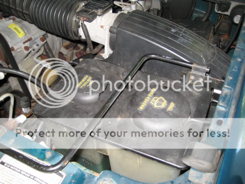

Alright, so I got something done today... I had a bit of time so I cleaned out my interior, put some rain x on and installed my new coolant/washer fluid tank.

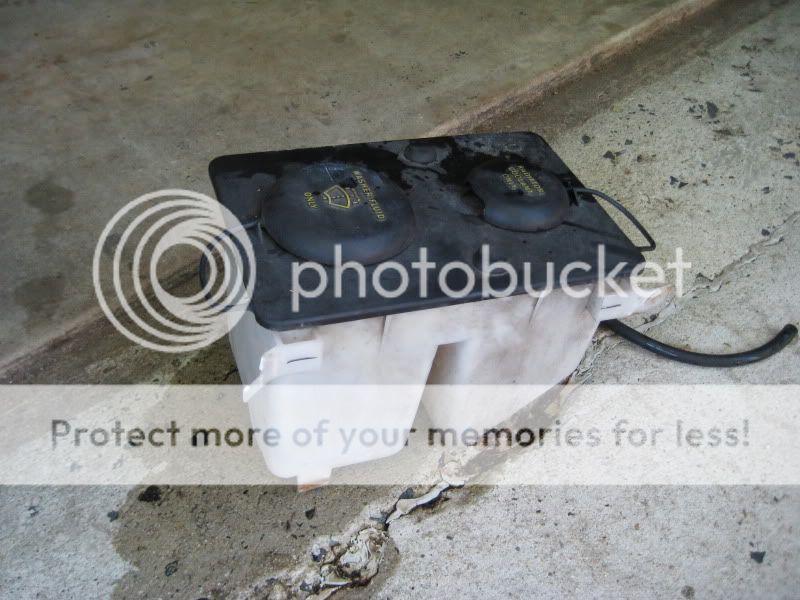

I had to think for a bit how i was going to get the fluid out of one tank into the other.... at first i was just going to drain the coolant from one to the other, but due to hose and wire length that wasn't happening.... So, luckily we recycle
On the left is coolant, right is washer fluid

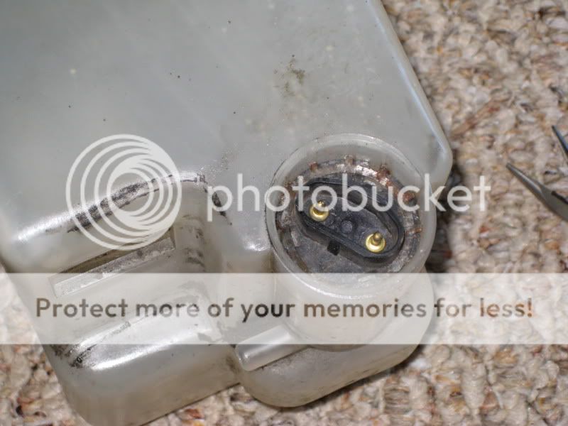

Ok then, here is the old tank all empty, notice the busted tab
I tested out the washer fluid motor in the new tank and it wasn't working... At this time I'd like to give a shout out to Mack24 for selling me a tank with a busted washer fluid motor, you jerk! No I'm just kidding I figured this might happen so I kept mine just in case

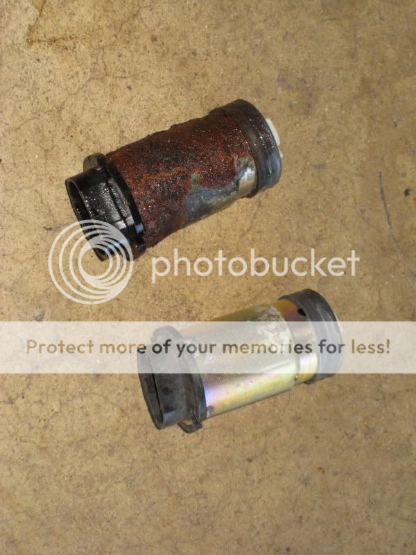

The one on top is the rusted out motor from a 1990 XLT, the bottom one is from my 96. My motor still looks new, the other one was so rusted out it grew in size and the blades wouldn't spin.
Popped the new motor in the tank after cleaning up some of the rust stains inside
New coolant tank in the truck
And I got the chance to zip tie my ballast box out of the way... So for today i say, job well done!

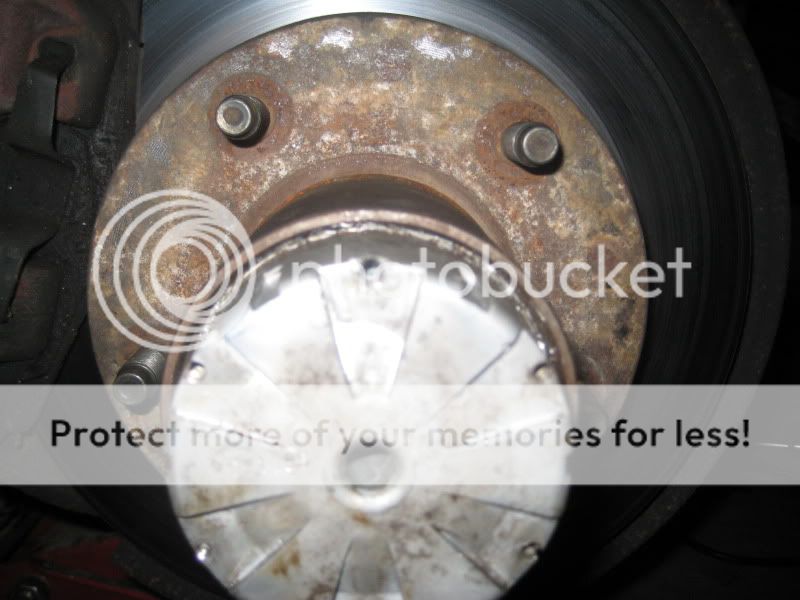

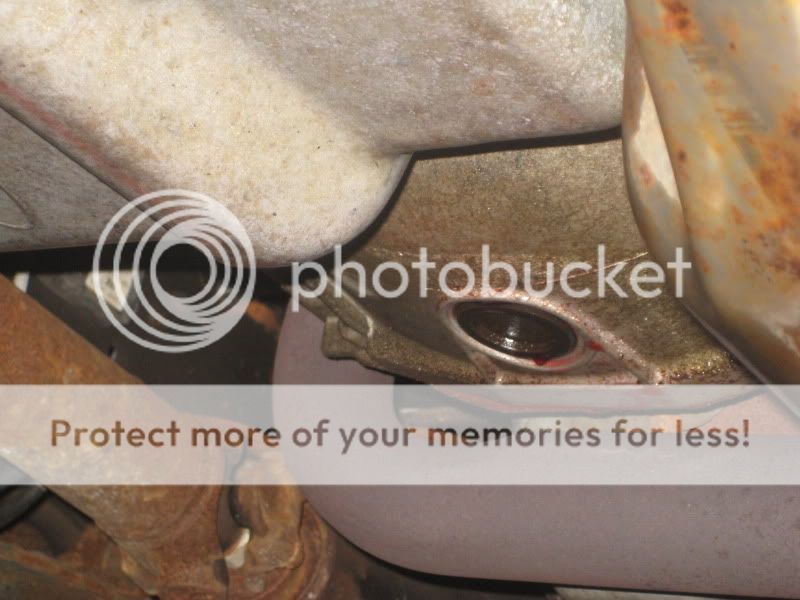

Ok so bad day today.... I did a ton of driving around doing random errands, got my 35's mounted (still have to get the old tires which are sitting outisde the mechanics shop as i type this) got some paint, dropped all the parts off at work and tires and all that..... When I got to work with my 35's i noticed a puddle of red fluid in the parking lot.... My transmission pump seal died, so now that drips like crazy.... Great timing!
Me and my brother started to work on the truck, we got everything jacked up, I was taking the auto hub bolts off but one was really stuck on there and it stripped (this is when i knew we were off to a great start) so we drilled it out, chiseled the head off and got the auto hub cap off..... Now of course we had to get that retaining ring out, which after 15min of looking we finally saw it. Fought with it for 2 hours, broke a pick then took another 30min to get the broken bit out, gave up for the night and its up jacks at work now.... very unproductive day, but hopefully the next post in this thread will be a good one....

Well if it helps, that first retaining ring is the hardest part of the whole process.
Is your pump seal continuing to leak? I've had mine puke fluid before and after it cooled down, the seal held fine again. Just make sure to change the fluid/filter asap and go ahead and add a big ass cooler asap.
I started the truck today and nothing came out, so i'll have to see when everything is done....

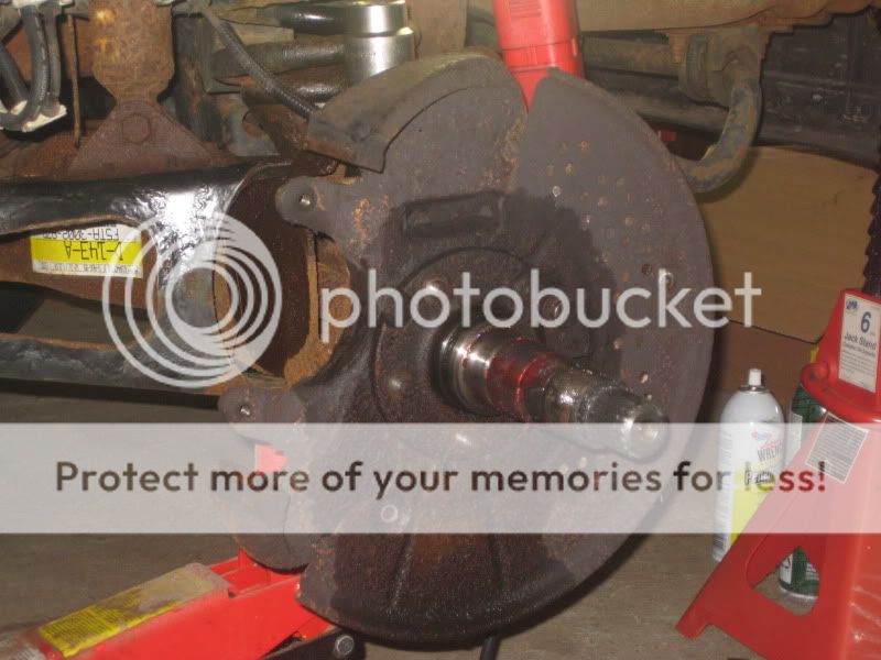

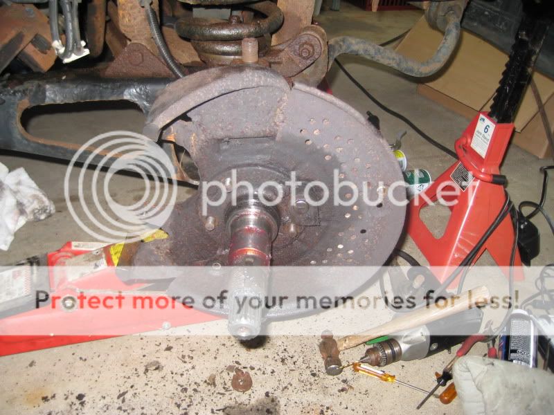

Good news, Kalashnikov got here around 6:30am and we got to work on the truck at 7:30... he got that ring out in literally 30 seconds flat
Here's where we are, we are stuck on the ABS sensor bolts because they are so rusted they are stripping, and i want to try and save my ABS (read thread in noob section)

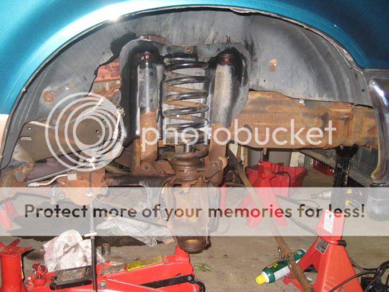

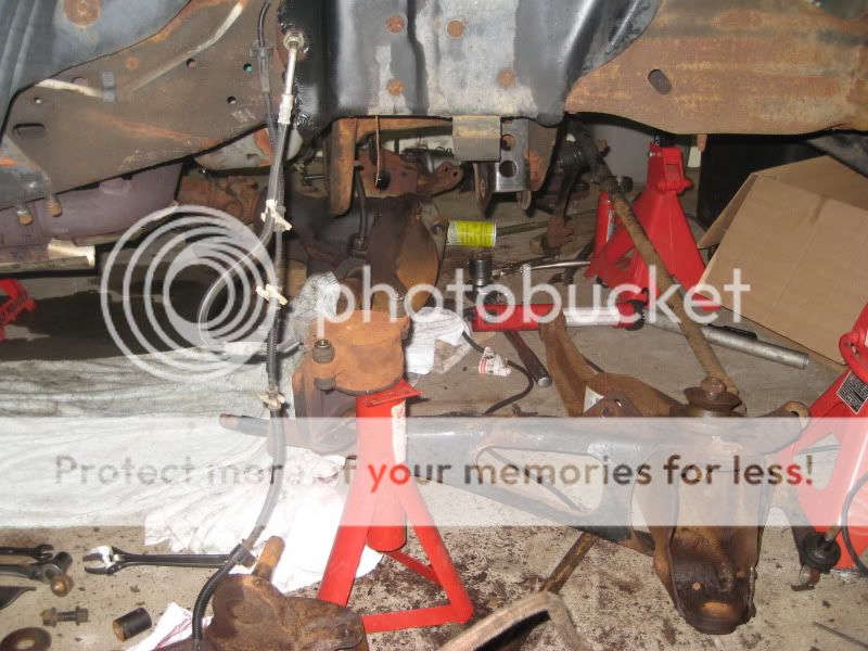

Figured I'd throw up an update, left at 2:15am, got home at 3am....

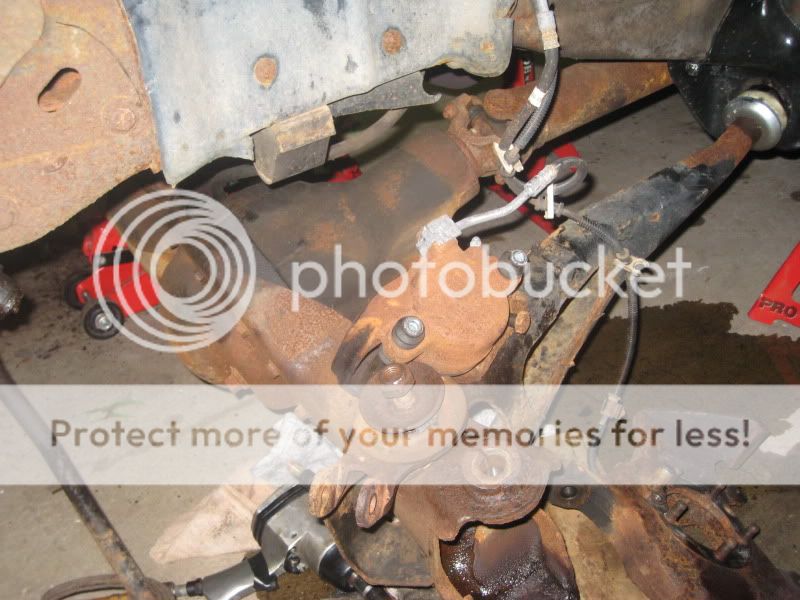

TTB arms are off, radius arm brackets are off, sway bar is off, everything in the front end is apart.... My D44 pumpkin lost all gear oil, so i'll have to refill that before we move the truck
Kalashnikov brought his own BJ press, but not the right socket for it, so we have to go rent one, plus a pitman arm puller
So thats all for right now, we will probably do the ball joints first then start putting the lift on.... Hopefully we can get the front done tomorrow (or... i mean today technically )
here's some pics!
