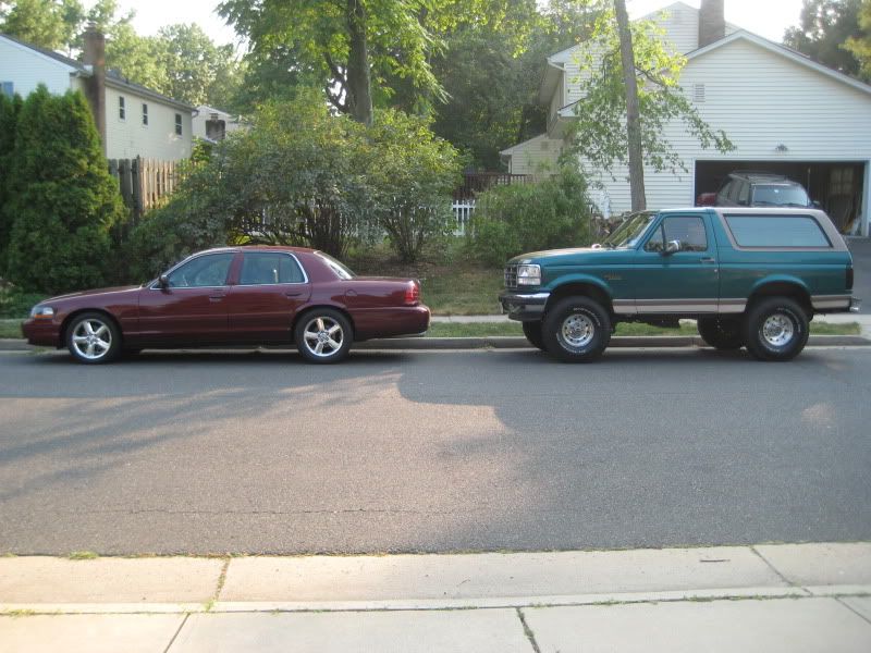

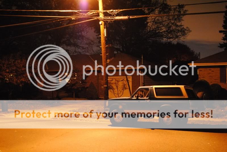

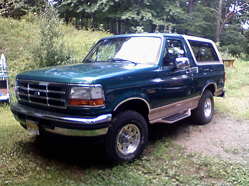

Here is a bit of progression from 3 years ago til now.
Here's a pic i took on my phone 3 years ago
Here is when I went to look at it last october
Then when I bought it. Needed a new battery right off the bat

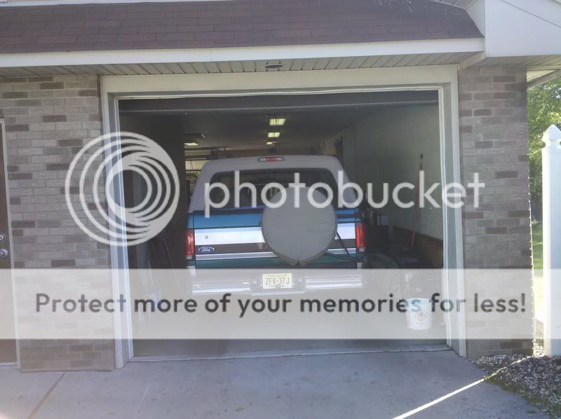

I have my lift in the garage BTW, I'll get a pic of it tomorrow... I still need coils, shocks and grade 8 hardware but I have the brackets and drop pitman arm

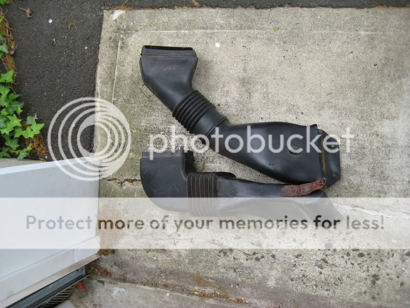

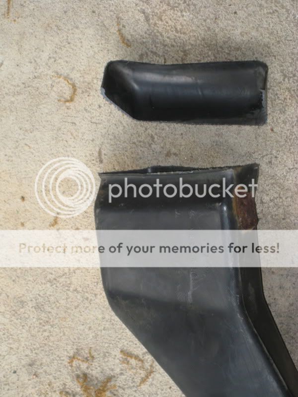

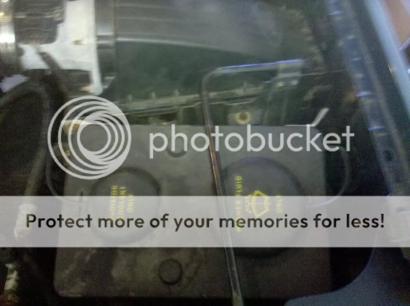

Kalashnikov threw in a 460 intake tube with my lift, so I decided to put it on today....
thanks to ford munky man for telling me how to install it properly
Stock on top 460 on bottom
In order for it to fit, I had to cut this bit off.
now it fits like a glove!

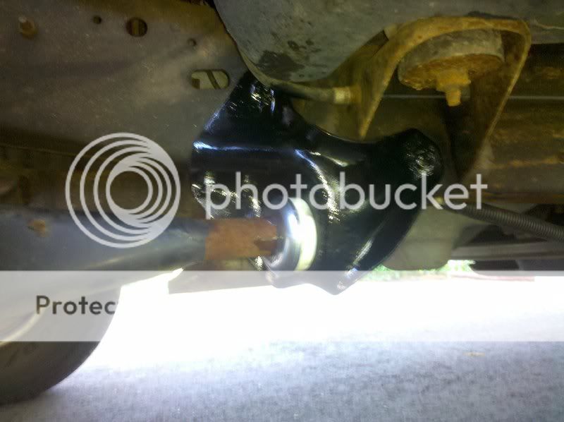

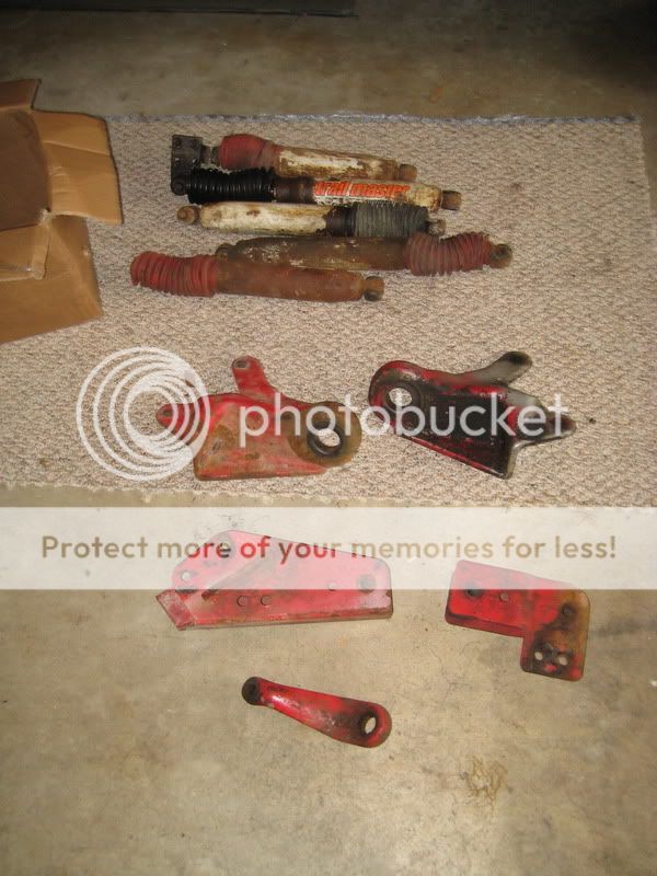

and, as promised, heres the beginning to my 4" lift
Here is part of the superlift standard lift kit.... I am not using those shocks because they are crap, I will be buying Bilstein 5100's. So I need to get shocks, coils and then shackle flip the rear and put this on

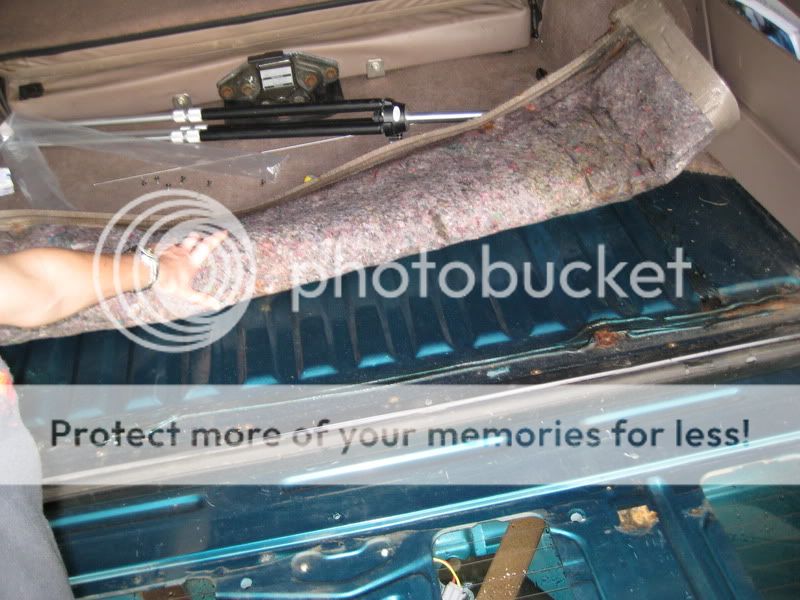

here is a small update for today
I started out washing my truck, and ended up doing something totally different

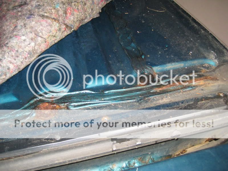

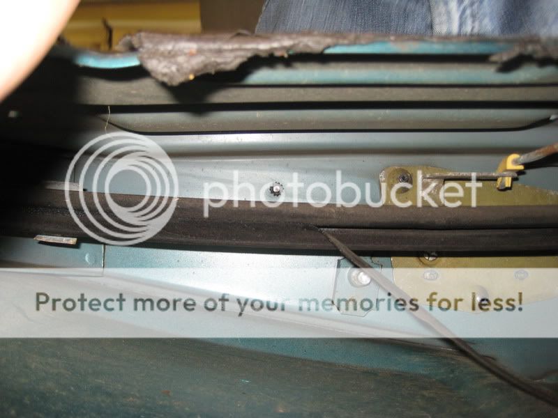

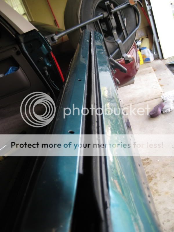

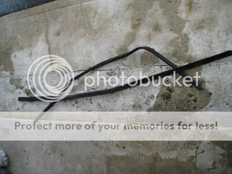

I replaced the weather seal for the rear window finally, no more leaks! Well, the roof still leaks Anyways....
I am glad i finally got this out of the way, easy as cake. Now my rear window wont go up without help though
Old and busted
new and not busted

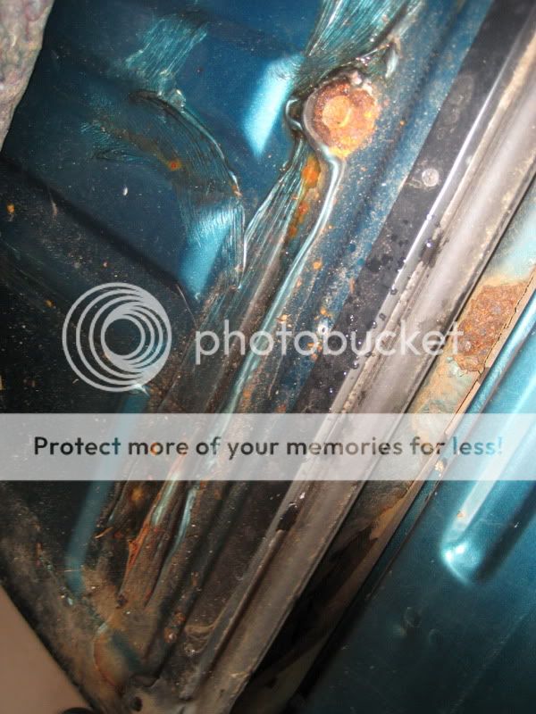

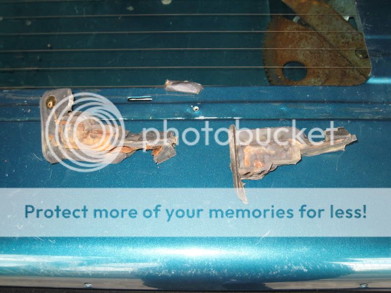

I need to replace these to, they are totally rusted out and just crap....
it was rather wet under the rug... when I am out of school I plan on ripping the entire interior out and just sealing everything... my roof is still leaking, cant wait to fix that
Lastly, can anyone tell me what this is and where to get a new one? its some felt thing that the window rubs against, mine is kinda falling apart

Think this is what you're looking for....item 26 in the lower diagram. They call it a "back glass side run". I would've said window channel, but hey, potato, potahto.

Small update, just got the truck back from the shop... they had to work on the pass rear brake drum because it was making rythmic noises when I would brake...
Also, my drivers side radius arm bushing was shot, that got replaced... the pass side was replaced not long ago...
No more popping noises now!
Oh yeah, the shop even painted my radius arm bracket, to bad its coming off in like two months for a RA drop bracket

Alright small update... tuesday I decided to put my truck in the garage at work to see if I'd have clearence to get it out of the garage when its 4" higher.... looks like I will and then some
Also, I have to order a new coolant/washer fluid tank... Mine was held on by wire since someone lost a bolt... The wire started stretching so I was going to find a bolt to put in there... By the time I got to putting a bolt in (tuesday) I find out that the plastic tab had completely snapped into two... So i cut the wire off, and put a bolt in but I didnt trust the bolt to hold that tank in over the first bump I hit, so I had to duct tape it in place for now... I'll be ordering a new tank and some seals from LMC.... 60 bucks for a tank, ugh
