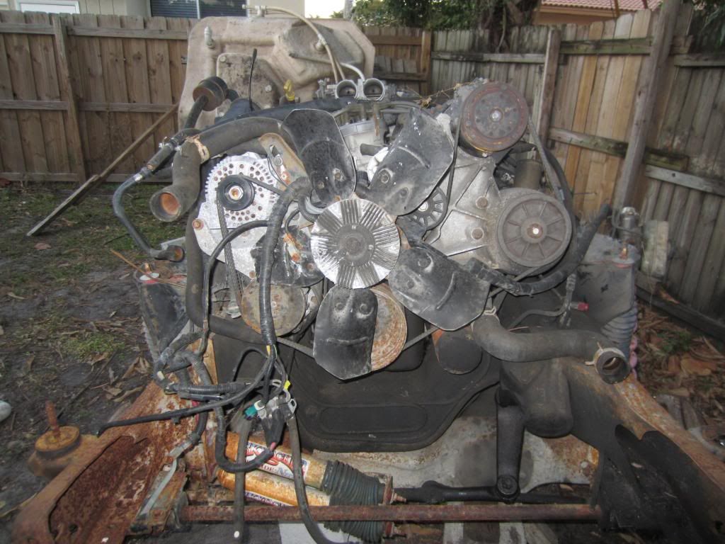

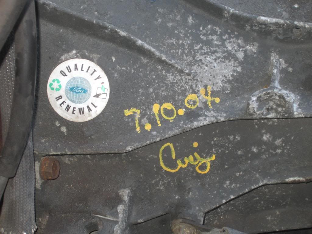

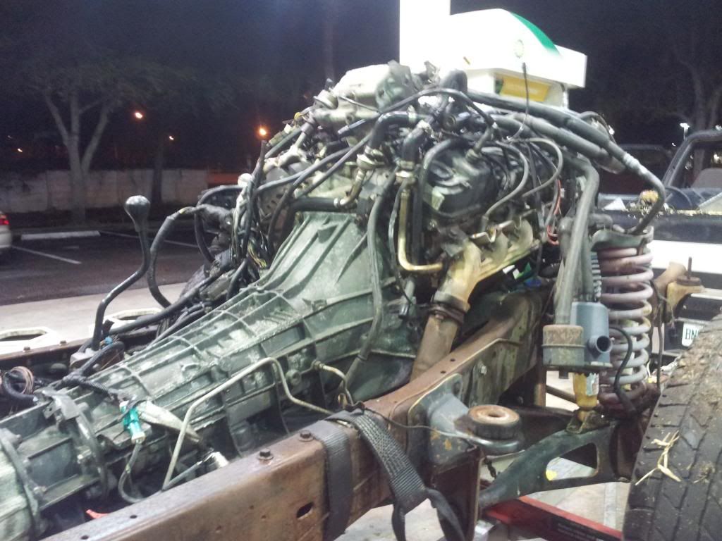

I just recently acquired a 1997? fuel injected 460, more than likely out of an
F2-350 (It says 1997 on the EPA sticker, so I assume is a 97).
This 460 came already mounted on a bronco frame (pre-92 since it has no crumple zones.) According to the P/O, the truck was rolled and the body sold for scrap. The truck seems to have an E4OD that has has rebuilt ford sticker on it with a marked date from 2004.

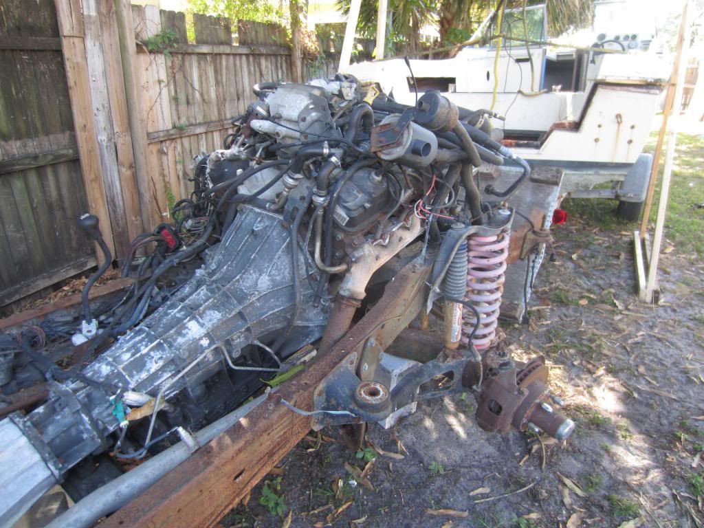

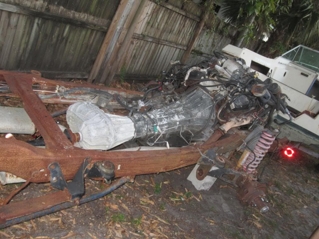

Pretty much this is going to be a slow build as I have other vehicles to tend to, but hopefully I can make my dream truck a reality.

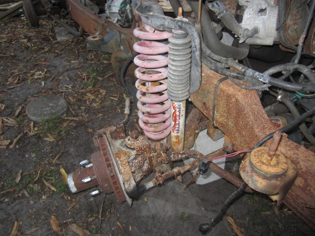

Before I move on with the photos, my main concern at this point would be the suspension on that truck. It looks like a SAS is a good idea, but I won't be running anything larger than 35's on that rig. I'd like to keep cost to a minimum.
The frame looks like its been sitting for a while (guy told me 5 months).
I bought the frame dirt cheap, so nothing has been tested.
I'm not sure which route to go yet, so I'd like y'alls opinion on what I should do with this thing.
Oh btw, I have a '93 Bronco with a 351 in it, with a 4" lift.

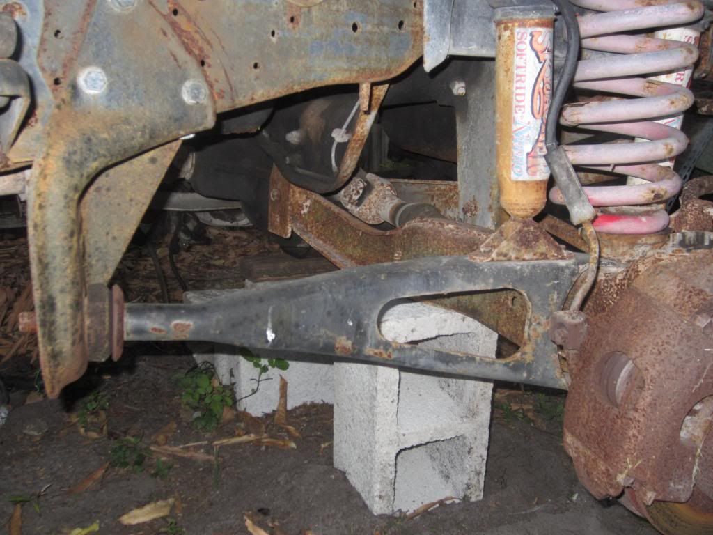

I'm not sure how much lift the frame has, but it looks like a 6" though. Drop bracket has been welded to the c-member so that's a good sign. Its missing several suspension pieces.

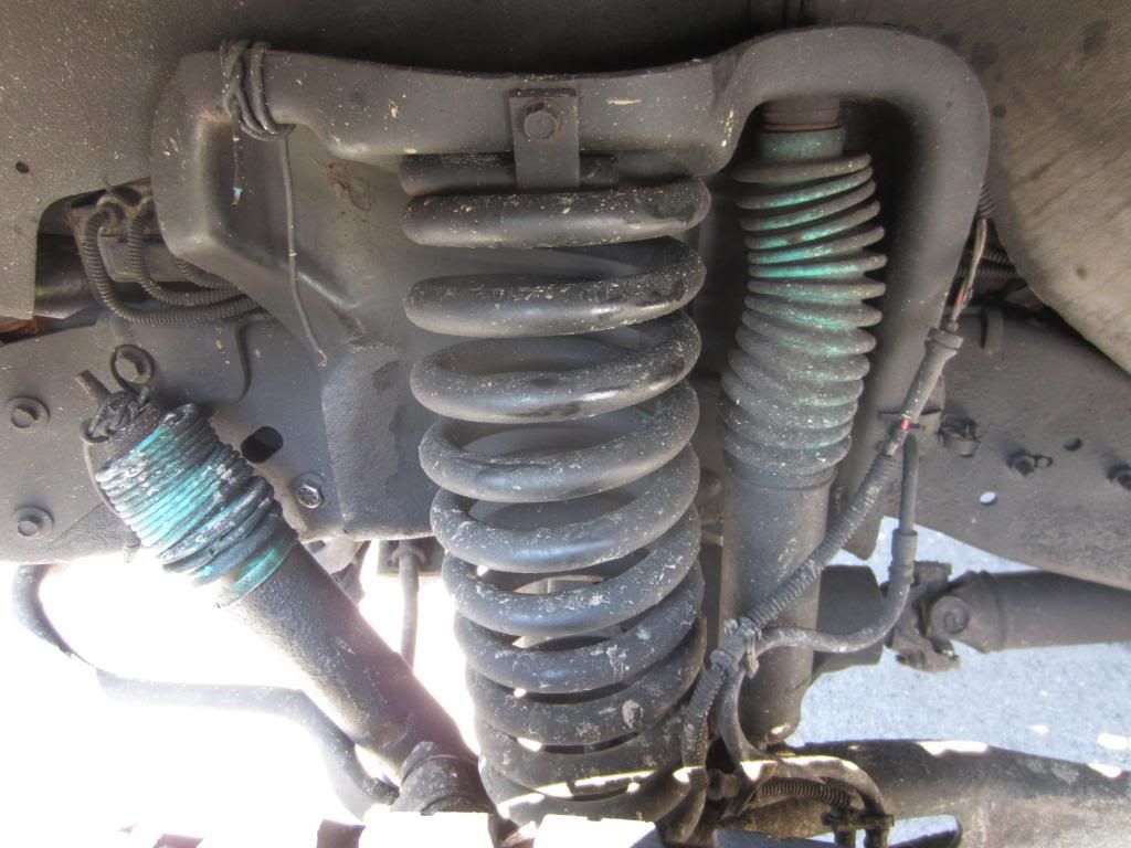

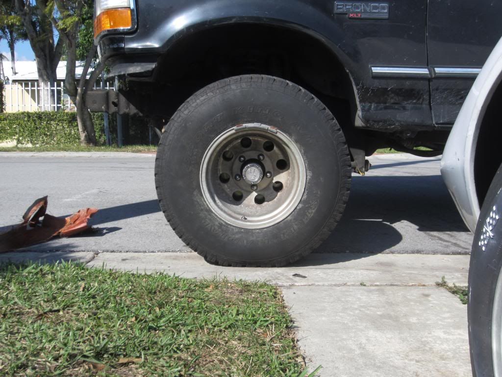

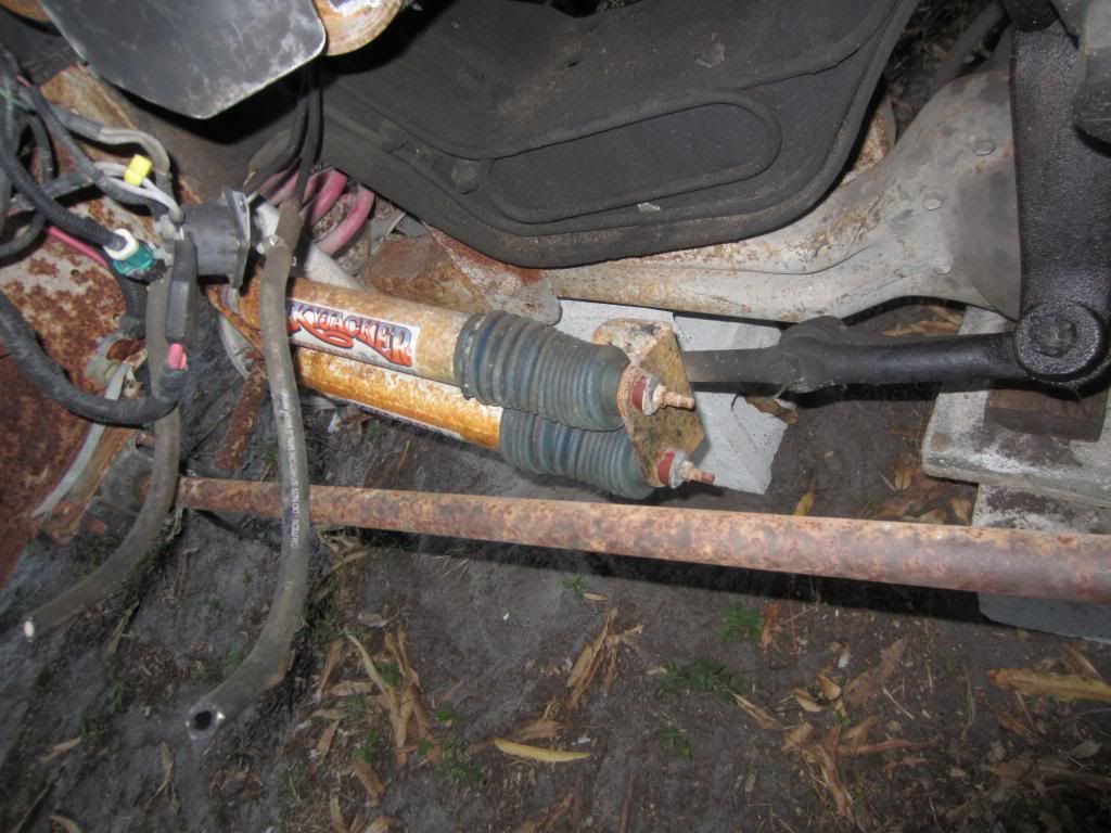

It has gone quite a long time without any suspension maintenance, and now the truck is not driveable. It has major vibrations starting at 40 mph, and it pulls hard to the left. I thought about pulling the suspension from the other frame, but it seems as if they're both in the same shape.
I'm at a crossroads now in deciding where to go with this. Its either go all out and do the 460 swap, or get the suspension good so I can at least drive it (My DD is not doing too good now.)

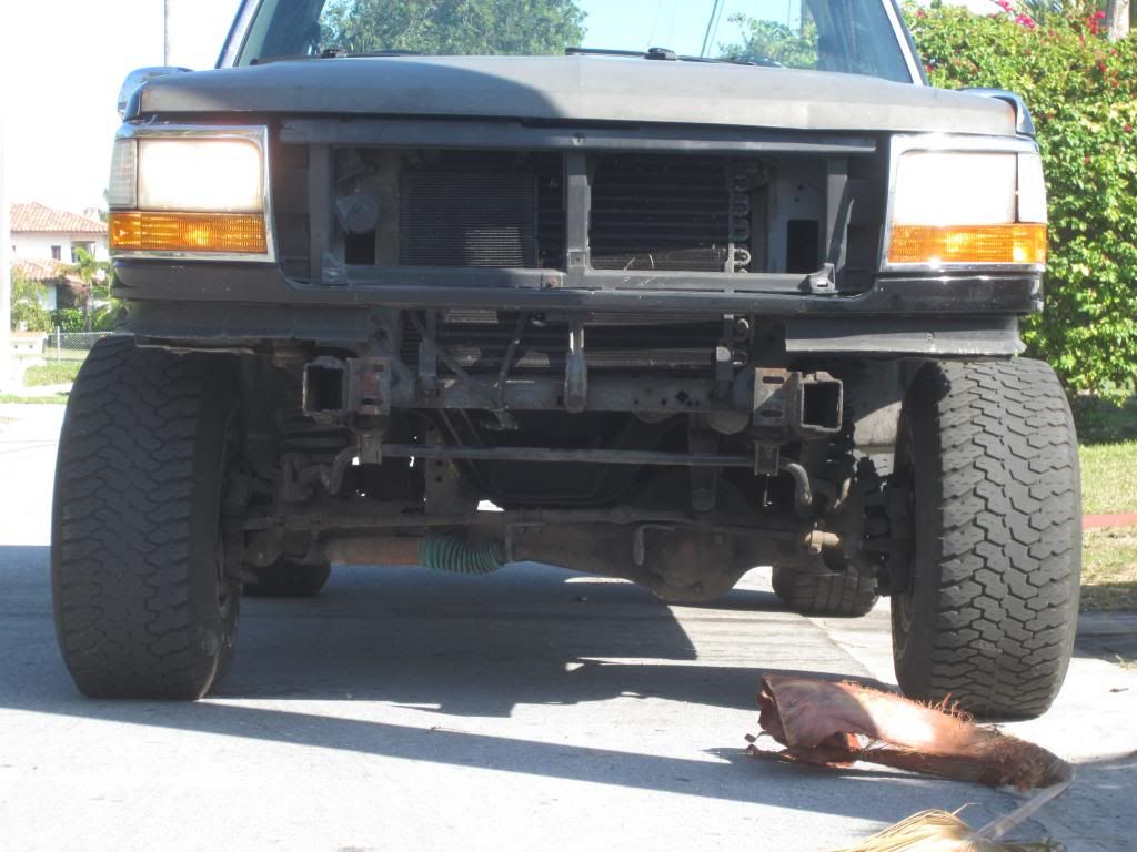

It almost looks as if my front TTB has shifted back a bit. Look at how the spring is not straight up and down, but has a curve to the right. It rubs when pulling out of my driveway with the tires full lock to the left. This could also be from sagging suspension due to shitty/missing/broken shocks.
Let me know what you guys think and what I should do. I'd like to get the Bronco back on the road, but then again I'd like to see the 460 become a reality. I just think that swap will cost me way too much money right now, unless you guys think I can do it with what I have now.

The frame has a 4" lift. Look at the ttb drop brackets, they are set to the 4" position. Clean to frame up then clean your body up and put it atop the new frame. Job done.

Looks like a body on frame swap would be the most logical thing to do at this point.
I'll need an ECM for the '97 460. There seem to be several ECM part numbers for that engine model year.

IF the engine and trans is good in the '93, and the only thing wrong with it is suspension maintenance, then the "logical" thing in my mind would be to just go through the suspension. it's easy and cheap to change the bushings and shocks. and you can do an alignment with a measuring tape.
either way, get rid of those RA drop brackets and get extended RA's (radius arms) and stock brackets on the frame 15" back. RA drop brackets lead to problems.
TTB isn't as bad as some make it out to be. as a matter of fact, some (like me) prefer TTB over a "solid" axle. it has a few very notable advantages.

My truck currently has about 164k. Truck starts right up every time, just leaks oil. Trans has a hard clunk into 2nd gear. Other than that just needs suspension and tires to be addressed.
I may go through the 460 and do some upgrades before I put it in, not looking to do crazy stuff but looking for that low end grunt that the 460 has. I have a '71 Lincoln Mark III with the 460, so I know what that's like
Hopefully this will turn out well.
My plan is to go through the parts frame and disassemble everything, paint it all up and fit it all back together. There are some aspects of the way the 460 was installed that need to be improved on.
Should I use the parts frame or my '93 (crumple zone) frame?

your suspension is messed up because you didn't lift ttb the correct way. Wheres the extended radius arms?
Then decide if you're putting new gaskets in the 351 or puting the 460/e4od in your truck. THat is IF the 460 is still good.

Was comparing a friend of mine's Bronco with my own, and it appears my suspension hasn't shifted back or anything, it just needs some maintenance and new tires to be good. That 2nd gear shift is a pain though. It always starts with a high idle too, no matter the temp.
I'll get my 93 up to par with suspension and tires and when the frame is prepped and ready I'll transfer everything over. Is there a way to tell what year frame that is?
