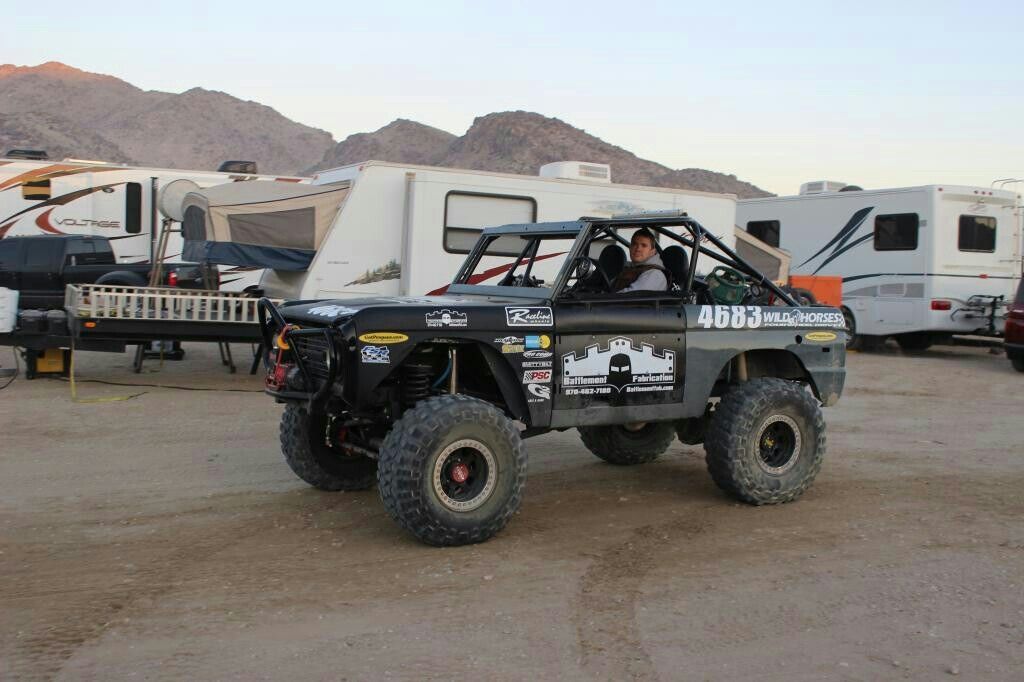

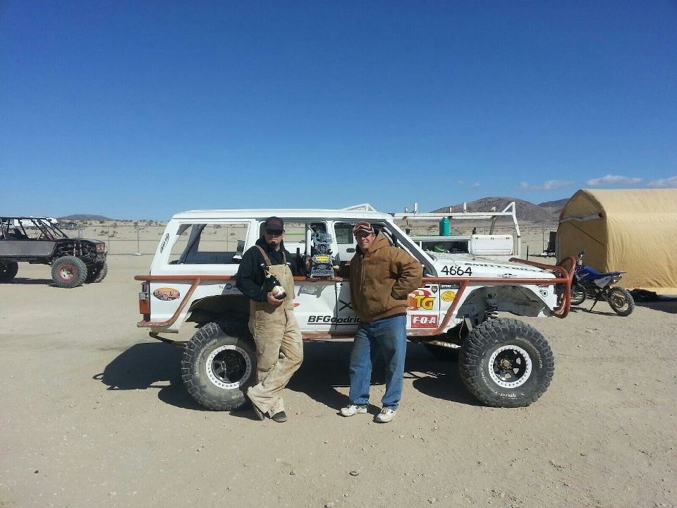

In the stock class the vehicle must remain the same "type" of suspension as came in the vehicle. I'll post a pic of our 4600 car
A solid axle must stay solid, an ifs must stay ifs, but within they type, any upgrade can be made...the Cherokee has sold Toyota axles...

Stock class early bronco an acquaintance was running

Btw, there is only about $8000 into the Cherokee... it helps when you have a welder, bender, and several mechanics on crew.....
