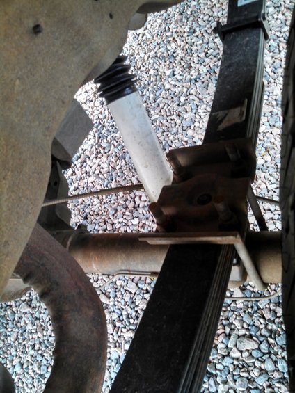

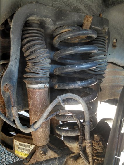

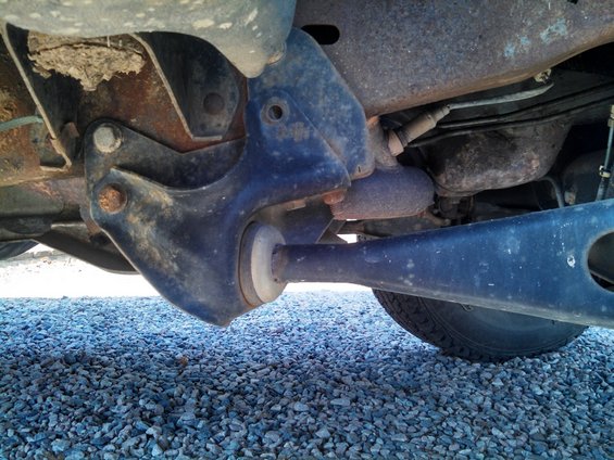

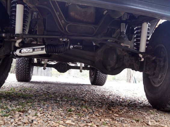

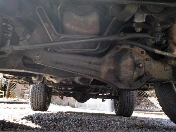

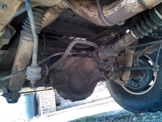

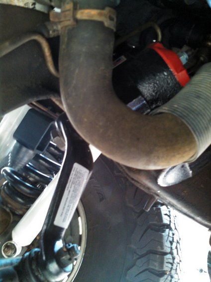

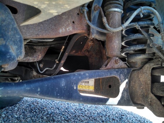

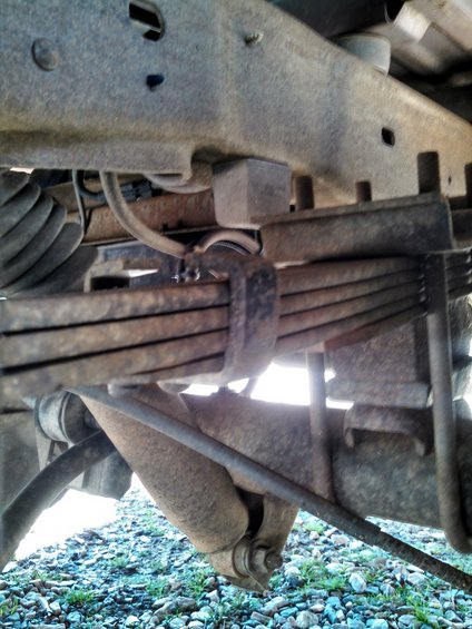

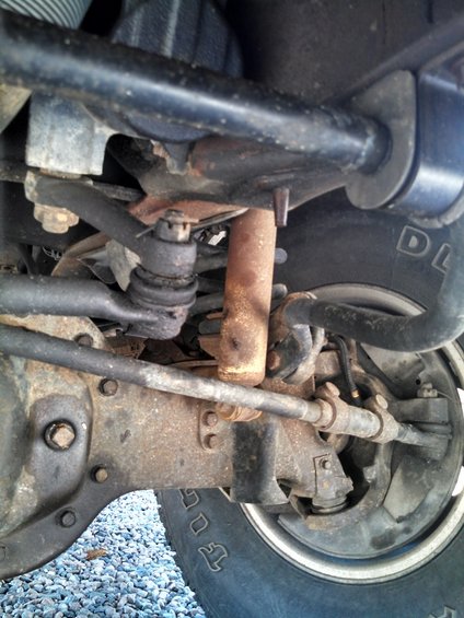

Okay, I've been putting this off for too long now...
Here are some before and after photos of some of the work I've been doing lately.
Before...
OLD STUFF: Rough Country 2.5" lift, drop radius arm brackets, blocks lifting the rear, Hecklethorn shocks & stock steering box and pitman arm, 33x12.50 tires, stock 3.55 limited slip differentials (front and rear)
After...
NEW STUFF: BDS 6" suspension lift, BDS springs & shocks, BDS steering stabilizer, BDS extended radius arms, BDS extended bump stops, BDS drop pitman arm, tie rod ends flipped to the top of the knuckle, sway bars off, extended rear steel braided brake line (still waiting for the fronts to come in), 35x12.50 BFG's, Detroit TrueTracs with 4.56 Yukon/Motive gears (front and rear), Fresh vent visors, and seat covers
Coming along nicely!
She drives GREAT after doing the TRE flip and getting a decent alignment!
Next step is to make the "quick disconnect" sway bars. It's not too bad with them off, but I want them back on before I need to tow a trailer again.

I noticed on the old TTB RA drop bracket you showed (right side) one bolt was missing. Even with this new lift, you should add 'inspection/service of RA hardware' to your rig's care and feeding. No sense getting laughed at on the trail because an RA bracket gave you more 'drop' than you bargained for. Also, have you serviced/replaced the front axle shaft u-joints?
There is a story about that bolt... Not very long ago, I was out of state helping a friend move back from across the country and my wife needed to use the Bronco for something. While she was driving, it started overheating. Since I was away, she took it to a local hack of a mechanic. The actual problem was just the thermostat, but they sold her on a new radiator FIRST, then they told her it needed a new thermostat and radius arm bushing too. It did need the radius arm bushing. I already knew this part. Anyway, when I got it back, it was missing a bolt. I took it back and they swore it was like that when they got it, and that it would be fine without it. Whatever. I knew I was getting ready to do the new lift anyway so I didn't worry about replacing it. I did do some (very) light wheeling with it like that and it didn't budge, but obviously that wasn't going to be permanent. They also botched up the radiator job a lot more than I thought it was possible. I had THREE separate clamps that they installed fail from that same job! How in the hell does THAT happen?
And no, I haven't serviced/replaced the front axle shaft u-joints yet. Thanks.

Originally Posted by Mangonesailor View Post
I have an app on my phone that helps me track maintenance like that. Its called "acar". I track my milage with it too. You can also add maintenance items and edit the month/milage intervals. Pretty neat if anyone else was interested.
TJ, you have me sold on an extended radius arm type kit. I have been curious about how low the arm brackets from the frame were, and how much ground clearance I would lose just for added articulation. I think it'd be just fine.
I still wouldn't mind making a skid plate for under the trans. Besides the t-case thetrans, and its cross member, are the next lowest and exposed ccomponents.
I don't think I lost any ground clearance at all with the extended radius arms... might have even gained a little. I lost some clearance with the old drop brackets for the stock radius arms, but the mounts for the BDS extended ones are MUCH more "low profile". The new arms MIGHT sit as low as the old brackets but I definitely don't think they are any lower. (especially if you consider the whole truck also just got lifted more).
They seem so. I'm concerned about whenever I will become high centered what will I be stuck on in terms of what is under the vehicle. With those brackets and the radius arm ends the way they are... I think I'll go with them. Eventually. Got to get my house first and all.

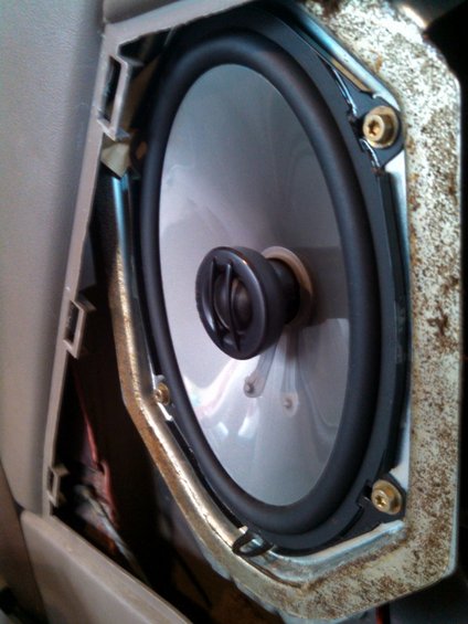

nice upgrades for sure. Where are those seat covers from? They are probably the nicest i've seen yet
The brand is called Pro Elite, and I believe the style is "Princeton". They were like $30 from Auto Zone, I think. The last cheap set I got from there also looked great and lasted me for almost 14 years! When I took them off my original seats still looked PERFECT underneath. So I figured lets see if these will last another 14! I am very happy with them, especially considering the price.

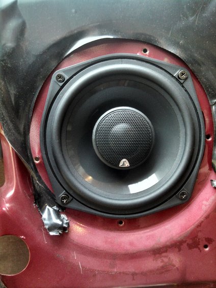

So right before I started all these upgrades I did one other small upgrade that I was never satisfied with... I replaced the inside window run channel on my drivers side and the clips on the replacement would never quite reach, and my new run channel would pop up every time I closed the door. Which is the whole reason I replaced it in the first place... my old clips were broken. Anyway, I decided to take the door off and fix it for good. I drilled a small hole and just screwed the run channel to the inside door panel. Problem solved. Headache gone.
While I had the door panel off, I figured it was a good time to snap some pictures of my recent Audio overhaul. I replaced and significantly upgraded EVERYTHING... all the way down to the heavy gauge speaker wires.
Kenwood Excelon head unit.
JL Audio C3 components 5.25's up front (Crossovers hidden in the kick panels)
JL Audio C2 5x7's in the rear.
JL Audio MHD900/5 (500x1 + 100x4) Marine amp powering everything.
JL Audio 12W6 in a SMALL sealed JL Audio box.
Sounds GREAT now! And I LOVE having Bluetooth and being able to stream music from my phone now, and the hands free phone calls when I'm driving (head unit also came with a mic). But I really should have probably done some type of sound deadening everywhere first. Oh well, I'll save that one for another day.

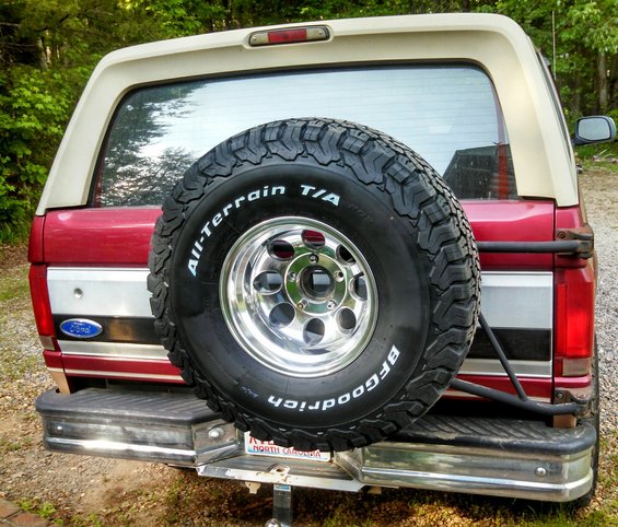

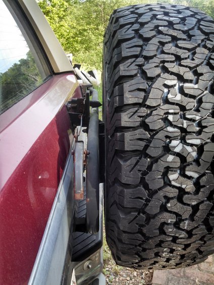

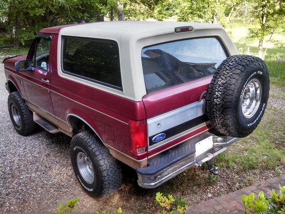

Got my new full size (35x12.50) spare and new wheel in and mounted up today! My old one was SHOT... and too small.
14 yr old 33x10.50 spare, stock wheel vs. new 35x12.50 spare, 15x10 wheel
I thought I might have to modify the carrier a little because of the wider tire, but because of the offset it actually fit better! The 33x10.50 on the stock wheel was touching the carrier.
Now I need to finish polishing up the rest of the old wheels.
