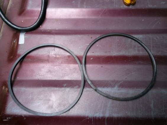

Spectra Premium LO04 Fuel Tank Lock Ring Gasket is too big. stock gasket is on the right. spectra is on the left.
by dashcam in a 96 @ fuel gauge not coming off "E" - signs of a bad float?
