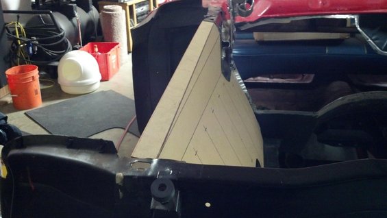

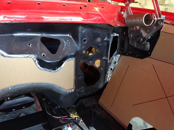

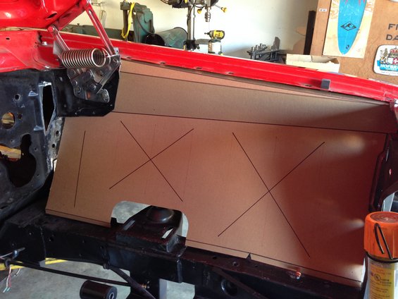

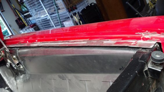

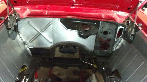

Patterns for new inner fenders
Layed out an "X" pattern but I think I like the vert lines better
Anyone know what these numbers mean and do i need to keep them? They are under the hood hinges.

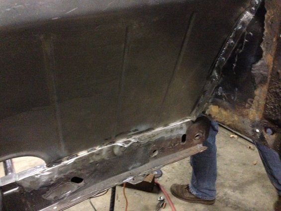

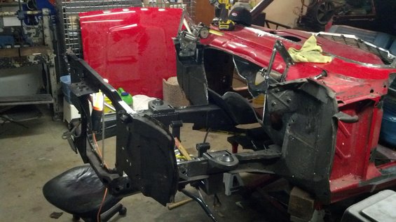

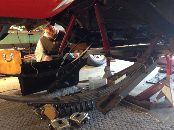

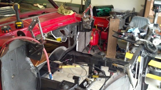

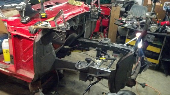

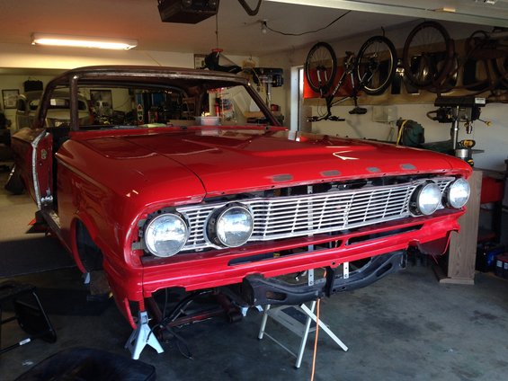

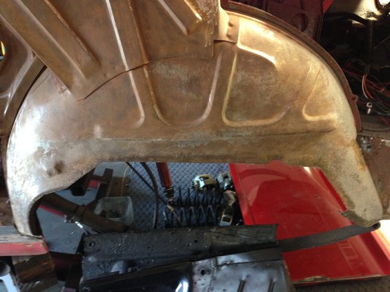

Cut out cancer/booty fab from the wheelwell
Cleaned excess metal flanges, prepped to replace the quarter panel.

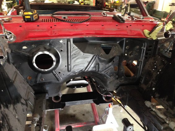

Inside of the firewall patch
Clip back on to see how things lining up
Set the grille in

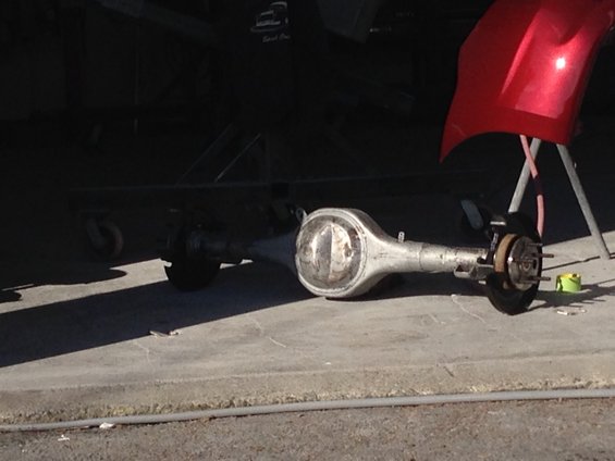

Axle gone!

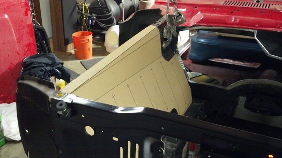

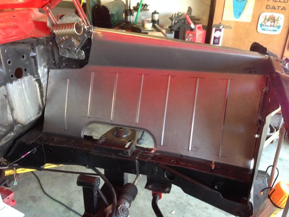

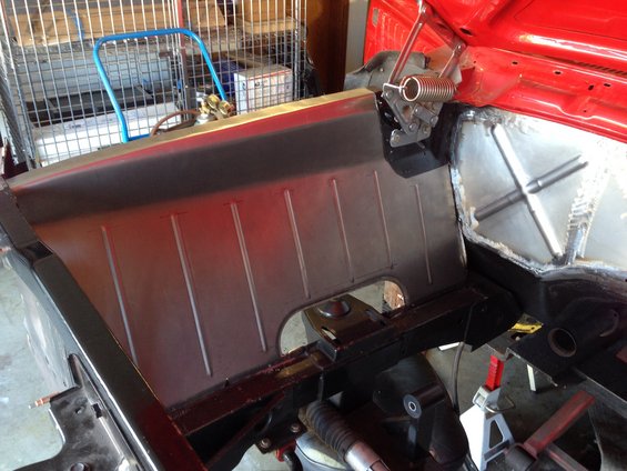

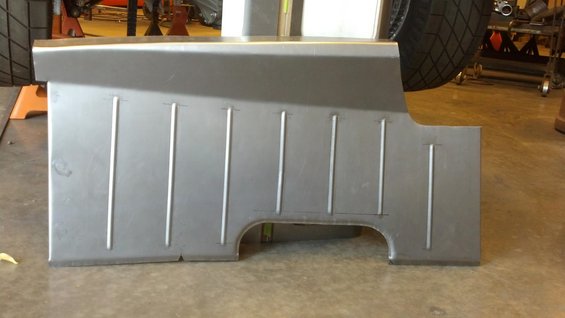

New Pics...
Axle at the paint shop, having difficulties removing the silver paint..maybe powdercoat?

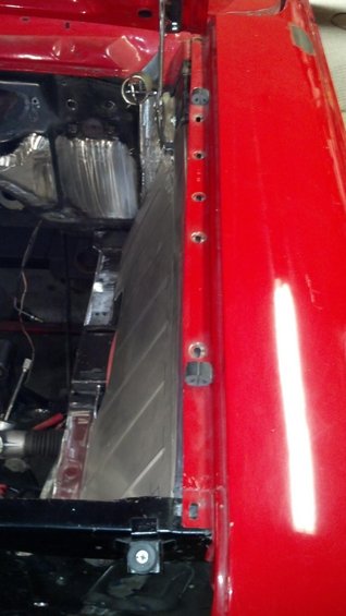

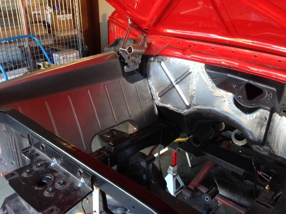

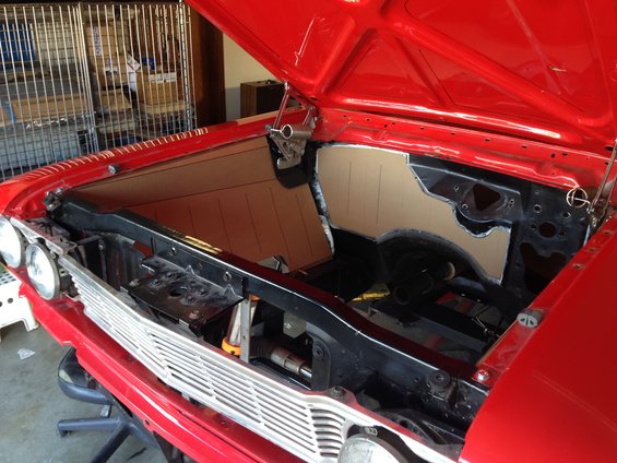

Replacement inner fender
Clamped in place
Firewall getting welded up (old column mount gone, wiring holes gone)

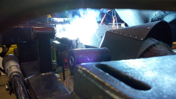

Cool welding Pic

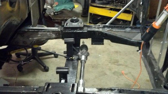

We are plating the "Frame" between the Mustang II front end and where a tranny crossmember/subframe deal was done before I got the car.

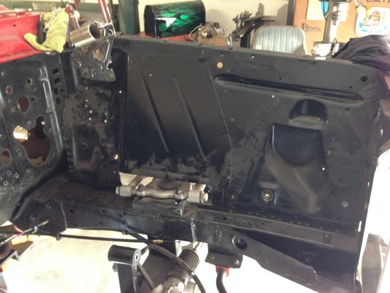

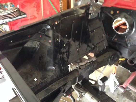

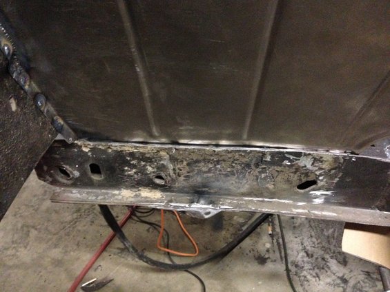

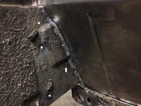

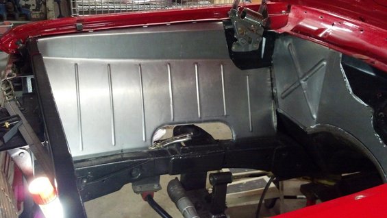

Fuzzy pic but you can see the plated framerail, and we boxed the support under the radiator

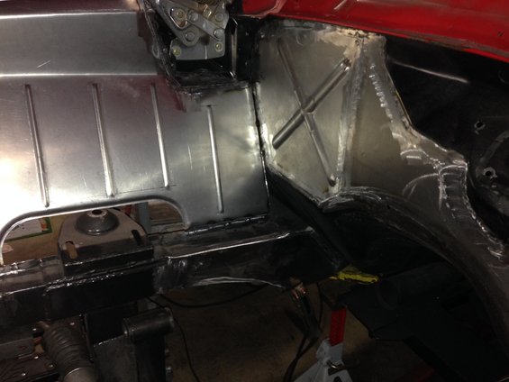

Inner fender welded in..lots of work in the rear outer section where the steering box used to be...much cleaner now
Front area where the strut rod used to be.
Flange for the core support
Passenger side

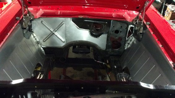

Inside look
Outside again
