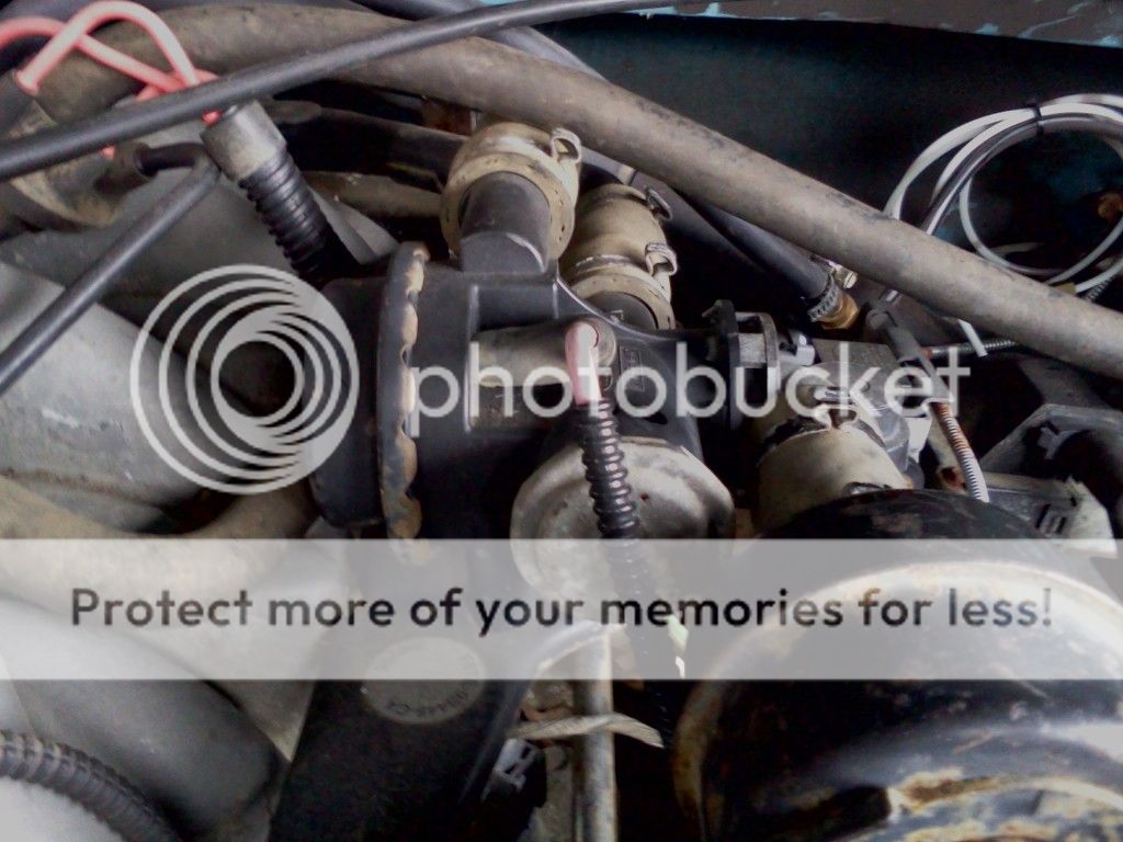

what is this in center of pic, right in front of the tad and tab solenoids? Is it the diverter? Every picture or diagram I've seen is differant than mine.
I get a ticking sound from it, is something missing? I appreciate any help.

All the pics you find here will be different because Broncos weren't offered >8500GVWR, and that arrangement is specific to heavy engines. But it's a combined diverter/bypass valve that works exactly like the one used on lighter trucks.

Thanx, Steve, I appreciate the reply. I just thought somebody had to have swapped one of these before. Now my question is, why do I get a ticking sound from it? If i cover the two holes under the red vacuum line, it gets quieter, but doesn't stop. Thanx again.

It's under the hood right? These are from my first post in this thread:
Originally Posted by Steve83 View Post
Follow the links in the captions for more info.
