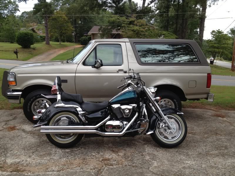

He is supposed to be getting some more pics tonight. This one is from the ad.

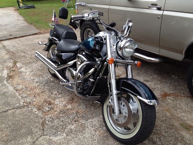

1999 Suzuki Intruder 1500. Not pictured but included: extra large hard saddle bags and windshield. Just put on new tires.
http://auburn.craigslist.org/mcy/3391990014.html
