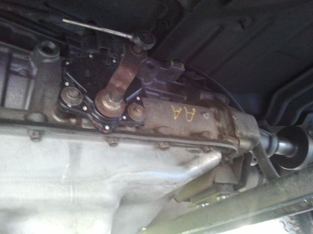

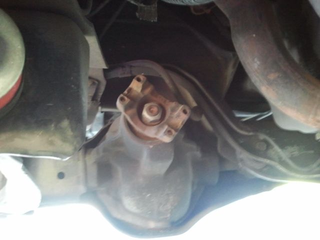

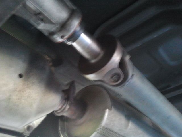

X2 on the pics. I would want to see several underside ones to see what he's removed. Maybe he just "disconnected" it and left it in there.
If he's swapped to a 2WD transmission, you will need to swap it back. You'll need the adapter, transfer case, probably a rear output shaft, (+the know-how to swap it) as well as the correct driveshafts. Who knows what else he mave have removed. If the front TTB is gone.......you might just look for another truck....or a cheap donor.
What about the PCM, perhaps he changed it so it wouldn't throw codes.

ill post pics tmrw. the axle is still there and back driveline is connected to the tranny and the tranfercase was romoved fersure

I'm sure curious to see the pix. Changing a FSB to 2x is no small feat. Can't imagine what would have gone bad that wouldn't have been cheaper to fix than do that massive a swap. Certainly the trans has been changed/modified plus a custom drive shaft made up. In addition some sort of rear trans mount had to be added. Plus as stated before something probably had to be done to the computer (or the check engine bulb removed). Gonna be a bunch of work to get that back to 4x4.

the PO probably couldnt afford a rebuild on the tranny and found that tranny cheap somewhere. probably never used 4x4 so didnt bother him. all he would have to do then is new drivesahft. i dont think a transfercase will cause any codes

It's easy to swap a '91 FSB over to a ZF 2wd -if- you got a donor truck. :)
No kidding on that. :) A >8500# '90 F250 is what I bought.
Doggonit I deleted the stock-E4od-FSB-L-shaped-crossmember pictures! :/
Took 'em for a guy on FTF website forum. ;)
You got a 2wd there or a sorry-assed "one wheel wonder"?
Even my half wornout 8.8" LSD still works good enough for now.
Lots of guys have put limited slip in their rear axle and found they hardly
ever used the 4wd after that.
BeenThereAndAlreadyDoneKnowedThatOne! xD
Even done knowed that before late Nov of '74,
...my '75 F150's got Traction Lok. ;)
Check your rear axle tag...
But also your VIN plate, AXLE = H9 (has a letter) means it's an LSD...
x2 on the title.
<---------------and fill out your stuff.
I got a "like new" 1356E just sittin' here, but you gotta be close to get it.
It needs to be swapped to manual because the ATF messed up the wire
insulation and there's no use fixing such a silly idea as an electric transfer
case. :/
