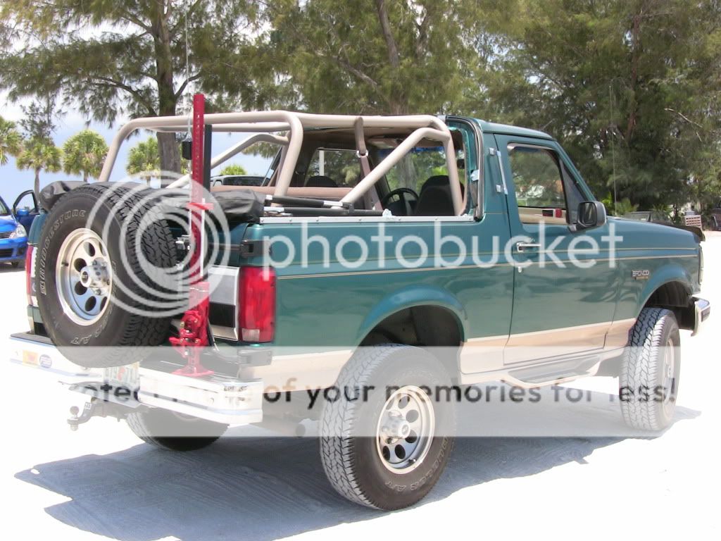

This is what I did.
The build
http://www.fullsizebronco.com/forum/show...=188400&page=4
I ordered the rear cage from jbg and had a local machine shop weld in bungs into the rollcage. Than I had linex coat it and match the interior color to the coating.
Well that was my old rig. I'm in the process of transferring all the goodies to my new rig.
Other option would be to get a rear seat from a older bronco with the lap belts built into it.

Ewgoetz, looking at the pics of your cage, it looks like it would be difficult to access the bolts at the front of the factory hardtop.
How is the access?
I'm deciding between this cage and the one from Bronco Bob.
The Bronco Bob cage main hoop is lower so access is not a problem, but this one looks better with how it lines up with the body.
Thanks for the detailed pics!

It's not that bad. I do use a wrench to put in or remove the bolts.

Just a FYI, the jbg cages don't come with seat belt bolt holes. So you will either have to weld in tabs or bungs, or go to a welding/machine shop and have them welded in.
I had a local shop weld bungs into the cage.
