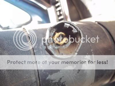

Heres what I am dealing with as far as the column and where the ignition cylinder is "Supposed" to go.
Based on what can be seen...is this saveable by putting in a new lock cylinder or should I opt to go for wiring in a switch and starter button?
AZ_BRONCO is offline

You have several choices......
1) replace the column
2) replace just the collar that's destroyed (and any internal parts)
3) other.
Funny, when you suggest calling a locksmith, most people don't want to spend the money. So, this is what you end up with .....a f' up column.

Go to the JY or Broncograveyard and find another column collar, you'll have to tear down the steering column a bit and remove some parts inside the collar but NBD.... what's the most it can cost, cheaper then replacing the entire column no?
Here now. :/
You have no idea what really happened there.
The damage might have started with a thief.
Might have been a-problem-over-looked because of the lack of money/job.
And/or might have been away from any sort of help when it finally failed.
Hard to image that last one for people in the rust-belt where it's crowded? ;)
All I know is this is what I started with (sissyassedbrokentiltcrap!;)...
Got the column from the manual truck ('90 F250) and it had that stinkin'
button you gotta push to take the key out! :(
Who comes up with this stuff? LOL :)
I can kill my old pickup (and my Bronco too now) and come rolling to
a stop where "border guards" and/or other fellow citizens are standing
around. I come rolling up nice and quiet for 'em. YMMV on that desire?
"did it die? :)" -Border Pee-Troll guy asks that sometimes
AZ, you can remove that "key cylinder hood/boss/bump" thing with a
hoof rasp, it's just sorry old cast zinc (the blue color in both our pics
is a dead-give-away for zinc)...

So today I went to a pick a part yard and pulled the collar off a floor shifted, manual tranny 82 F-150, non tilt column. The steering wheel was already off. Had to work a bit to get the snap ring holding it to the shaft off. Then I had to lower the column to get the rod out of the electrical portion of the switch. At least I know somewhat how this comes apart now.
Now the million dollar question...did I get the right one? Even if I didn't...it only set me back $7.50
Heres some pics...

Well today I dug in to replace the collar.Looked WAY WAY more complicated than it really is. Was a total cinch. I'd be willing to open a business replacing these collars if I could...that's really odd for me to say as I HATE working on other peoples stuff. I have full confidence doing these, however...tilt column or automatic...well I can't say I'd be comfortable doing those as I've never done one. I'd do the one like mine all day long...its easy, just don't over think things.
