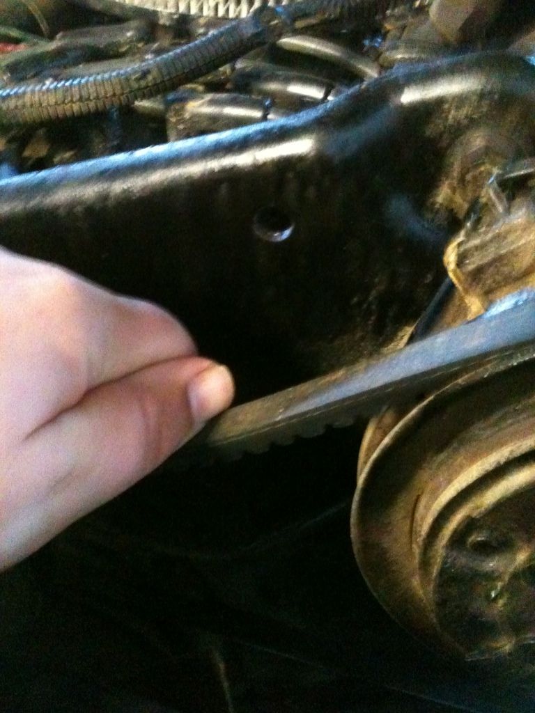

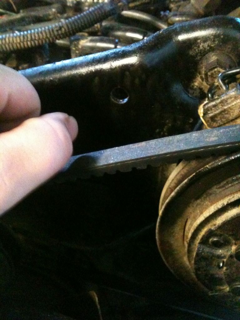

my thumb rule (dirty thumb) is that if you can twist the belt past seeing the ribs on the underside, then its too lose/old.

Mickaila's idea sounds like a really good one, I'm gonna go out and test
it and get back with my take/value on it...
My opinion is the same as Mic's. I feel as tho my power steering belt is a
little on the loose side and (with a certain amount of effort) I can turn the
belt upside-down on the longer stretch.
The "deflection" method always seemed kinda crummy to me, I like Mic's
way better. :)
IME, the A/C belt needs to be friggin tight! I can turn it almost sideways.
{it's a bigger belt and has shorter open-stretches + tighter too}
The alternator belt feels about right and I can turn it almost upside down.
Butthead in AZ
