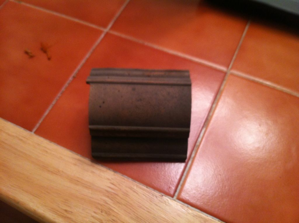

Tested the battery out, both my Sierra and Bronco both read at 12.54 Volts.
I crawled underneath the Bronco, in my slick, snow-covered driveway, and take another look at the stater. Lo and behold:
Looks to be the top half of the starter shield, no? I assume the lower half broke off and is gonezo on me. I don't have any buddies, and the wife just left me, so I have no way to see if full voltage is making it to the starter when I turn the key.
Lord only knows how long that shield has been missing, you figure that all the road crud and crap, road de-icer and salt has corroded and broken the starter over time?
