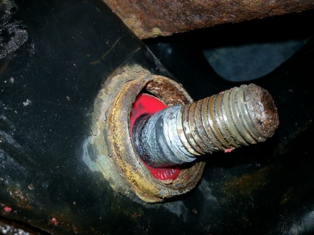

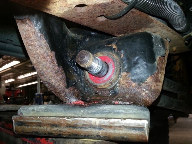

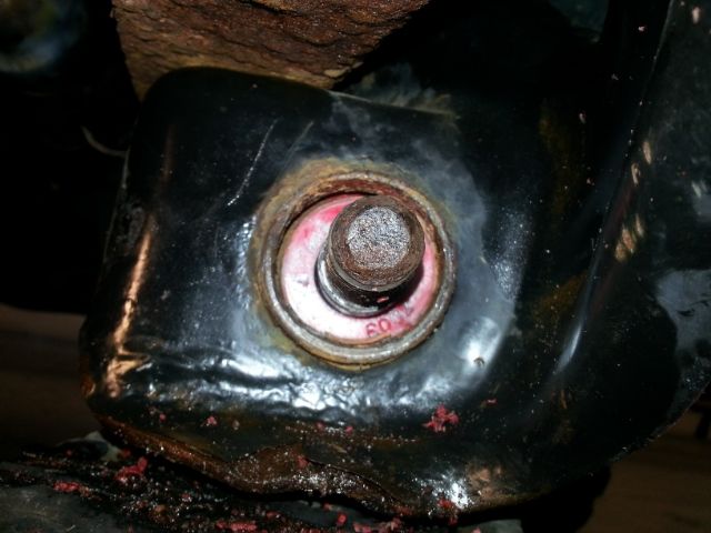

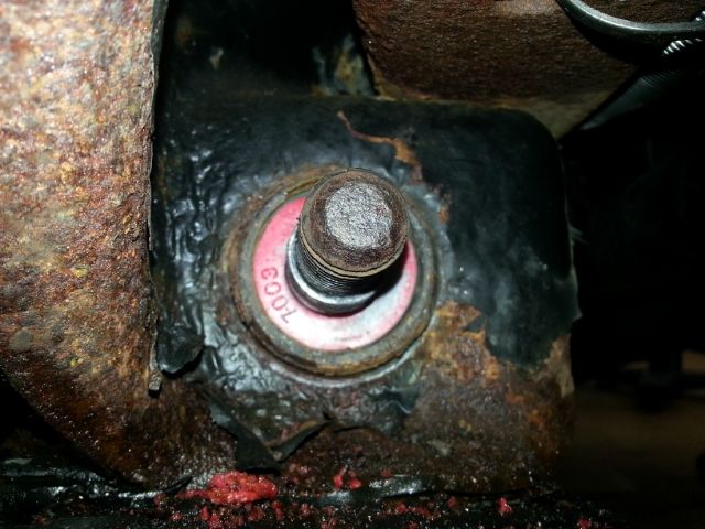

I had some time after working on the exhaust last weekend and spent some time on the radius arm bushings. I was surprised to find that the inside of the bushings looked pretty good. (the outsides were crumbling) I'm thinking that the brackets look ok, I just need to clean them up and POR-15 them.
Here's some pics:
Pass side 1
Pass side 2
Driver side 1
Driver side 2
I did go ahead and replace the rear half of the bushing since it was taken apart anyway. I'll get the front half when I have time to remove the bracket.

whats welded to the bottom? i wish i still had the brackets form my friends lift kit. they were in great condition and i woulda gave them to ya free.

That's the side post lift I was using. The truck is about 5ft off the ground in these pics. I HATE lifting it by the brackets, but with the way these particular lift arms were designed and the extended radius arms in the way, it was my only option.

I HATE lifting it by the brackets, but with the way these particular lift arms were designed and the extended radius arms in the way...
There's nothing wrong with lifting by the RA brackets, and the stock RAs are the alternate lift points. IDK if those aftermarket ones can handle it, though...
