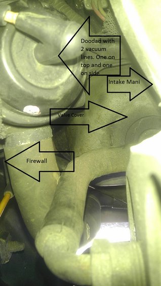

The EGR has a tube that connects to the back of the heads. That is most likely where your problem is. Also the IAC should be completely replaced. Ive tried cleaning it but it only makes a small improvement. Replace it completely and it will considerably help your problem. Go to the junk yard and look at another rig. Take pictures of the harnesses and vac lines, then double check yours. The unit that you fixed the leaking vac lines on the firewall was the MAP sensor. I believe there is a wire harness that plugs into that aswell. Take some pictures of the back of the motor area and post them. It will help with diagnosis.

Here Are pictures I have taken of some questions I have. If anyone could help that'd be great!
Can anyone tell me where that goes? I think I just broke it today
I've replaced this so many times :( any thoughts to why?
What does this go to?
same as above
Doodad I was referring to in earlier post
Location Of said Doodad
Another Angle of said doodad

What FSB member mettler might be referring to is a Thermactor Exhaust Air Injection Cross Over tube bolted to the back of the cylinder heads, has a check valve threaded in on top of the tube and over time due to mositure they rust/burn thru and cause an exhaust leak affecting over all performance, code : 44.
The check valve only costs $20.00 at most auto stores and if you have this set up you'll have to remove the "tube" in order to replace the check valve which has tappered "pipe style" threads so a vice grip would be handy you know....FYI: no tube gaskets are required for install but rather use bearing grease which will shallak into a nice seal....FSB member Steve83's tech tip.
Do a visual inspection of all your emissions sytem vaccum lines for potential leaks...
