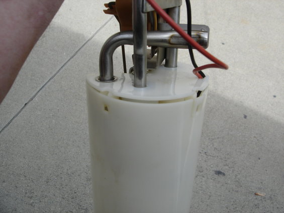

on my '94, I had a fuel pump that exhibited some of the same symptoms you are experiencing. After trying to find the cause of a hard or no start when warm, and throwing a ton of parts at it including IAC, FPR, Fuel Filter, etc. I went and checked the fuel pressure. The pressure was just a little low, but what I noticed most was the pressure release line (the line attached to the pressure gauge with the little hose attached that relieves the pressure when you push the button) was full of bubbles! Eventually, I cut the floor and put in a new fuel pump assembly, when I pulled the old pump out, I found that the top of the pump had partially separated from the bottom.
(If SuperMotors was working, I have a picture, and maybe if SuperMotors ever comes back up, I'll post it.)
I think the because the pump top was partially separated from the lower housing, the pump may have been sucking in air in addition to the fuel, causing a cavitation in the pump, and mixing the air with the fuel, and that was the reason for the "bubbles". I have two Broncos and when I checked the fuel pressure on the '96, the pressure relief line DID NOT have the bubbles in the fuel.

You could just replace the pump. When mine went bad, I cut the access hole and replaced just the pump. The fuel level sender unbolts from the pump assembly. JBG has just the pump for considerably less.
1990-1996 Ford Bronco In Tank Fuel Pump KIt Aftermarket-Broncograveyard.com
1990-1997 Ford Bronco and F-Series Truck In Tank Fuel Pump KIt-Broncograveyard.com
Get a new sealing ring and gasket too.
The instructions for the access hole are at:
1983 Ford Bronco Bronco Fuel Pump Access Hole pictures, videos, and sounds | SuperMotors.net
This is what mine looked like when I pulled it, I don't know how the top separated from the bottom of the assembly, but it was what was causing the cavitation and air being mixed with the fuel.
