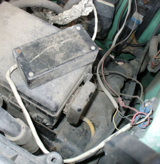

I've got this mystery box in the engine bay, tucked in behind the air box; set on top for the photos. There's no markings on it. The white cat5 cable runs from one end into the cab (via the junction block on the driver's fender), and from the other end down under the truck in a very sloppy aluminum foil wrap. I haven't yet tried following where either end goes, but I did see the foil wrapped end goes back somewhere when I was under the truck replacing the starter this weekend.
The mystery box's junction block has a red wire connecting to the starter solenoid on the passenger fender.
Any guesses what it is? I've got the 7-pin trailer package and just now figured out that the heavily faded box dangling by a bungee under the dash is a Tekonsha Voyager trailer brake controller, so it's possible it's an add-on for that.

Definitely not cat5. And the box looks like a project box you could have picked up at radio shack years ago. Could be a million things. Let us know where those wires terminate :)

The flat wire coiled up on the firewall looks like POTS or standard telephone wire. Very strange. I see a distribution point mounted to the driver fender. And the wire to your starter solenoid is obviously a power feed for whatever is in the box.
With that being said.... what's in the box??? Is it Jimmy Hoffa??

Cat3? Cat4? I went with the "generic" Cat5 because I figured "cat" would be confusing in car speak. But you may be right that it's not cat cable at all.
My first thought when looking at it, actually, was an alarm system. I've seen no other indication of one, however. That junction block on the fender definitely isn't stock, right?
Admittedly, it was a long shot, but I was hoping it is some common mod that would be familiar to people with more experience than myself. I have a habit of ripping unnecessary stuff out, while cleaning up PO's messes, before ensuring that it truly is unnecessary...
I guess I can start by opening the box and seeing if it contains any hints. There shouldn't be any power to it with key off, but I can double check that or just remove the lead to the starter relay. It's been raining buckets while I've been trying to work on this stuff, making for less than ideal conditions for all but inside work. I'll see if I can follow the big bundle under the dash tomorrow.

CAT 3,4,5 generally has 24 gauge twisted pairs inside. Looks more like security wire as it's a larger gauge.

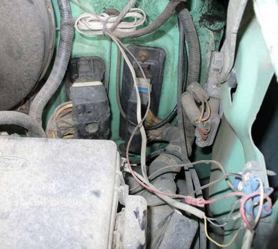

Here's another thought: If you couldn't guess by the engine bay, it was originally a forest service vehicle. I think they mounted an antenna in place of the tailgate lock, judging from the big circular mark around what would have been the keyhole.
I bet if I follow the aluminum clad white wire bundle, it would head back that direction. However, I haven't yet devised a theory as to why an antenna would be hooked up to the starter relay, or why they wired it under the truck.
Maybe it's just something stupid like a bypass of a faulty fuel pump relay.

An aftermarket radio harness I had once had a box about like that, but it was shoved in behind the radio.
The antenna idea seems logical, other than the wires not being antenna wire.
Where do the other wires go that come off of that non-factory Junction block?

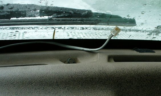

The mystery box goes to nothing! I was able to follow it up through the dash, which required dropping the steering column to pull the gauge cluster forward, before finally meeting back up with the cable by a velcro patch at the center of the windshield base.
Maybe it was a hardwired radar detector or something? Not much could have fit in that snug space, unless that was just an anchor because they couldn't get screws back there. There are holes drilled elsewhere in the area.

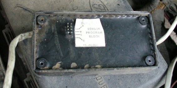

Here's what the box looks like opened up; doesn't really shed light on its purpose:

My radar detector uses the exact same rj-45 style connector. That would be a good call. looks like it my have piggy-backed into the ignition system so that it only turned on with key-on.
edit*
You said it was a former forestry vehicle? could it possibly have been an early auto GPS setup?
I've got the Escort SmartCord system in my other cars, which is why I thought of that. However, while pulling the cord through the firewall and disconnecting the wire to the starter relay, I couldn't help but think back to it having something to do with the trailer setup. I'm wondering if my 7-pin hookup isn't stock, and this somehow filled in the extra wires for trailer braking.
That doesn't entirely make sense either, though, as it doesn't hook up to anything braking related in the engine bay or cabin. Plus, I've got the Tekonsha Voyager trailer brake controller hooked up. It could be the mystery box was the original trailer braking system, and a subsequent owner replaced it with the Tekonsha, leaving the junk in the engine bay.
Tomorrow is supposed to bring a brief break in the rain, so I'll get under the truck and see if I can follow where that wire bundle goes.
edit*
Could be. That would fit with the apparent antenna mount on the tailgate. I imagine GPS receivers had to be pretty big 25 years ago, especially for remote locations out in the woods.

Mine has receptacles for that style cable. Judging by the microphone clipped to the visor, it appeared to be an early mobile phone setup.
That would be along the same lines as the early GPS guess, and would also explain a big antenna in back. If that was the case on mine, they probably mounted it to the dash instead of the visor.

That makes a lot of sense. The 90's were full of bag phones and hardwired car phones. Used one to call my uncle when i was 8, when our 93 f150 flipped over as he was closer than any emergency responders in the area would have been.

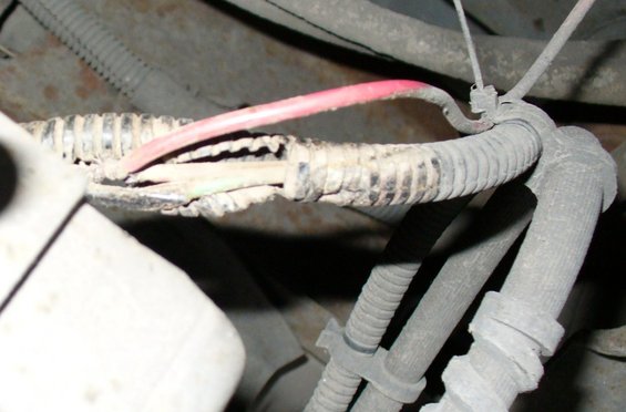

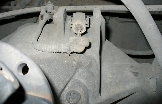

Well, we were all way off with our guesses! The rain kinda sorta let up, just enough to get some cardboard under there before it turned to complete mush. I followed the white wire bundle back until it became just one red wire. That in turn follows the frame rail further back and, to my surprise, splices into the rear diff! Speed sensor? Gearing control?
It's a 2-wire loom to the drive shaft, with white and green wires. The mystery box's red wire is spliced to the white wire. It looks like the green wire was also tapped into at some point and taped back up.
Here's where the wire loom connects up to the rear diff:
Also note that the plug seems like it has too much wire pulled through to clip over the metal lip without bending the wires badly.
Here's the routing of the mystery red wire before it splices in, along with a vacant hose (ABS?) up high:

The "vacant hose" is the vent for the differential housing

Good to know, thanks. I couldn't make my way over to the other side to see if it had the same thing, and it looked to be attaching right near the brake line on the side pictured.
I'm new to 4x4's and didn't even know diff housings have vent hoses. :)
