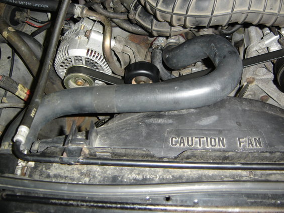

Is there any recommended "Adjustment" to get the upper radiator hose a bit higher- I loosened the upper hose slightly and rotated it so the hose is floating about 1/2" above the fan. I'm considering hooking up a cable tie and having that hold the hose about 2" above that fan. I've caught myself a few times leaning over it and hearing the hose 'tap' into the fan while it was running. No damage thankfully.

We had it resting on the shroud. Where the hose 'turns' around and angles down to the thermostat housing- It was almost contacting the belt, and was just about on top of the rotating fan.
I'll see if I can get some photos done. It's the correct hose (made by "Gates") It might need a tweak here and there to clear all the rotational stuff....
Photos should relay things a bit better.

"Twist the hose where it connects to the engine. It will make the hose "stand up instead of sagging down in between the radiators and engine." by Need4racin
Twisting the hose so it doesn't contact the fan shroud, belt, etc. is the way to fix the issue. Zip-ties, lacing cord, bailing wire, are NOT the way to route the hose. In the picture below, loosen the hose at the thermostat housing, and rotate it counterclockwise a little, and the hose will magically rise off the shroud, then tighten the hose clamp. If that's not enough, loosen the clamp at the radiator too.

We did move the hose as suggested. When the hose relaxed it was back on the shroud again, and 'motorboating' (only way to describe that sound)
It's been moved-twisted a lot more as of yesterday morning. We have a zip tie holding it up just in case. It already relaxed on the tie again(we had it resting just above the tie). We might need to do this a few times before it gets used to the new shape. My gut feeling is that this hose is slightly to short for the application.
