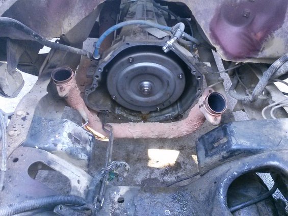

Here's a picture of the back of the engine, have you taken out all the bolts?
Mikey350 is offline

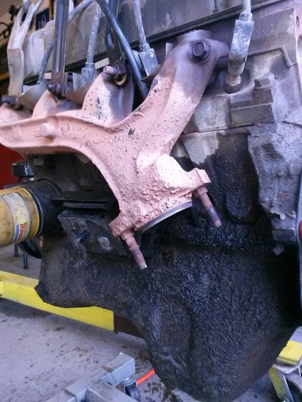

it only attaches to the exhaust, transmission and the frame. if you have those disconnected then you're good.
trans to engine bolts (6 bolts)
torque converter to flywheel (4 nuts)
exhaust manifold to the y-pipe (2 nuts per side)
engine mount (1 nut and 2 bolts per side) you can pull the engine with just the nut removed and the mounts still attached to the block.
this is the engine mount. the stud sticking up goes into the frame and is held on with a big nut. then the mounts bolt to the block with 2 bolts per mount.
