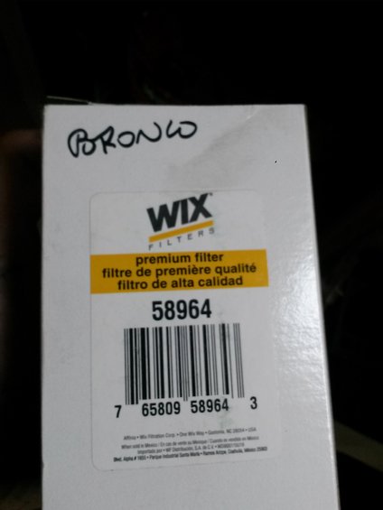

power steering fluid filter - wix 58964

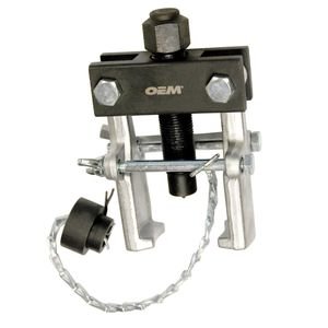

heavy duty pitman arm puller like this loaner tool from autozone:

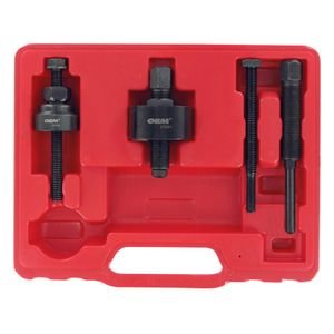

and a pulley puller / installer like this from oreilly, because i had to replace the pump.

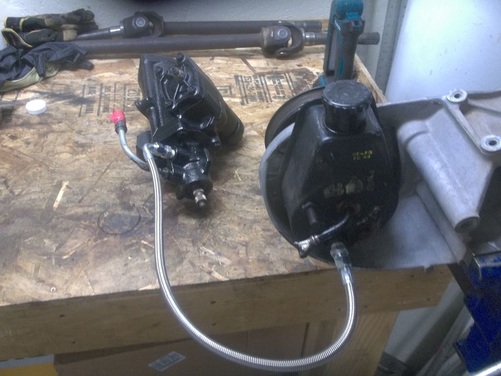

here are the parts from the JY

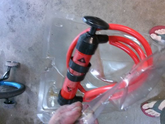

step 2 - use a transfer pump to empty out the PS pump

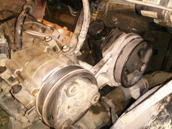

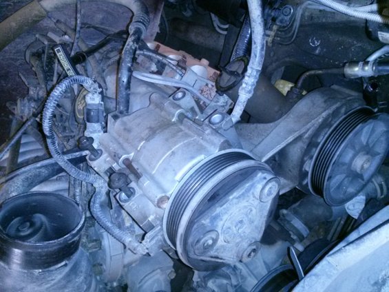

step 4 - disconnect the a/c compressor. i left 2 bolts in a few threads while i disconnected the bracket. in hind sight, i don't know if that was necessary.
step 5 - move the a/c compressor to the side and remove the pump and bracket

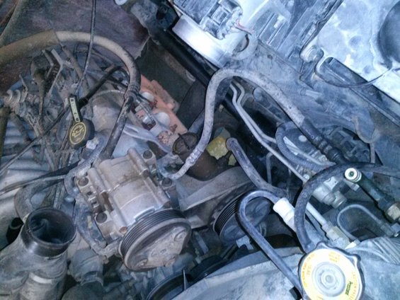

step 6 - remove the return hose
step 7 - install new pump and bracket. i removed the accessory stud off the back and replaced it with a standard bolt m10-1.5 x 20mm.
also, i'll add that i did not have to drill out the a/c compressor. the sag pump i got came with the small bolts. it may be because it was off a new van, although i didn't think to see what year it actually was.

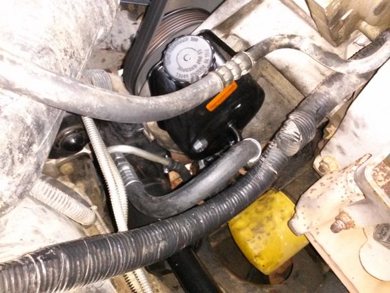

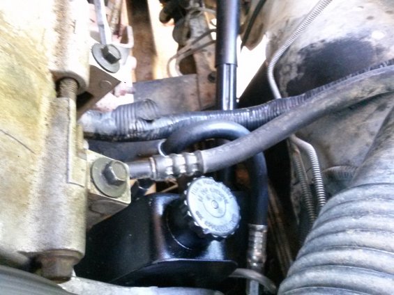

here is the first pressure hose
also, the 1st pressure hose is already installed. i didn't like the routing towards the fan and under the pump. it was trying to get too close to the fan blades for my liking.
here you can see it routing under the pump. and it's pretty crowded under there with the return hose, the filter, and the pressure hose.
from underneath

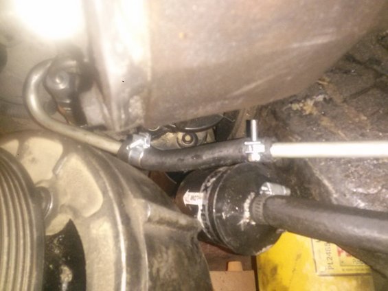

and this is the filter

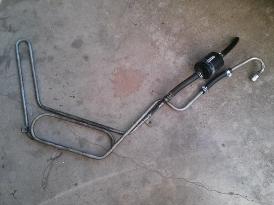

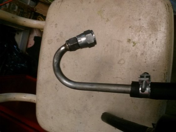

**note** this is the junkyard pump and modified hose. at this point, i installed the return hose w/o modification just to see how it all sounded. it sounded god awful. the pump was bad. i bought a reman from oreilly with a lifetime warranty, price matched to autozone. installed it, and back in business.
also at this point, i decided to have a completely custom hose made. and since i was going back to the hose shop, i had them modify my return hose in hopes that i could avoid cutting it. well, i kept bending and bending but get fed up with it, so i cut it anyway.
this is the final version of the return hose
you can see they welded on a new end to go to the AN fitting.
this went into the steering gear

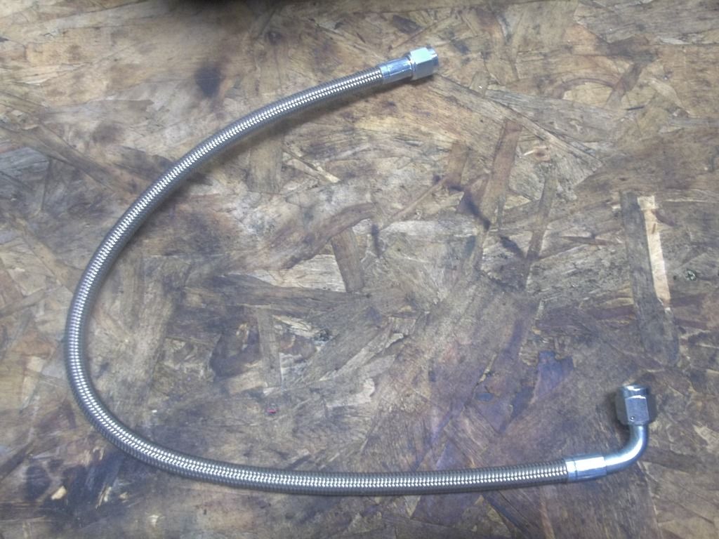

If its all good with Dash_Cam I would like to share how I am doing the high pressure side for my 4 bolt box and sag pump setup. I dont have it installed yet but have some pics of it setup on the bench.
High pressure hose, -6an x 24" w/ 90 & straight, Fragola part# FRAHSE3090-06-ST-24
High pressure fitting to steering box, 1/2"-20 o-ring to -6an, Russel part# 648010
Sag pump high pressure fitting, M16x1.5 oring to -6an, Russell part# 648060

looks good, but will you double check your p/n for the hose? i can't find that number anywhere, including the fragola catalog.
I came up with 372024 on page 48 of their catalog.
Is -6 big enough?
Hillbilly Heaven is offline
and what do you have going on for the return hose
Heres the Amazon link Amazon.com: Fragola -6 AN Straight x 90 Degree PTFE Hose Assembly, Steel Nut, 24" Long: Automotive
For the return hose I am just using the factory 4 bolt steering box fitting and 90, cutting it right at the tubing flare transition to rubber and sliding new hose over it with a clamp. I am also using the same Wix filter and a new cooler mounted in front of the radiator. It will be all regular rubber hose for the return side.

Originally Posted by Hillbilly Heaven View Post
Is -6 big enough?
I was concerned about that as well. The inside diameter looks to be very close to the factory tubing and is larger than the passageway of the steering box port. So I went with it.
The next size up -8, I think is like .5" inside diameter and seems to big with the factory line at around 3/8" like -6, although I don't know the exact inside diameter of the factory line at the moment.
dash_cam likes this.
1995 Bronco, 351w, Hill Killer E4OD, 4.10's, 2" lift and 33's
SAS coming one of these days...
Alwaysdirty is offline
post #10 of 20 (permalink) Old 05-19-2016, 06:04 AM
Hillbilly Heaven's Avatar
Join Date: Jun 2005
Location: Cheraw, SC
Posts: 947
Bronco Info: 1979 Bronco
Ahh ok that explains the discrepancy in the part numbers.
The number you referenced is an Item Number they used for Amazon. Even though it worked for you something is weird as they list the actual part number as 372024 further on down in the technical description of the part.
Yoy are correct about your AN sizes. A dash 6 is 3/8" Tube size whbich is also the same as the hose I.D,
A dash 8 is 1/2" Tube size and hose I.D.
Remember hard tube is measured by the O.D. and hose is measured by the I.D.

My custom hose is 3/8" hose, so you should be good

stock Pressure Hose (has -8 AN male fitting at steering gear end)
-ICT Billet #AN894-08-06B (-8 AN female to -6 AN male reducer)
-Russell #640040 (-6 AN female to -6 AN female 45deg coupler)
-Russell #648010 (-6 AN male to X 20 O-ring male)
4 Bolt steering gear (has X 20 O-ring port)
stock Return Hose (has -10 AN male fitting at steering gear end)
-Maxon F45001 (-10 AN female to -6 AN male reducer)
-Russell #640040 (-6 AN female to -6 AN female 45deg coupler, ^ same as pressure side)
-Russell #648030 (-6 AN male to 5/8 X 18 O-ring male)
4 Bolt steering gear (has 5/8 X 18 O-ring)
The steering gear I ordered is Cardone #27-7623
^ I HAVE FOUND ISSUE WITH THIS SET UP, PLEASE SEE NEW SET UP BELOW

this is what i said in the other threads about this. what i would do is reuse the saginaw hose. cut the middle of the metal line on the gearbox side of it. buy a Superduty hose, and do the same. buy a couple of inverted flare nuts and inverted flare coupling of correct size. flare the ends of each metal tube and coupling them together. no need to adapt to AN fittings or run a custom hose. all you have to do is cut and flare the new and old hose jsut like if it were a big brake line or a tranny cooler line. any auto parts store should have those fittings and coupling for use for tranny cooler tubes. easy as pie

Definetely more than one way to skin a cat on this. I would like to add that the setup I posted earlier in this thread and has about 500 miles on it in my truck now and has been working great. Didn't cost much and was super easy to install.

Saginaw. However, I have decided against using a bunch of adapters because I realized that the stock hoses have a flared end, which will probably leak when mated to a AN female fitting.
Instead I am replacing both the pressure hose AND installing an aftermarket cooler using this set up:
Steering Gear, Cardone #27-7623
Saginaw pump pressure fitting, Russell #648060
Pressure Hose, Fragola #372024
Steering Cooler, Hayden Automotive #1010 (comes with rubber hose + hose clamps)
Steering Gear pressure fitting, Russell #648030
Steering Gear return fitting, Russell #648010
Steering Gear return fitting adapter, Earl's #700167 (-6AN to 3/8 barb, adapts return fitting ^ to rubber hose)
