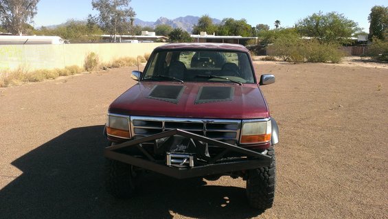

I was asked to put a simple thread together on the installation of my hood louvers. I live in the desert and I was wanting to make sure my under-hood temperatures stayed down to increase the life of everything that has to live under the hood. Hood louver installation is pretty simple and straightforward. I purchased my louvers from "RunCool Hood Louvers {http://hoodlouvers.com/}". RunCool Louvers are very nice looking and very rigid. They came with good instructions and the rivets for completing the installation. You need a rivet popper, hole saw, grinder and a rattle can of primer paint to complete the job.

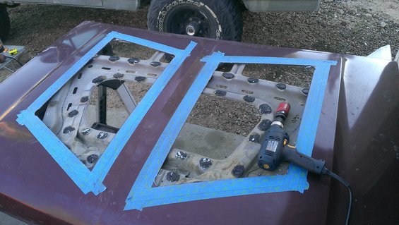

  2. Lay the louvers in the position where you want them and blue tape the hood around the outside of the louvers.
  3. Remove the louvers off the hood and then put second layer of tape with the inside edge about 5/8" to 3/4" inside the louver pattern already taped. This is to give enough louver to hood overlap to have a good solid surface area to rivet to.
  4. Using the hole saw cut 8 holes for the corners (this will keep from making a weak spot in the metal hood which will happen if you grind to a sharp pointy corner).
  5. After cutting the corners then use a grinder and cut the rest of the hood portions out following the tape line and taking care not to cut the reinforcement cross-braces. You still want a strong hood.

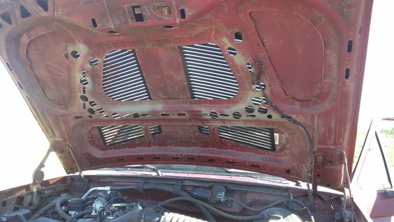

  6. Turn the hood over and put holes into the cross-braces to allow better air flow.
  7. Buff off all sharp edges of the freshly cut metal and primer the bare metal to keep from rusting.

By allowing the temps to escape from under the hood it will greatly reduce engine temperature and the damage done by temps that will reach over 200 degrees F when driving in Tucson, AZ during the summer when the outside temp is over 105 degrees F...
