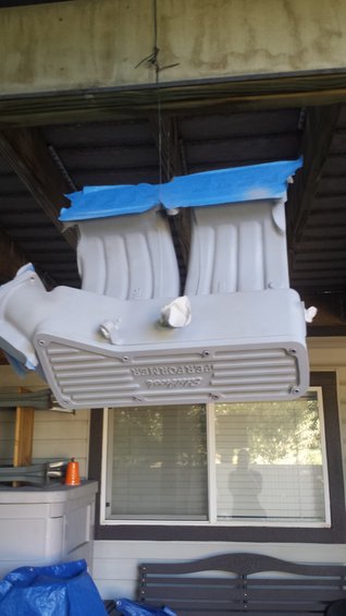

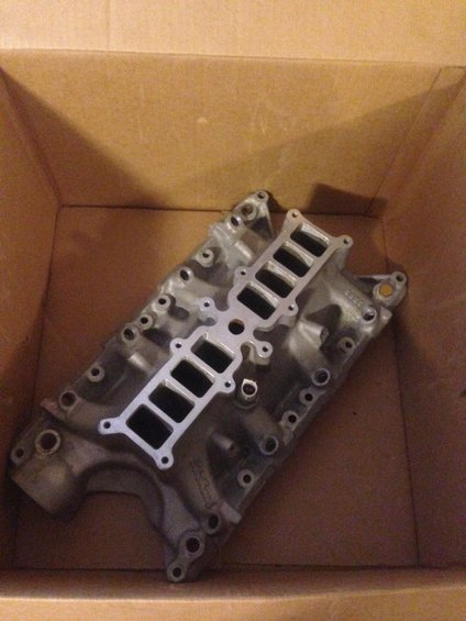

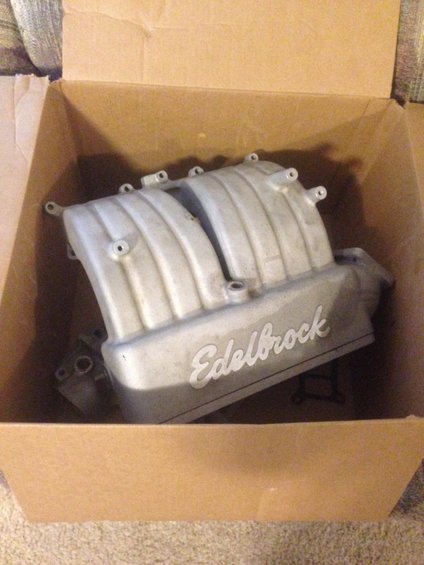

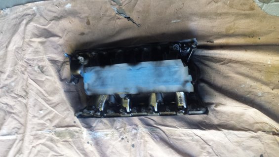

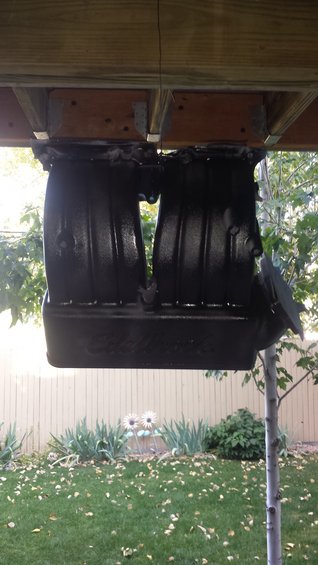

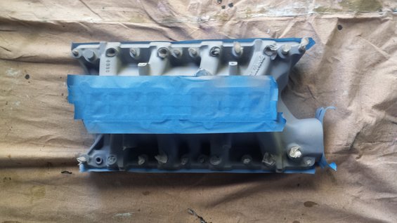

One of my favorite projects that I've worked on over the years is the engine.
The 300 is a strong, stout engine that makes a crazy amount of torque at low RPMs (about 260ft/lbs at 1400 RPMS) and is amazing on the trails with it's grunt and long (almost) 4" stroke. And it can get some pretty decent mpg. My record was 23.
However, at 112hp, it leaves a lot to be desired on the open road. I was constantly losing speed on any kind of grade.
So, one of my first upgrades to address this issue was to upgrade the exhaust. The stock exhaust was a skinny 6-to-1 manifold with a 1.75" exhaust pipe. Ford couldn't care less about good flow and simply tossed something on there that worked.
However, when they came out with the fuel injected 300, they opened it up a bit and gave it dual manifolds. These were a massive improvement over stock and helped the engine really breath. And the best part was, they were a direct fit.
I purchased an entire 2.5" exhaust from the engine back and assembled it in the driveway.
It also didn't help matters that there were chunks of the original cat lodged inside the muffler. So, not only did I improve the exhaust flow, but I remedied some serious issues this poor engine was suffering with.
Even though the projects were a few years apart, my next venture was increasing the horsepower. The stock carburetor was a single barrel carb that was very undersized for the engine at around 190cfm. I'd heard a decent two barrel was a good improvement, but I wanted to go all the way and went with with a four barrel.
Offenhauser makes a great intake for it.
Since the stock exhaust heat riser would now be missing, I found a heated spacer off of an old Ford Galaxy so that I could use coolant for warmth.
Pretty big size difference in the carburetor:
Time to strip off all the old stuff.
