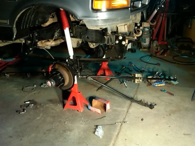

Also painted them with Chassis Saver. Sorta like POR-15. No pictures of that, just imagine them black.
Also cut the spacers off. What a PITA. Wound up grinding part of it off, and air hammering it out.
BigPetesBronco is offline
post #33 of 153 (permalink) Old 12-12-2012, 04:34 PM Thread Starter
Join Date: Nov 2010
Posts: 332

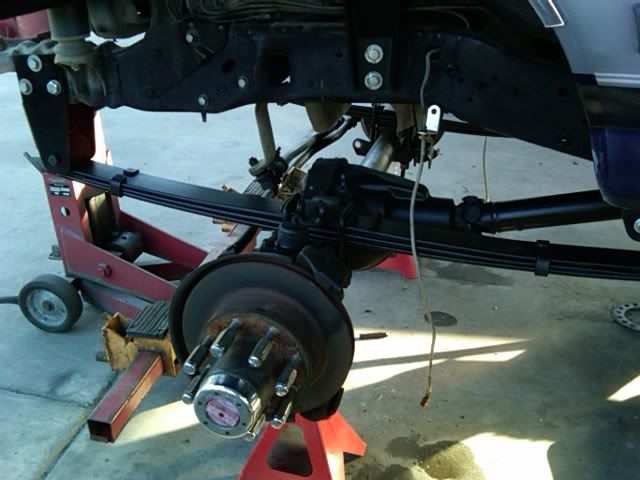

Originally Posted by Bronquistador View Post
Got my SRK.
so if you run this front mount and those other rear mounts wont the springs be angled / \ or is the front of the frame wider then that section you plan on mounting those rear brackets?
94 5.8/E4OD Edelbrock efi intake, jba headers, transgo shift kit. 6" PC stage II, 4.88 gears, front Aussie. Warn HS9500, custom bumper and sliders. RedHead steering and TieRod flip.
...wat.
Frames the same...

what i was refering to is the rear spring hangers are outboard of the frame correct. the front spring hangers are directly under the front of the frame so how can they be parallel? unless of course the frame is narrower where the rear spring hangers are bolted up compared to the front frame horns.

Originally Posted by BigBlue&Goldie View Post
What brackets are those?
Front hanger and shackles:
http://www.sky-manufacturing.com/new...uct.php?id=162
Rear hanger:
http://www.sky-manufacturing.com/new...uct.php?id=318
I could have spent hours cutting the ones off my F350 but honestly I love Sky's parts. The rear brackets are worth way more than they charge for them. Probably 40$ in hardware.
