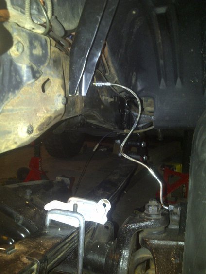

Brake line bracket before getting cleaned up
For anyone wondering, that doesn't work. Buy the F350 flex lines.
What went wrong here?
I bought the JBG braided stainless Bronco lines, ground off the "locating edges" and bent the hard part of the line a bit and it works like a charm
I also need to mount my lines on the bottom of the frame

Got my brake lines....
EDIT: I couldn't get a good seal around the caliper. I guess you got lucky, or the Ford gods just like watching me spend money

Is that ground breakline picture one you took or is it off my supermoto page Thats the way to do it everyone told me to get custom lines but I just ground the jbg ones too
