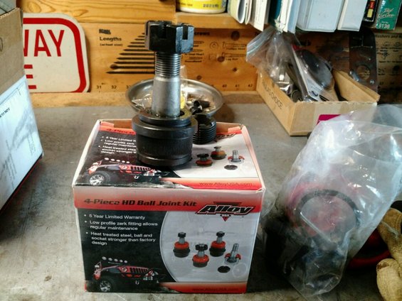

The guy I bought the axles from already changed the ball joint too. While I had the D44 diff apart for cleaning I put new seals in there too.
I feel pretty cool right now. I got comments from Jermil and Shadofax. I have read alot of comments on other post from you guys and really appreciate your input.
My issue is that I just lack the time these days to get out and look at posts. I've been more involved on the site recently since, matter of fact, Jeremy and I have been contacting each other on a part for his 1356 blues.
I'm also much less of a help these days as I still love driving my truck, but have not been involved in projects, not involved with detailed specs I used to love, many questions I choose not to participate in an answer since I can't remember some of these details around a specific question...figure better to let someone more in the know answer those.
This issue though, I do know you do not want those internal seals leaking right after installing under your truck, and even the best D44 BJ's only last so long once you get to 37's and are wheeling the truck.

You nailed it..I try to answer the things I'm semi-competent on and steer clear of those I'm not...sad part is I've probably forgotten more than I know at this point..good thing I have my supermotors as a reference..
If you ever have to do ball joints again I recommend these. USA Alloy brand, they are heavy duty, company lists them for jeeps but they work on the Dana44.
PN for the Bronc is 11802
keep the pics coming.
