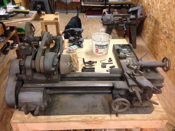

That old belt drive south bend is pretty cool. That is steam era stuff when jack shafts and a stationary engine ran whole factories.
I think this is just after that era; while still having technology from that era. If this were a free standing model, not bench top, you wouldn't see the belts as the motor would be below the headstock. That's how all of ours were in school. They were all 9" South bend lathes from the 50s.
We had a couple pictures from the old school when the lathes were all run by belts, jackshafts, and steam; the machines had spoked flywheels, and looked quite a bit different. Very cool to look at in depth and see how they accomplished power transfer in those days. Very humbling

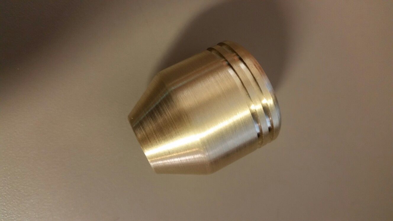

I knocked out my first of three shift knobs on the lathe at work today. Just a little project messing around. These will be going on my doubler. Made of brass.

That's pretty neat. Taiwan makes a decent machine, and that one looks pretty sturdy. We had a couple gear head lathes that had that same shape to it, but I can't recall what they were. The gear head I used was a 15" clausing. I loved it.

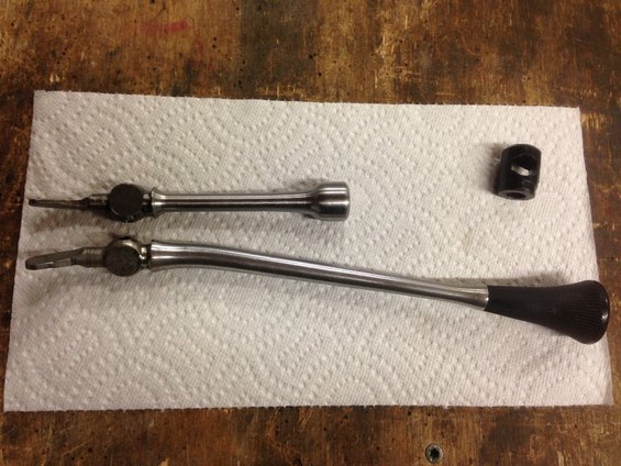

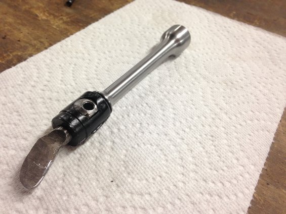

Originally Posted by vrewald View Post

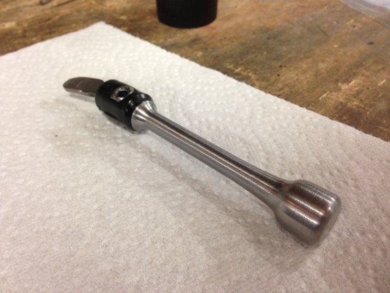

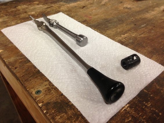

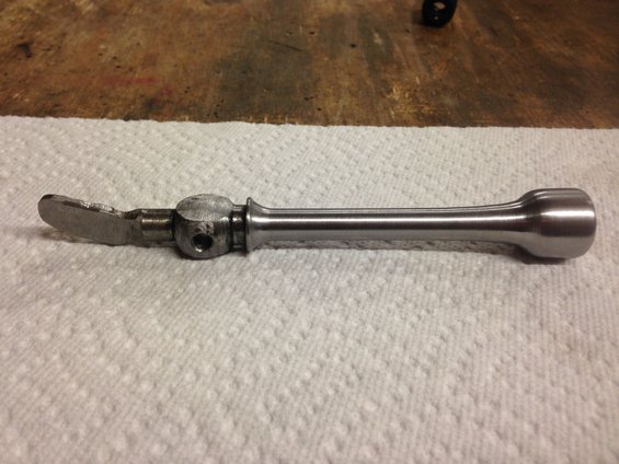

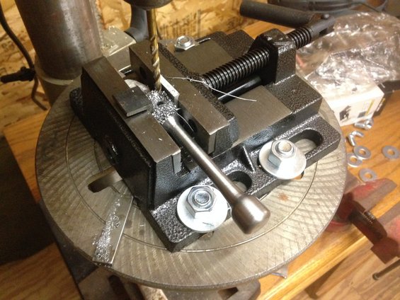

I recently inherited an old South Bend 9" metal lathe. I have long been wanting to buy a spare automatic steering column shifting lever to cut down several inches, because when I'm off road and down in 1st gear, the thing is right in the way of my knee!
Since finding those levers without buying a column is nearly impossible or ridiculously expensive, I figured this was the perfect opportunity to make my own!
Enjoy :)
South Bend 9" metal lathe (~1945?)
Started with 1" barstock
Cross drilling roll-pin hole
Finished product!
No more bruised knees!
One thing I would've done differently-I might have made it out of stainless. We'll see how quickly this one tarnishes and maybe I'll make another one.
These will be good for a np205 twinstick
