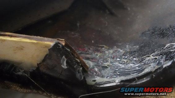

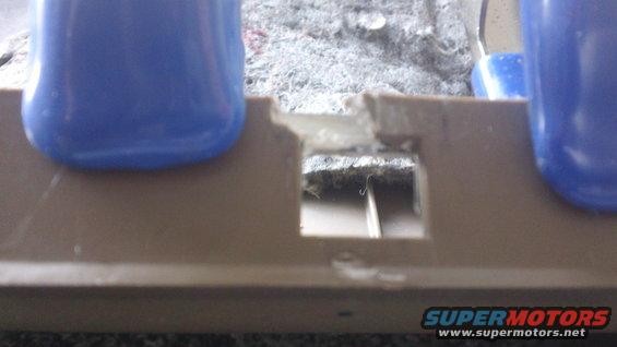

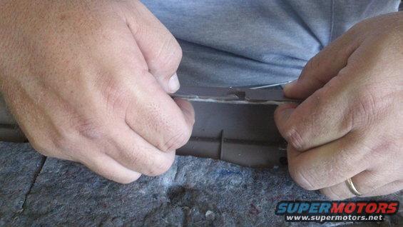

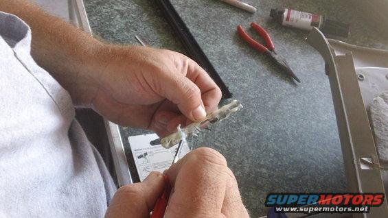

Ok! I did some door repair today. It was very easy and worked very well too.
First I was having trouble with the door molding holding on to the door panel because all the tabs were broken off on the door. So I came up with an idea to use a Hack saw blade to repair the broken tabs.
[IMG][/IMG]
So I outlined the cut out onto the hack saw blade, then cut it out with the dremel tool.
[IMG][/IMG]
Then using 5 minute epoxy, I glued the blade piece to the inside lip of the door panel and clamped it in place.
[IMG][/IMG]

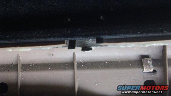

Then I installed the window molding, and bent the center clip around the piece of hacksaw blade so that it would not lift off of it when the window goes up.
[IMG][/IMG]
Worked great!

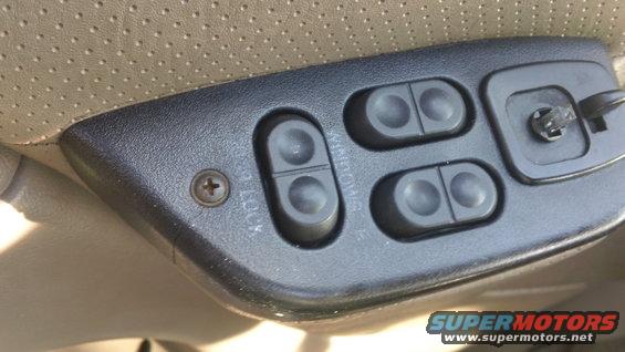

Second problem. Since the first time I took the door panel off I noticed the Control Pod Cover was not being held in place. The plastic that holds the clip in place had broken and there was nothing left for the clip to hold on to.
So I got an idea from my old days building radio control airplanes. I found a Piece of Light Plywood and cut it to fit, then epoxied it in place. Then I put the cover back in place and drilled a hole thru the mounting screw hole into the light ply. Now it has something to hold on to.
