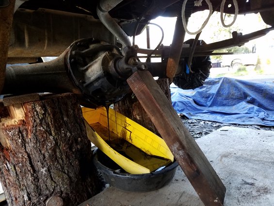

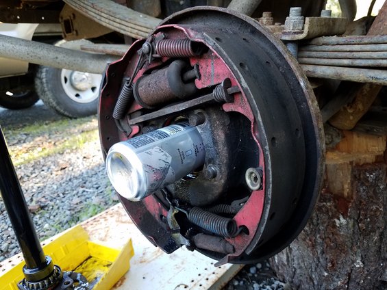

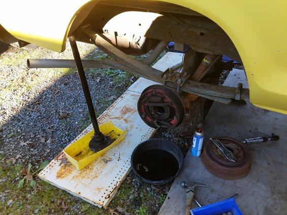

You will not belive me, but I worked on my Bronco...
YANKED THE AXLES
DRINK BEER AND PLUG THE HOLE SO IT DOESN'T LEAK. (THATS WHAT SHE SAID )
CRACK THE SEAL
YANK THE THIRD MEMBER , AND THEN REMOVE THE PUMPKIN.

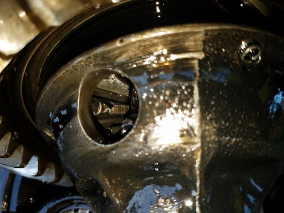

LOOK AT THOSE HERTZIAN FATIGUE PITS (SORRY, GETTING ALL ENGINEERY AGAIN). THAT IS PROBABLY THE CHUNKY SOUND I WAS HEARING.
Next move is to find a new third member, and reverse the above process with new seals and bearings, maybe disk brakes and more beer ...I have a slab to work on now, so I am running out of excuses for why it is still sitting there.
