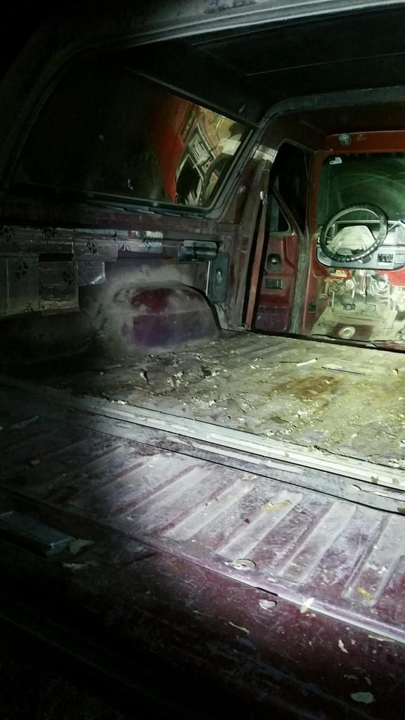

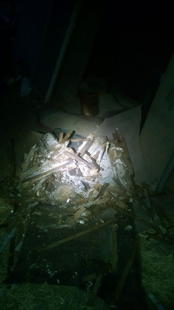

Well, got a little done on it. Got sick before starting the body removal, but I did get the interior pretty stripped out.
Shelby started messing with editing on pictures she took and she took/edited this pic. I like it cuz it pretty much shows the start of the destruction

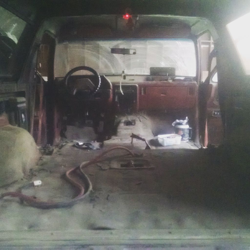

The interior without the sub boxes, amps, battery, seats, etc

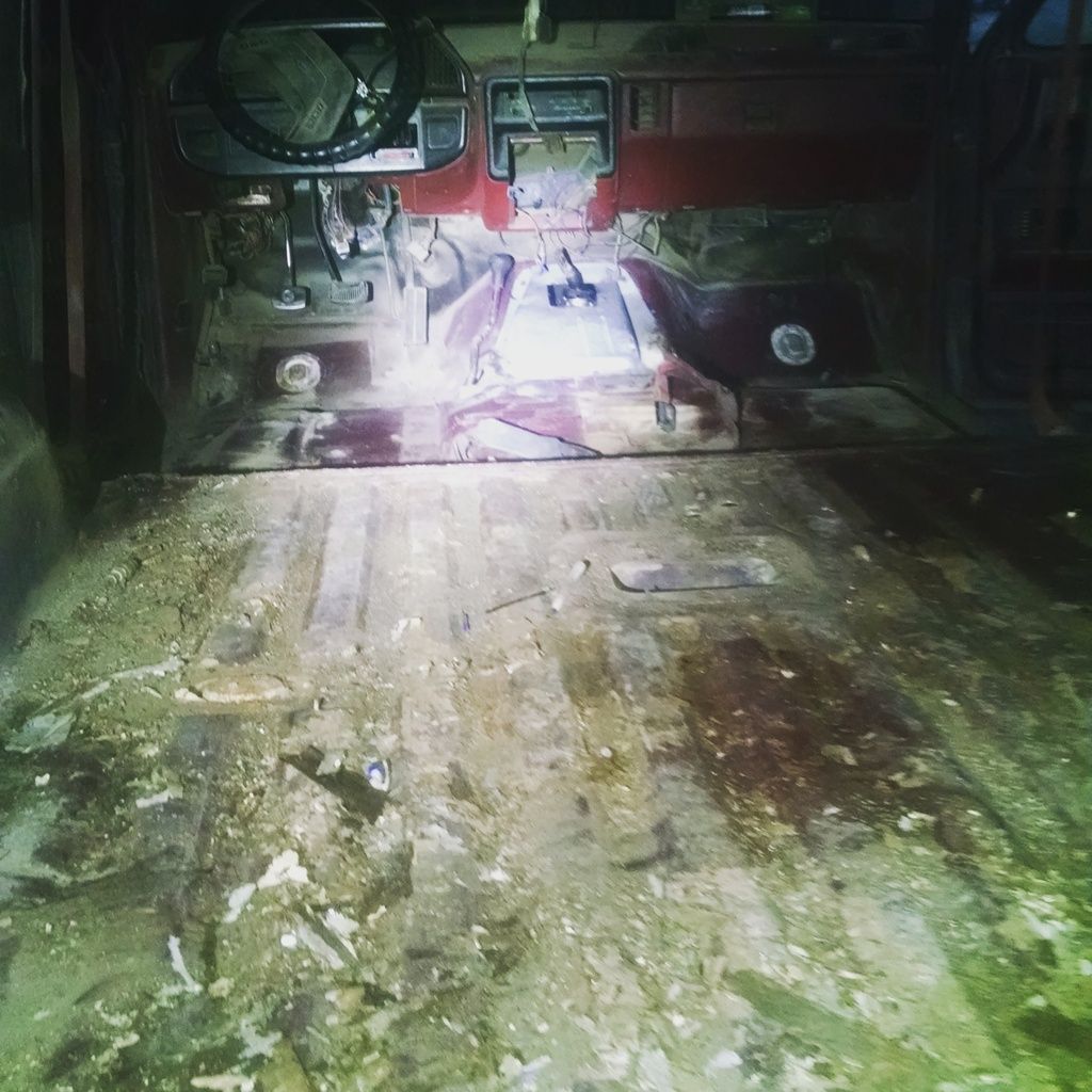

Then the pics after removing the carpeting and everything else
And the crap that came out
I'll get the body ready to come off this weekend and post when its taken care of

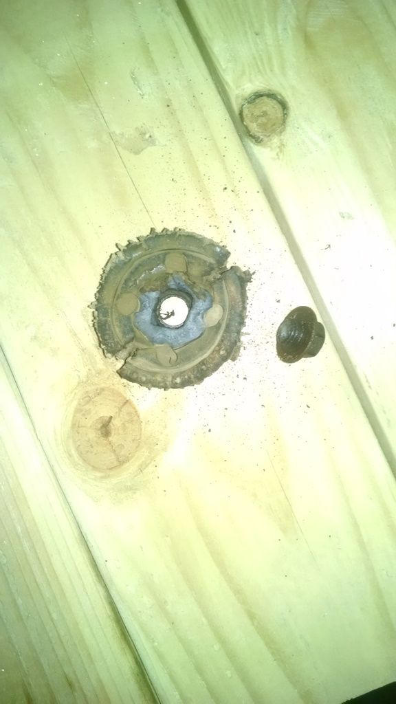

Well I got most of the connections between the body and the frame disconnected, but the only thing slowing me down is that the body mount bolts are spot welded to the nuts... Apparently, the bushings have never been replaced and it shows on the one that I was able to remove. BTW, broke one of the bolts
Now it's time to bring out a grinder or a hacksaw and try to get it removed.

As far as the body mount bushings, they all pretty much look like this...
This is the one that broke the head off the bolt.
I do believe these are from the factory in 1988 and just replacing these SHOULD get rid of a lot of creaks and groans while wheeling.
