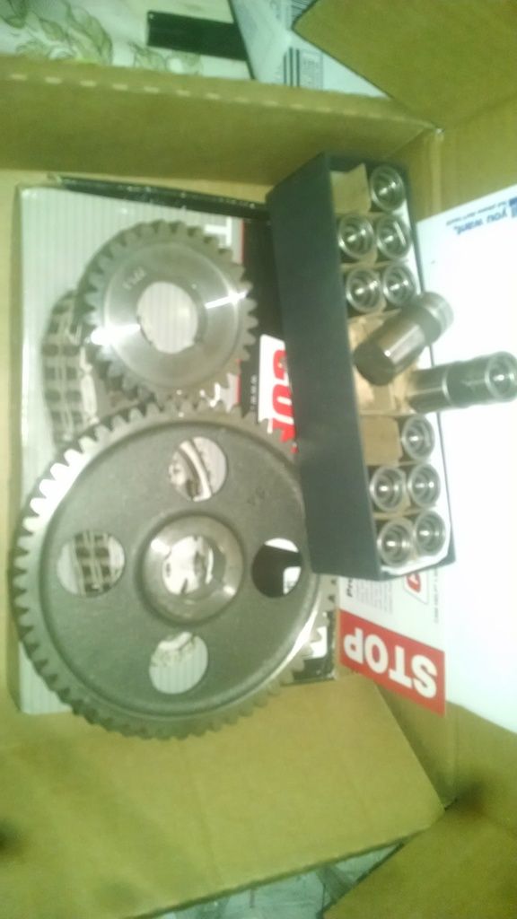

Well, I got these today!

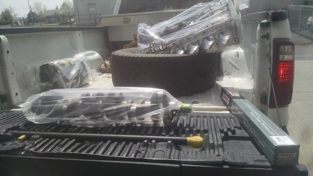

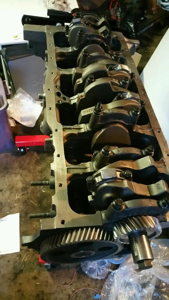

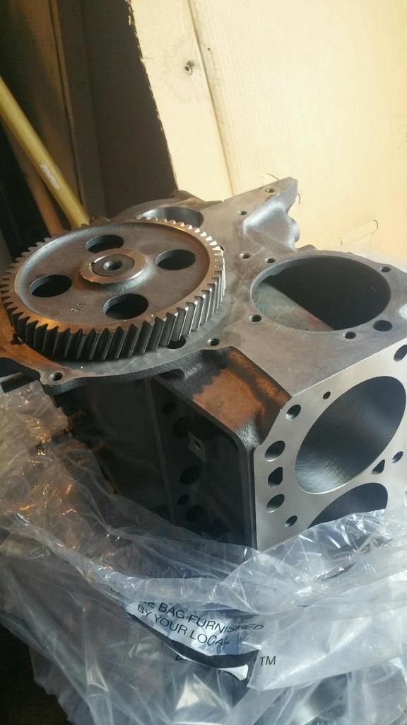

Been about a month since I've updated this. Been too cold out and dark too early to be able to actually get any work done.

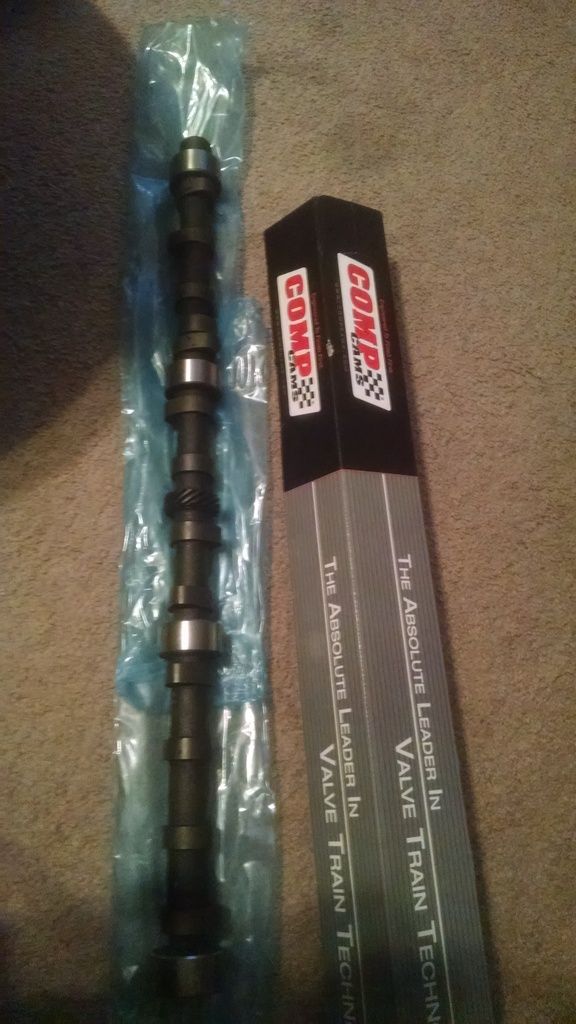

However, I did get my cam in, found out Friday that the block FINALLY got it's bore, cam bearings, and hone done, got the t-case torn apart and found out why it wasn't shifting/locking the front end in, and more.
To start with, the new cam...

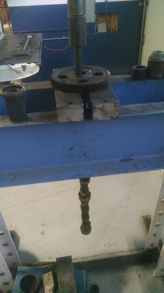

Pressing the old cam out to get the plate..

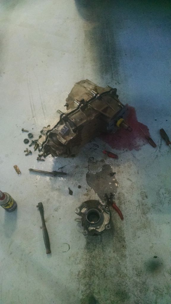

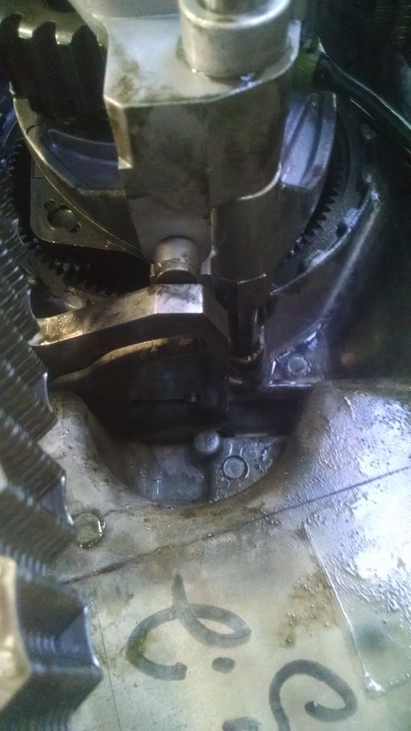

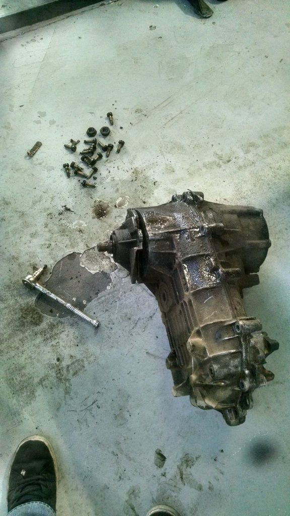

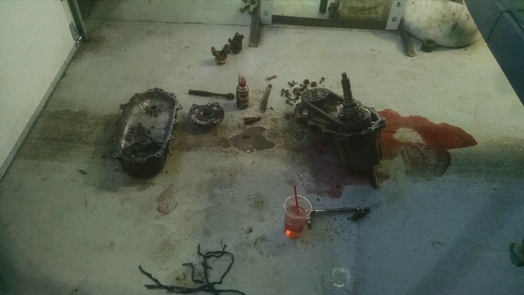

Then started teardown of the t-case...
Can anyone see the problem in this pic?

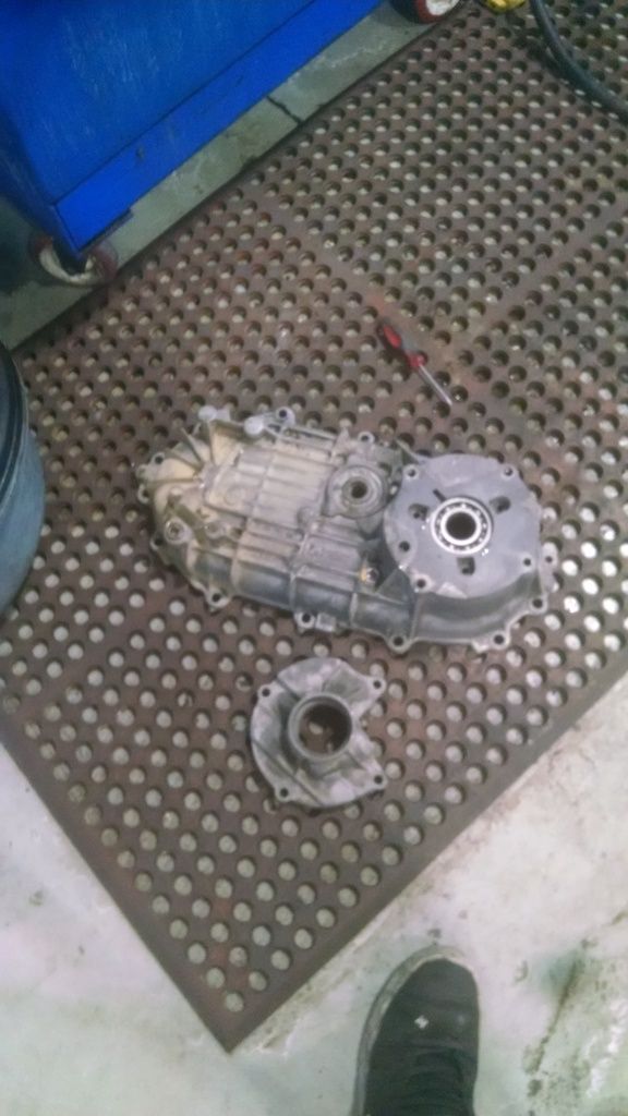

And after running through the parts washer a few times.. (yes, I know the bearing is still in it. I'm ordering all new parts, just didn't have a bearing puller and didn't think about the press until after I got home yesterday)
And finally, I've been staring at this truck outside my bay at work for about a month now.. Beautiful inside and out and found out Friday that the guy that owns it had a bunch of engine work done on his car and he can't afford the bill now. So he put his truck up as collateral until he found a way to pay for it... Friday, he told my boss he's going to just hand the title over to Subaru to pay off the shop bill and get $1000 back.. With discounted emplyee pricing and the $1000, I can buy it for a whopping $2500.. Runs, drives, is perfect inside, and only has minor clearcoat issue. Has the 400, auto trans, 2wd, dual tanks, and the lock box in the pass side of the bed. It was owned by an older guy that babied it and tried keeping it covered unless driven.
That's about all I got for now... just gotta see what's going on with the block on my lunch tomorrow.

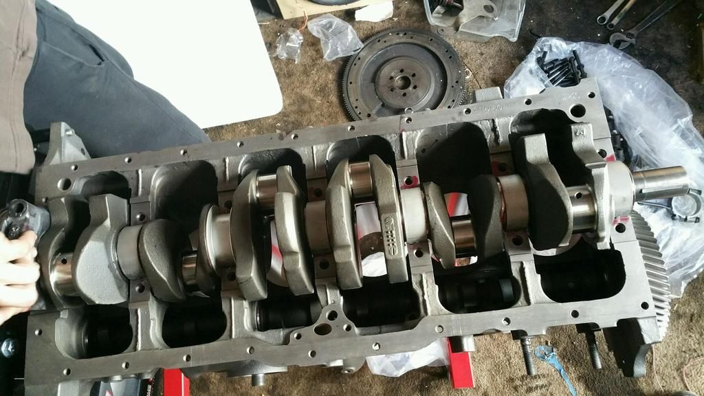

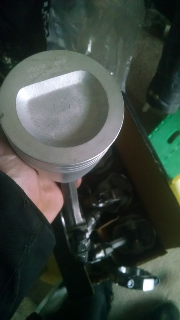

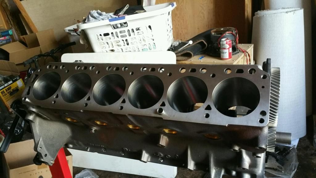

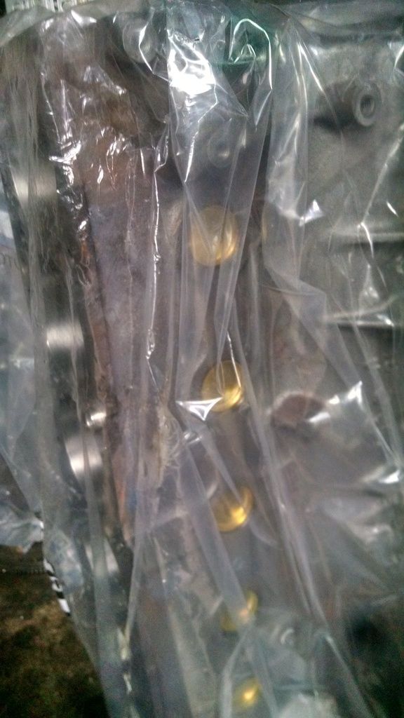

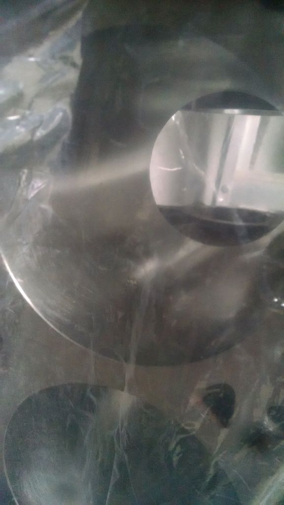

FINALLY got all this back. Understandably, they're busy, but at the same time, they continuously pushed mine onto the back burner.. I haven't taken any of it out of the bags except for the pistons. just have a couple more things to order and then I'll start assembly.. Then onto the trans and transfer case.

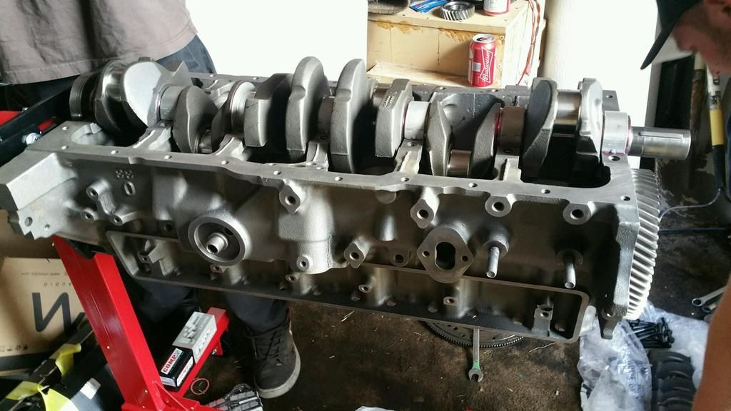

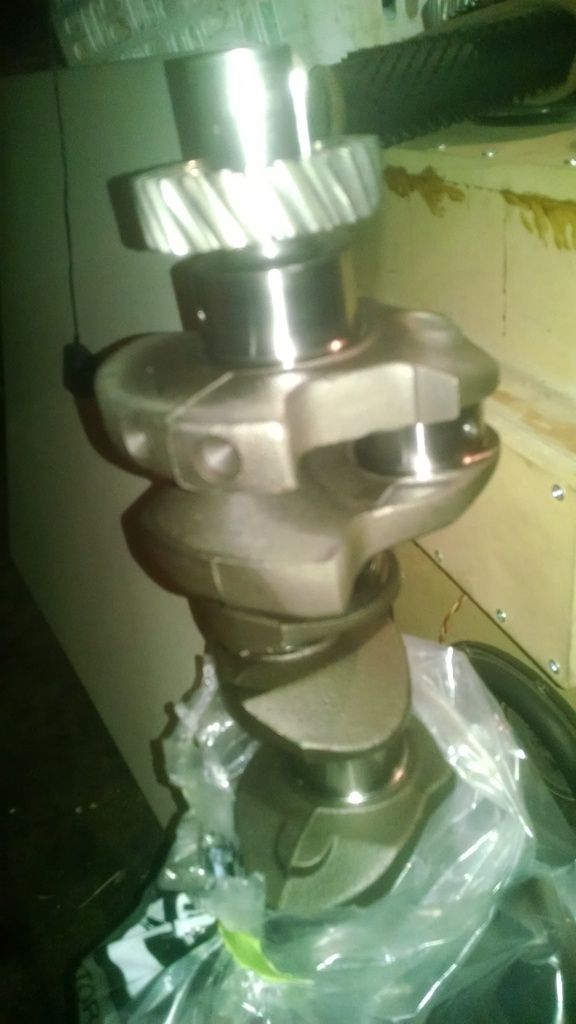

Some stuff showed up and had to get a woodruff key that fit.. had to work today on my day off so I didn't get much done. And sorry about the crappy quality on the pics, my phone is starting to crap out. So I might have to start using the gopro..

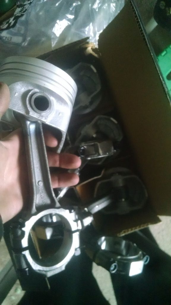

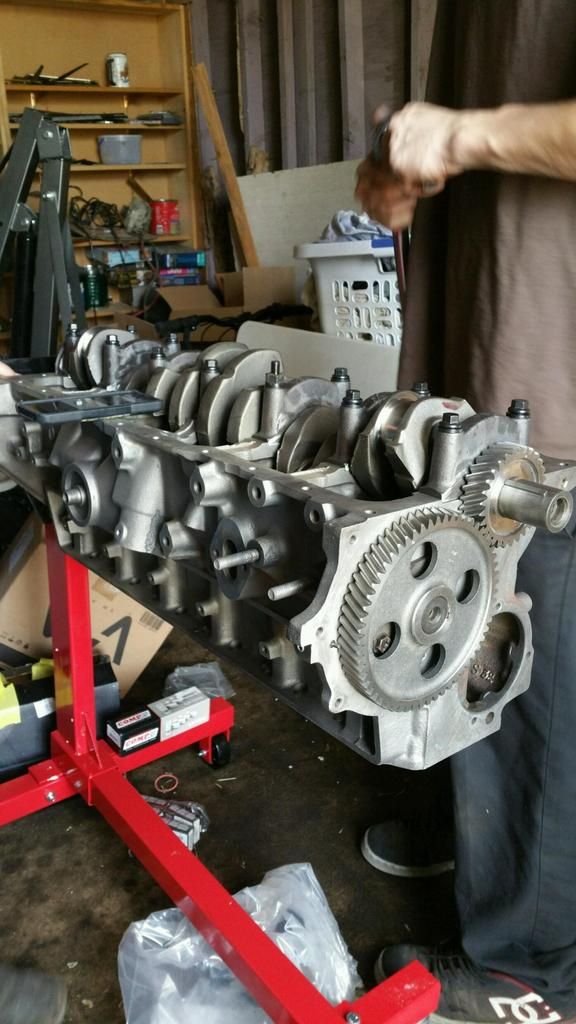

Well, went and got a new engine stand, just might have to modify it to support the front of the engine. Seems to be leaning to the front.. anyways, here's some more pics and ignore the mess in the garage/shed. Had a ton of stuff thrown in there because of new carpet and things going on in the house.
You might have this all fixed by now, but you could take a look at this thread.
Another 1356 T-Case issue to look out for
Check out my "Molasses Project"http://www.fullsizebronco.com/forum/showthread.php?t=197652
well shit.. that explains a lot.. I guess its time to modify my tcase or look into a different one
but thanks for the heads up.
