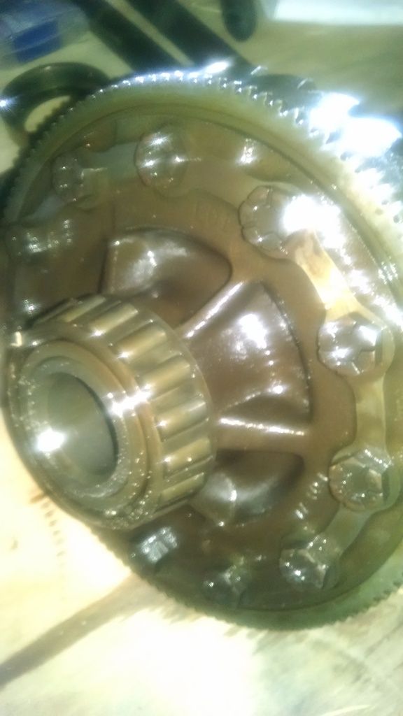

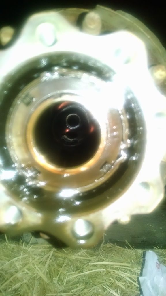

Then back in December I had an issue with the wheel bearings. Complete mechanical failure on the 24th of December with it starting to snow...

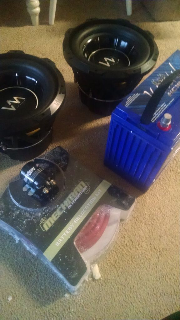

Then decided I needed to add a second battery, isolator, and 1/0 gauge wiring to keep up with my stereo due to all of this being added.

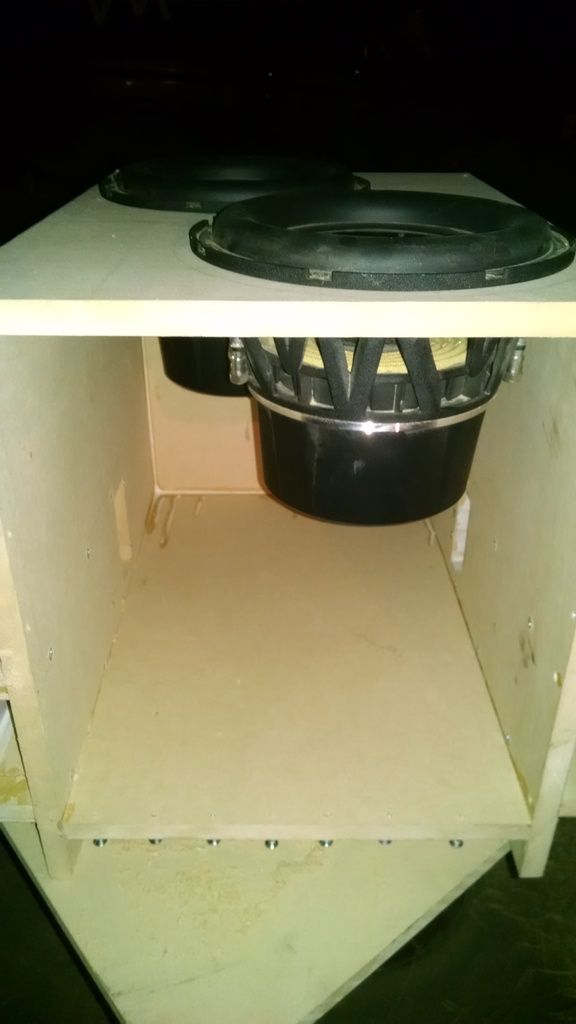

And with the 4 subs, 2 4200W amps, 2 batteries, ect. I decided to go to my first stereo competition. However, 2 days before the comp, one of my 12's blew, one of my 10s tried blowing DURING my run in the competition, and I had a low end kicker 12 in one of my 12's spots, AND I still ended up bringing home first place in my class. (The guy holding the monitor is one of the competitors lol)

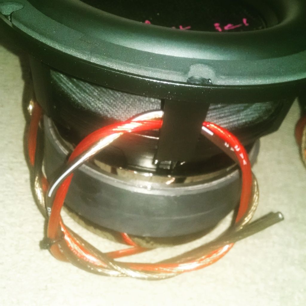

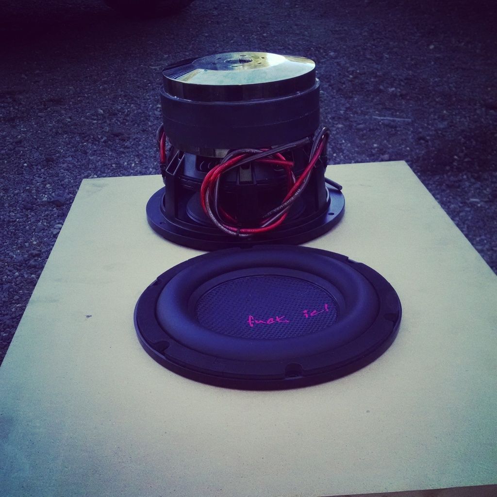

As far as the stereo, I'm upgrading to full competition subs/speakers. I'm swapping from 2 10" and 2 12" VM Audio Encores to 2 8" and 2 15" PSI Platform 3 subs. I have a 291A Mechman alternator, BLU1200 Kinetic battery for the main and HC3800 Kinetic battery for the stereo, all 1/0 gauge wiring, AVH-X2700BS Pioneer double din head unit, going to 3 way component door speakers front and rear, sticking with the 2 4200W VM Audio amps for now, and adding in a 4 channel amp for the door speakers. I'm halfway sound deadened in the cab right now, just need to rip everything out and finish it up.
The 2 8" subs have already been built and are in Wyoming (last I checked the tracking number) and the 15s havent been ordered yet. The 8s have carbon fiber cones and upgraded soft internals with 8 gauge wiring. Cost me $458 for the 2 and the 15s will be around $1200. The components (depending which company I decide to go with) will range from $200-800 per set.
In short, I have a lot of money already dumped into the stereo and it's just getting more thrown at it. I'm planning on being the loudest in central Oregon and already have a reputation at all the car audio shops for being one of the loudest around here. I know with the 2 10" and 2 12" I'm right around 148 db/spl and I'm trying to be 155+ after all is said and done.

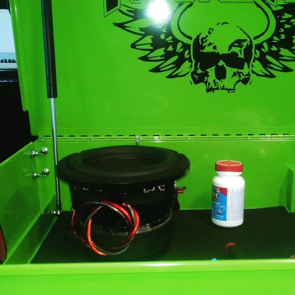

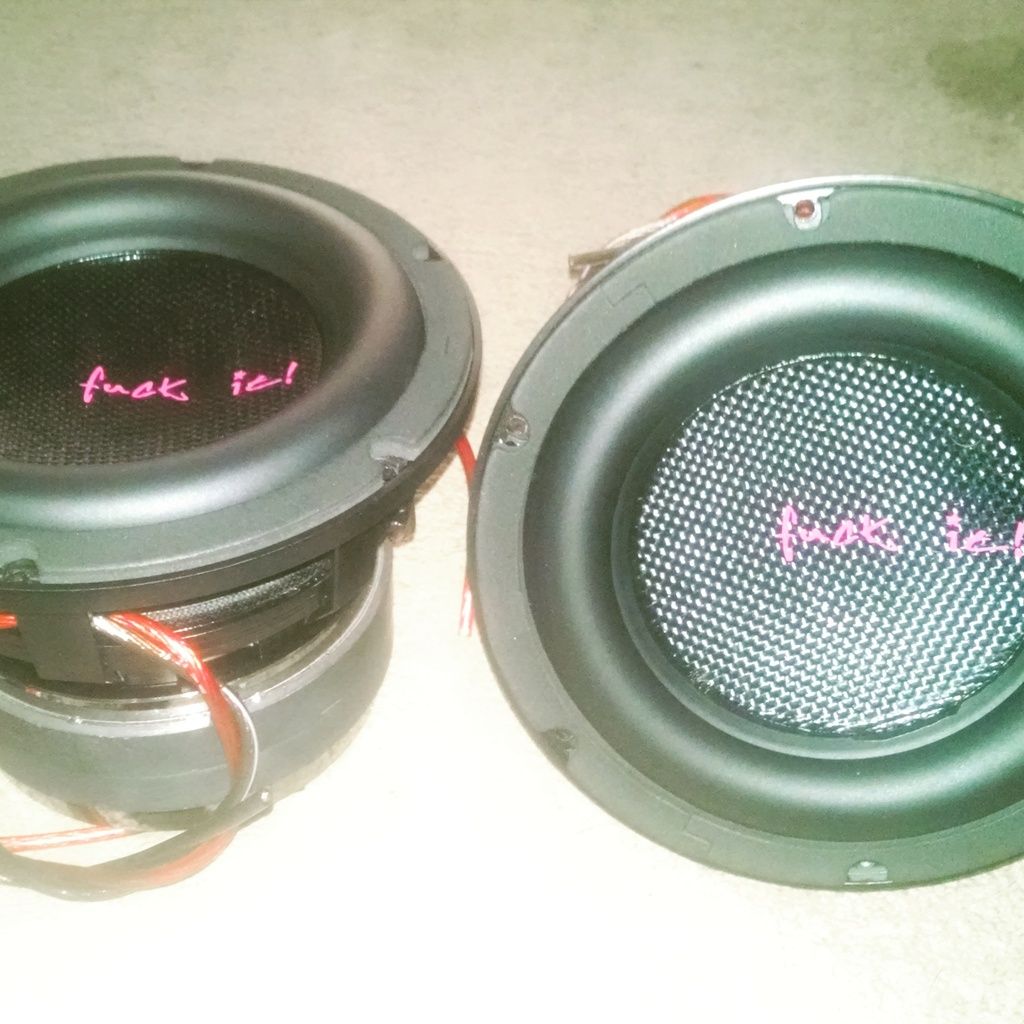

So things didn't work out today with picking up the sterling 10.5 since the guy was only in town for an hour, so we arranged to pick it up tomorrow on my lunch break. However, yesterday a couple packages showed up and I've been admiring them in the mean time.
The 2 PSI 8" subs
And I couldn't go to work today and visualize the subs, so I brought one with me so I could look at it at work lol

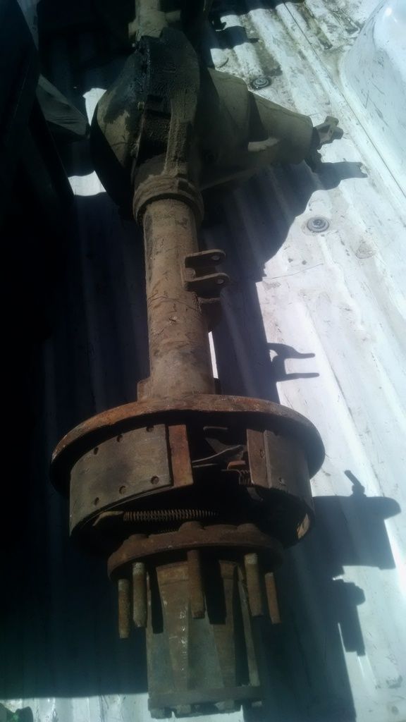

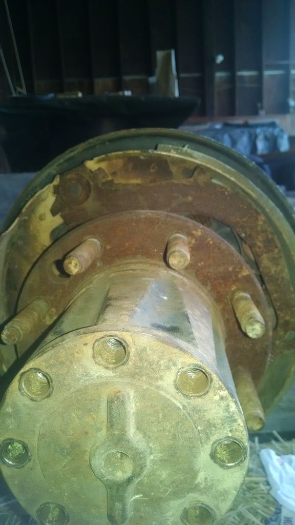

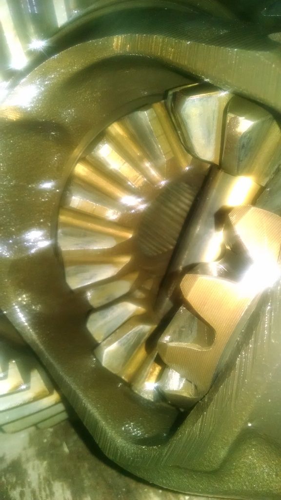

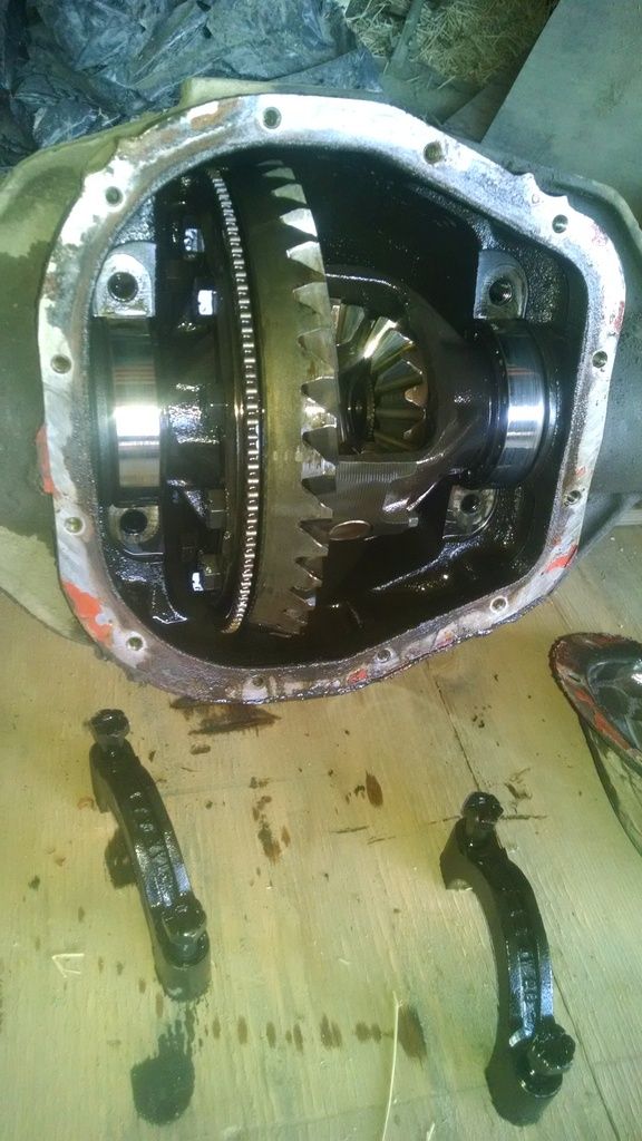

So it's been a couple days since I bought the axle, but here's the update.
It's an 89 f350 rear axle so it's drum brakes on the rear. Plan right now is to swap it to disc brakes, 5.13-5.38 gears (haven't decided which one to go with yet), do a truss over the pumpkin with the brackets to do the 4 link, still deciding whether to coil or leaf spring it, powdercoat the axle (after all modifications are done), and then rebuild it with upgraded internals/a limited slip

Originally Posted by 88LiftdBronco View Post
Then, out of curiosity, since I'll be swapping to 1410 u joints, if anyone has information on it.... How do you swap the output on the tcase to hold the larger u joints.
You know you will have to get custom driveshaft because the Sterling is longerup front. So if your doing that, you could just get a 1350 flange on the front of the DS. The 1350 and 1330 flanges have the same bolt pattern. You will probably never bust a 1350.
On the front axle, I highly recumend the Superduty D60. Get a 2005 or newer. If you check my project, you can see how I mounted it. It was very easy. (Almost bolt on.) First I used the stock (SD) arms and later I made my own from rough stuff parts.
The three link or four link will flex good, but you probably want sway bar(s). On my project, I made the front "pinable", so it handles like radius arms when pinned. Note, radius arms act as sway bars on a solid axle. They do not on the TTB.
Check out my "Molasses Project"http://www.fullsizebronco.com/forum/showthread.php?t=197652

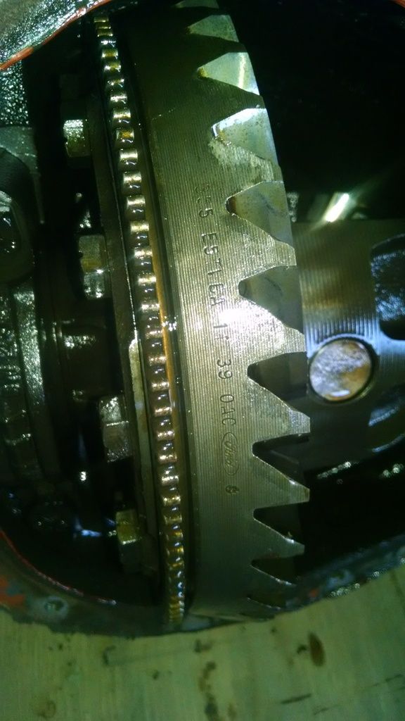

As far as the axle, I need a D60 pre metric bolt pattern. I don't want to be running 2 different bolt patterns/rims.
Then, upon looking up info on the sterling 10.5, Everywhere I look it pops up with a 35 spline and the only aftermarket gears come with 31 or 30.. Confused on that part as of right now. But I HAVE decided to go with the 5.13 ratio. It'll be a 78:1 crawl ratio and at 70 mph, the rpms will be at 2100. So, I should still have power and fuel mileage a little bit lol.

I thought all the Sterling 10.5s were metric. (Mine is) I think the 10.25s were the 8 on 6 1/2". Maybe there were a couple years that the 10.5s had standard. In any case I would just look for the later axle with discs. I'm pretty sure all the disc ones are metric. The reason you want the 2005 and newer D60 is it is set up for coils. (Not leafs) Also the early version had trouble with unit bearings. The newer ones have bigger unit bearings that solved the problems. If your set on the standard pattern, you could get a later axle and have the hubs drilled for it.
All the sterlings axles are 35 spline. I think you are confusing the pinions. I think they are 31 spline. The axles plug in to the carrier, so it doesn't matter what splines the axles are. You just have to have a carrier that excepts them. ( I think you can get 40 spline axles/carriers. $$)

Oh ok. Ya, I was a little confused because the aftermarket gears kept showing pinion spline as 30 or 31 and on the info sites for the axle, all it said was "spline - 35". As far as metric or standard, I'd prefer a 99+ D60 but if the rear is standard, I don't want to have to buy 2 different sets of rims to make it work. Too much problems doing it that way. But I'll look at it when I get home and see what I'll have to do about it. Thanks helirich!

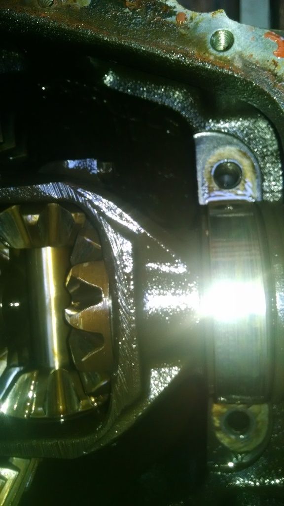

Started tearing down the Sterling tonight. Not going to make a ton of progress, but at least it's a start. Here's where I'm at as of right now.
3.55 gears still in good shape
spider gears still doing good

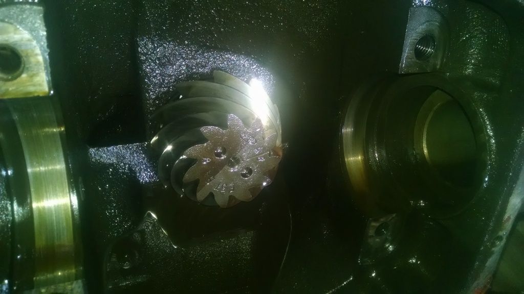

Just curious what this hole is for... I'm guessing a breather vent for the housing? It's on the top of the driver side axle tube.
My plan is to get at least one axle shaft out before heading to bed and then finish the teardown tomorrow after work. Then sell the internals for whatever I can get for them on CL.

Well... that was easier than originally planned lol. Chilton made it sound so difficult than it actually was.
And I found out the hard way to clean out the housing before taking pics... Accidentally dropped my phone into the used gear oil and it was completely covered... luckily it still works fine and still takes good pics. As you can tell, I have towels in there soaking it up lol
I'll try to finish the teardown tomorrow.

I just got done doing this. Make sure you clean out the ring gear holes with "brake clean" and use lock tight. I was told to use shouldered bolts from a D70. But I didn't. Crossing my fingers.
That vent hole also holds the brake line "Tee". I think I got pic. I'll look.

Ok. well the gears that came out of it are 3.55 and an open diff. I'm replacing everything and going to 5.13 and an LS

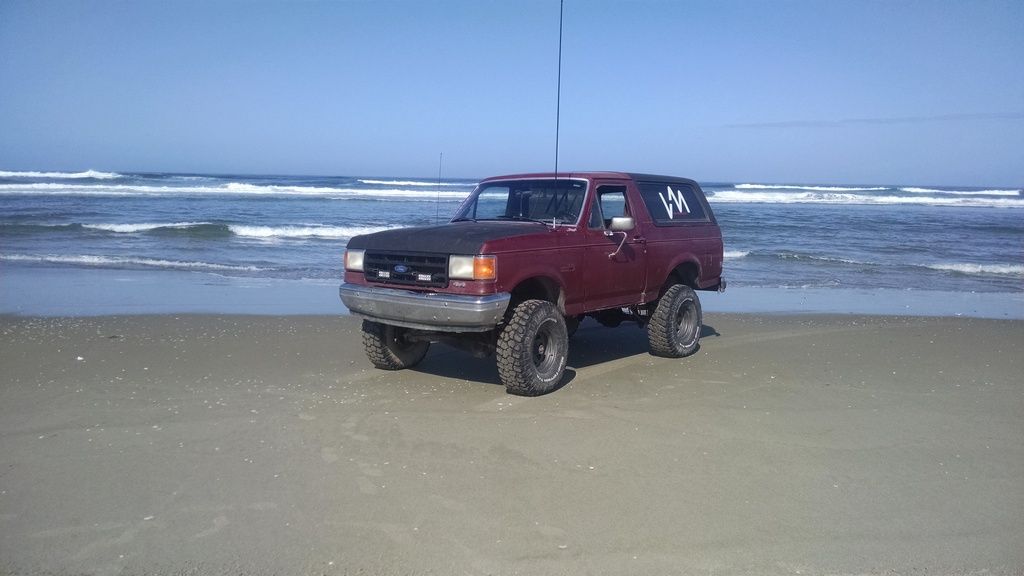

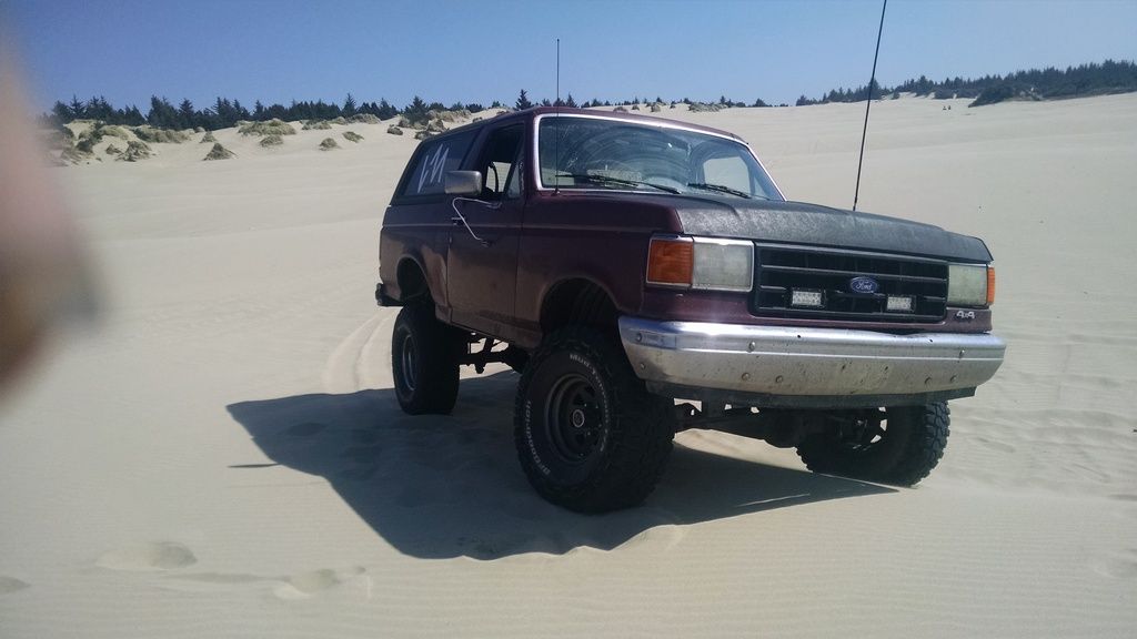

Might as well make one last trip before tearing her down... so here's the pics from it.
(forgot how to embed videos onto the thread)
Found this beauty on the beach
She has more pics of it on the dunes, but I wasn't able to get them immediately. I'll add those in this post later on

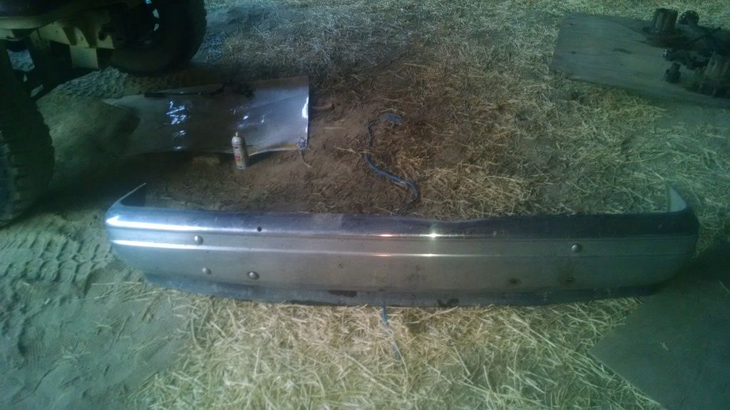

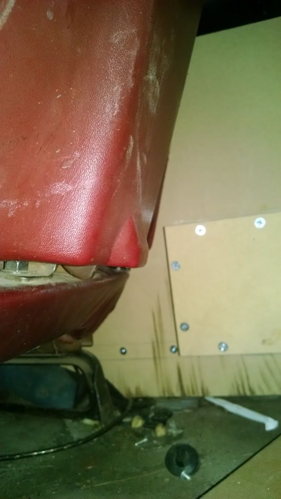

However, I did get the pinion pulled, ring gear off the carrier, and also did this
Much better approach angle, but it's just one step of many to the full teardown. I'm planning to get the bronco ready to have the body off this weekend then pull the engine, trans, and tcase.
