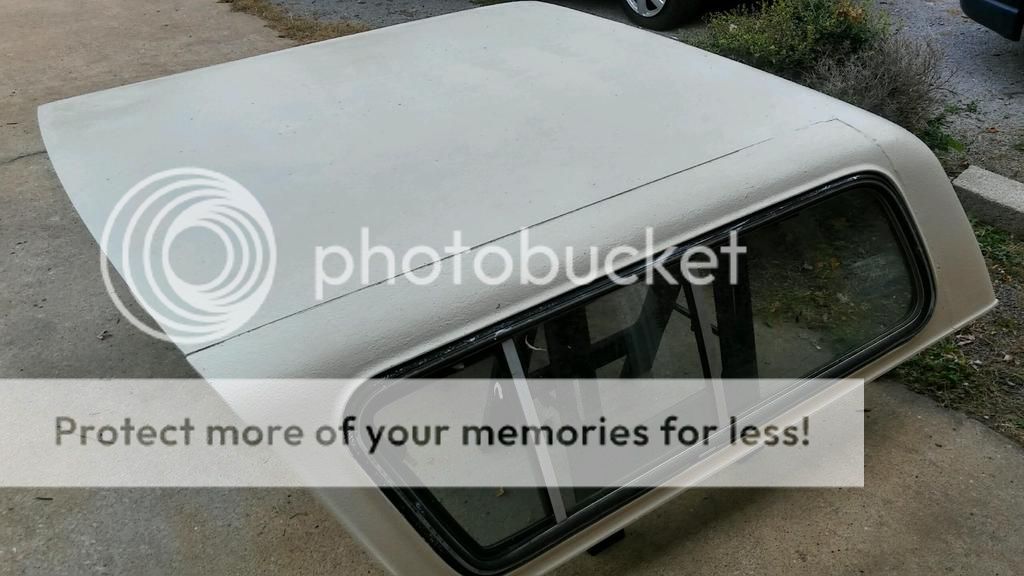

In other news- I worked for a couple more hours and came away with a couple of 2ftx4ft sections of floor pan, including the section right behind the front seats, which is what I really wanted. Sucked that I couldn't get more though, so I'll either be using sheet metal or ordering from JBG or LMC.

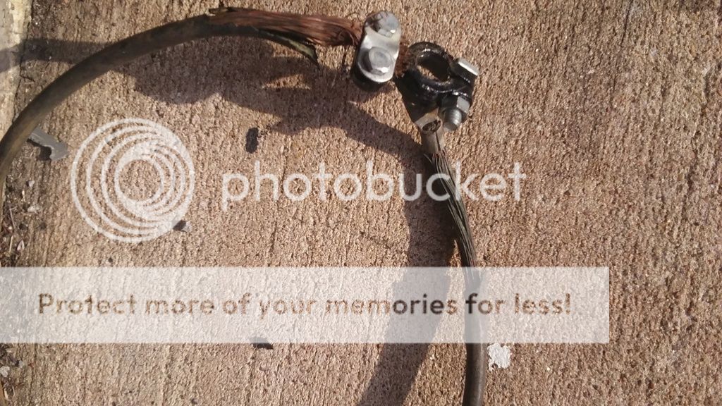

No big updates this weekend. Replaced the battery cables and cleaned up the connections- was having intermittent start problems that I was 99% sure was coming from the cables. See pic below for why. Had a few hours Saturday to power wash out the interior and underneath the truck, pulled out remaining carpet as well as the crappy roofing tin floor panels the PO had screwed into the floor to cover up the gaping holes. Pics below.
[IMG][/IMG]
Nothing wrong at all with this negative cable!

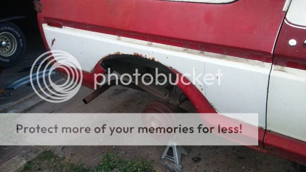

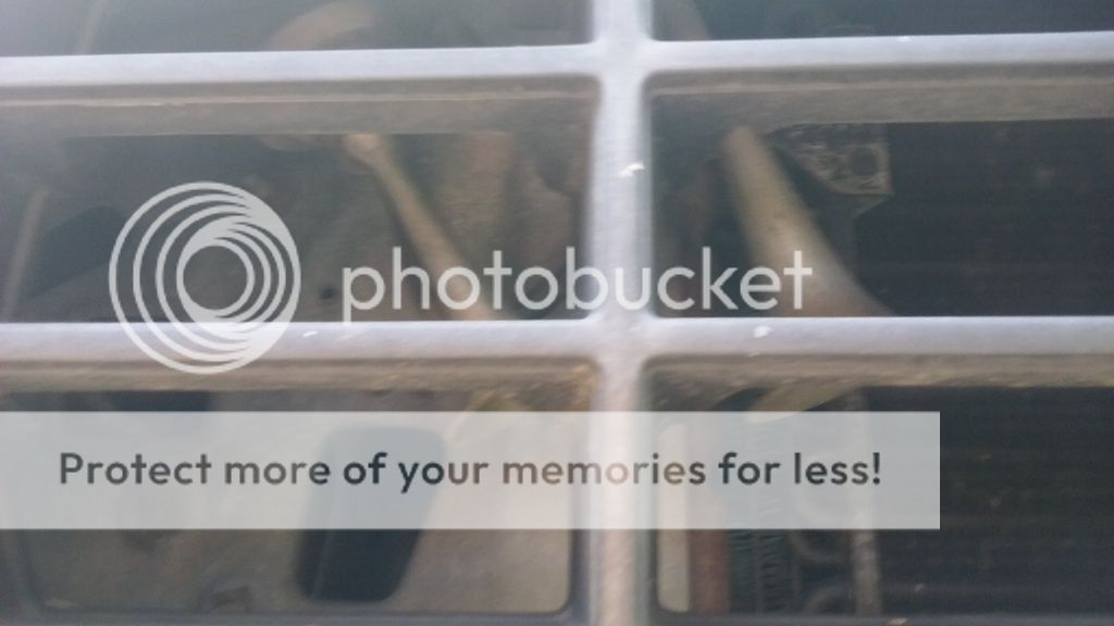

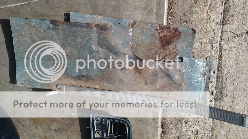

[IMG][/IMG]This is a pic of behind the grill- two horns on the passenger side of the truck. Are these stock? Either way, they're not working- I can hear air coming from the little pump/motor when I hit the horn button, but that air isn't making it to the horns. Not a high priority but thought I'd ask.

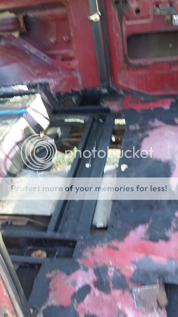

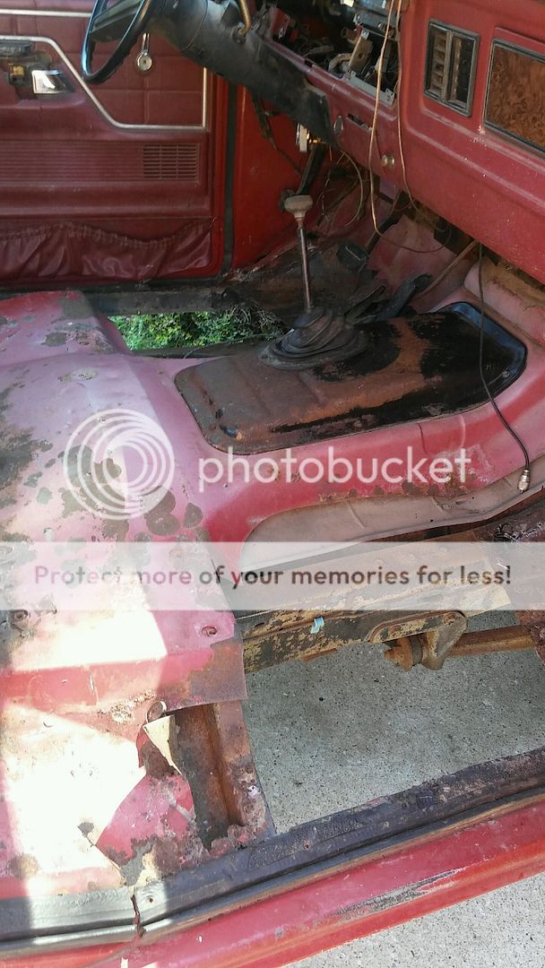

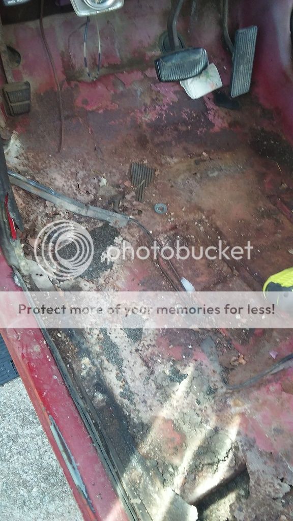

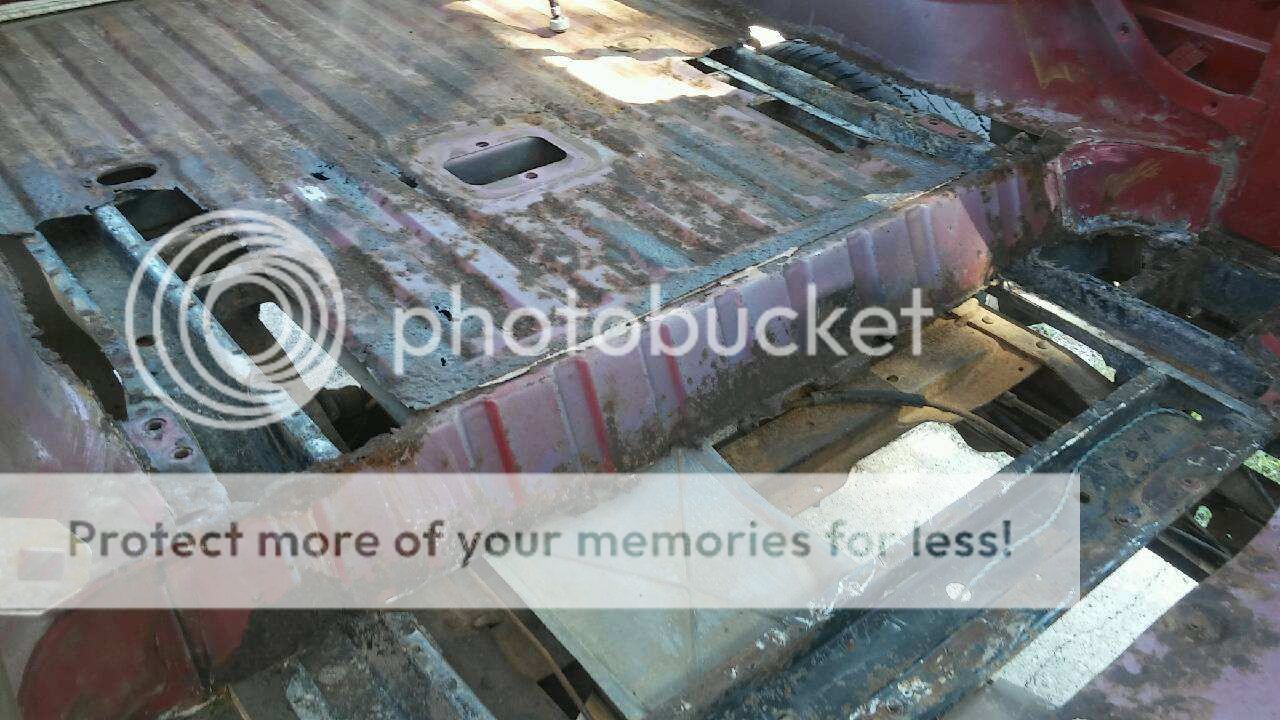

[IMG][/IMG]This was my floor.

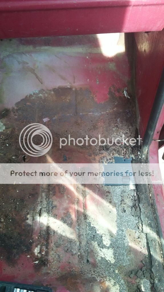

[IMG][/IMG] What was hiding underneath. You can see lots of my concrete driveway. Passenger side.

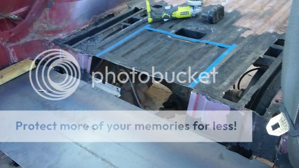

[IMG][/IMG]Drivers side.

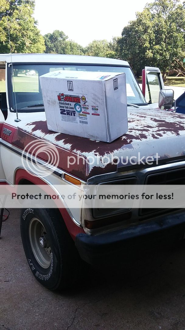

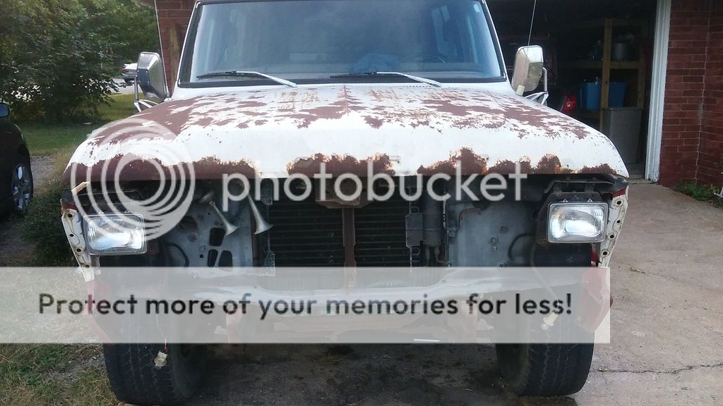

Few more updates. Took advantage of some free time this past week to remove the trim and now I have to decide whether or not to put it back on when I'm done.
Ordered paint (Monstaliner). I know I'll catch some flack for this, but I know myself and, for me, I'd rather not obsess over scratching a nice paint job when, someday, I do a little wheeling in this.
Started doing some measurements for the addition of the under-floor storage compartment (link here). In prep for that I removed the heat shield that sits over the muffler. I'll probably leave it off as I plan on re-doing the exhaust eventually.
Welded in the passenger side floor pan, but I did a pretty shoddy job of it. I'm learning as I go, and this is my first welding experience, so it's not the best. I may or may not end up removing this and redoing it before I paint the truck. Problem was I couldn't get my hand between the heat shield and the floor pan by the trans tunnel to rub in seam sealer, so I'm afraid there's some exposed metal under there. We'll see. Ordered some weld thru primer to take care of that for the next pans.
Picked up a set of doors from a truck that a guy was parting out ('76, I think) so I can make half-doors sometime.
Some of the undercoating I did last week. Sorry for the poor pictures, my phone is a piece of junk.
Taping for the storage box.
Trim coming off- needs cleaning
Monstaliner in the near future. Also managed to cut off that nasty broken bug shield.
Other side. Going to have to remove those last couple pieces of front trim after removing the doors (can't easily reach the acorn nuts).

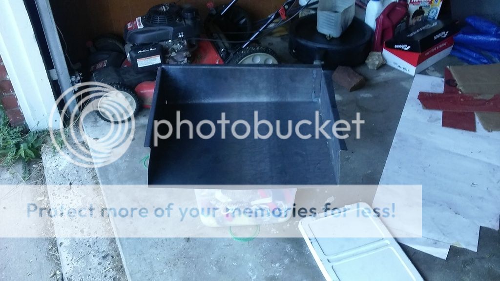

My box isn't perfectly square but is functional. I was using a borrowed brake after sundown so I was lucky it came out this good.

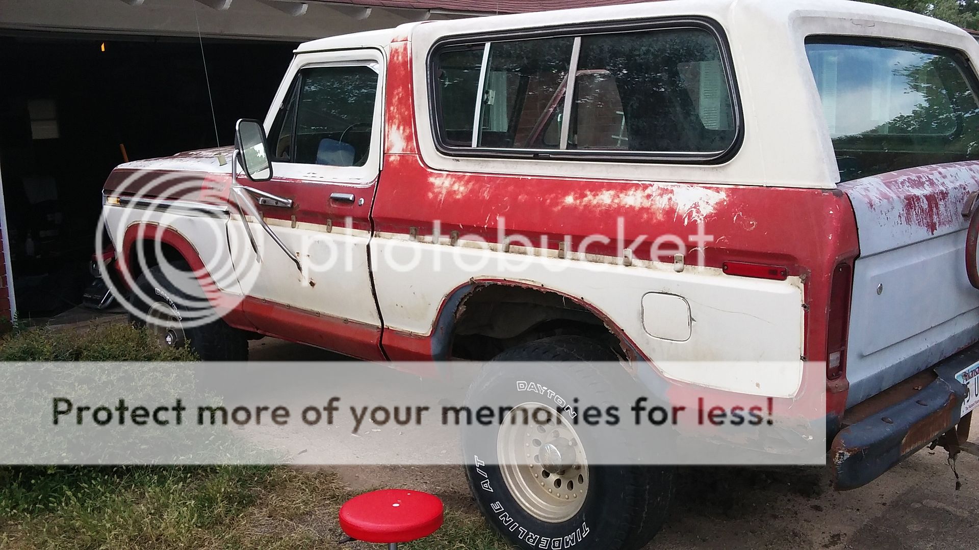

Good stuff done last week and this weekend.
Almost ready for paint next week.

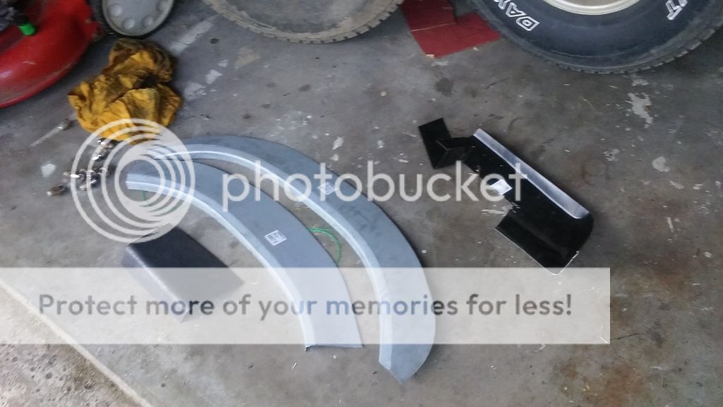

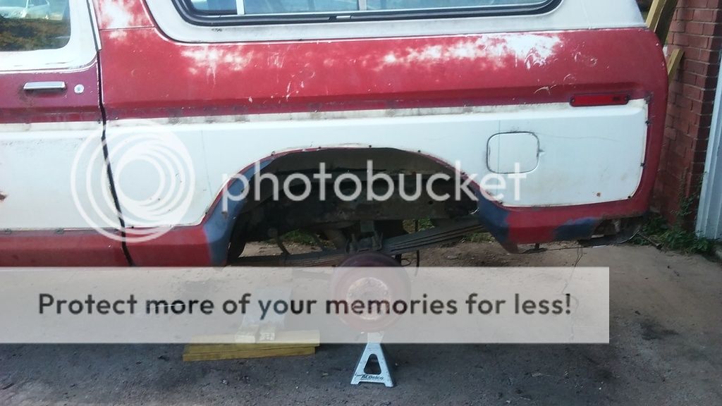

Patches for the rear fenders and corners.
There was a ton of caked mud and dirt in the rear cab corners (under the tail lights). No surprise they were rusted out.
It looks terrible in my driveway, but I got the bumpers removed as well as the grill. Good opportunity to clean.
Passenger fender trimmed

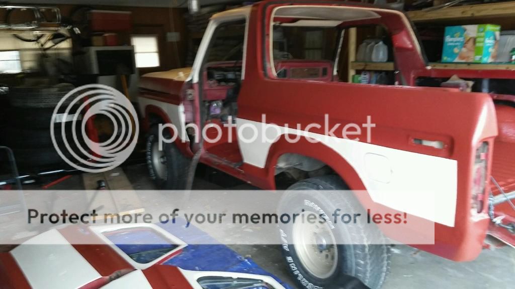

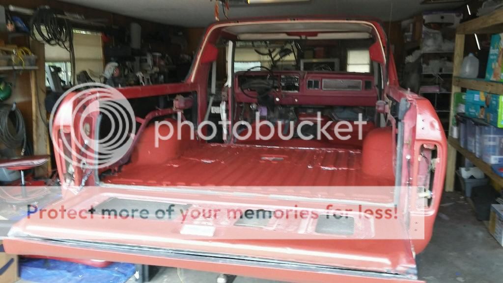

It's been a long week.
For the last two weeks I've been staying up late after the family has gone to bed to get the floors in and get the body finished. My goal was to get it all done by Monday as I had Monday/Tuesday off of school and work. I did get just about everything done and was able to wrap up all the prep Monday morning, so I used Monday afternoon and all day Tuesday to paint Monstaliner on and I'm pretty happy with the results, but there are definitely a few things I learned.
Monstaliner is a great product, the instructions are really clear and the result is great, but you have to be careful with the rollers they give you. The 2 gallon kit, which I used to coat the exterior and the floor of the interior, came with 3 foam rollers and I ordered 4 more, so I thought I had plenty. The first one started disintegrating and leaving little flecks of roller in the paint just a few minutes in, and I ended up using 4 of the rollers for just the white paint (mix of White and "Killer Beej"), which was the first half of the project. Maybe I was using too much pressure, but now I have lots of little bits in my paint, which isn't the end of the world but it definitely doesn't look as good as it should.
For the 2nd half, all of the red (Blood Bath tint) I rolled the first coat on with a regular roller, which worked way better and lasted the whole coat, used a 2nd coat to go over spots that weren't originally red, then a final coat with 2 of the Monstaliner rollers.
I have maybe 1/4 gallon left of the product and enough of each color to go back over any spots that need attention. I also plan on widening the white stripe on the rear 1/4 panels as they are too thin right now and look stupid. After a few days of good drying I'll put it back together and take more pictures.
The top looks MUCH better since the fiberglass was beginning to show its age and even multiple powerwashings and scrubbings couldn't remove all of the dirt and mold in the cracks.
Interior- don't love that the dash doesn't match the color, but I'll do something about that. It's much better now than it was, that's for sure.

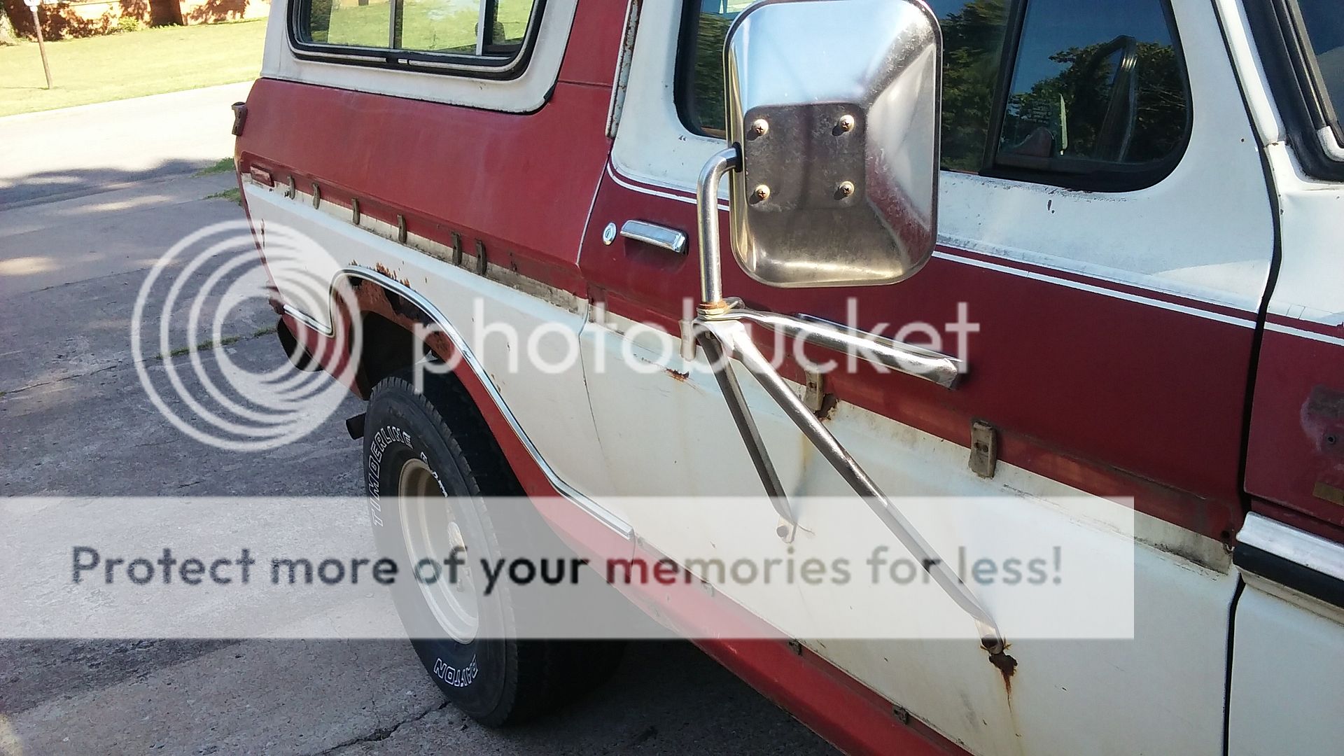

Side shot. Love everything except the white on the 1/4s.
The better paint shows the dings and dents better than the old stuff.

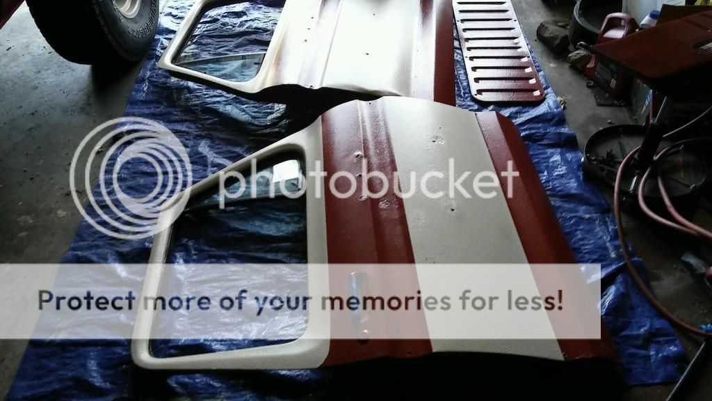

Doors look much better- had to take care of some bondo issues and rust the PO left me.
Took the opportunity to plastidip the front and rear bumpers while I had them off. Again, much better, and after installing them I'll do a final coat to even it up a little.
