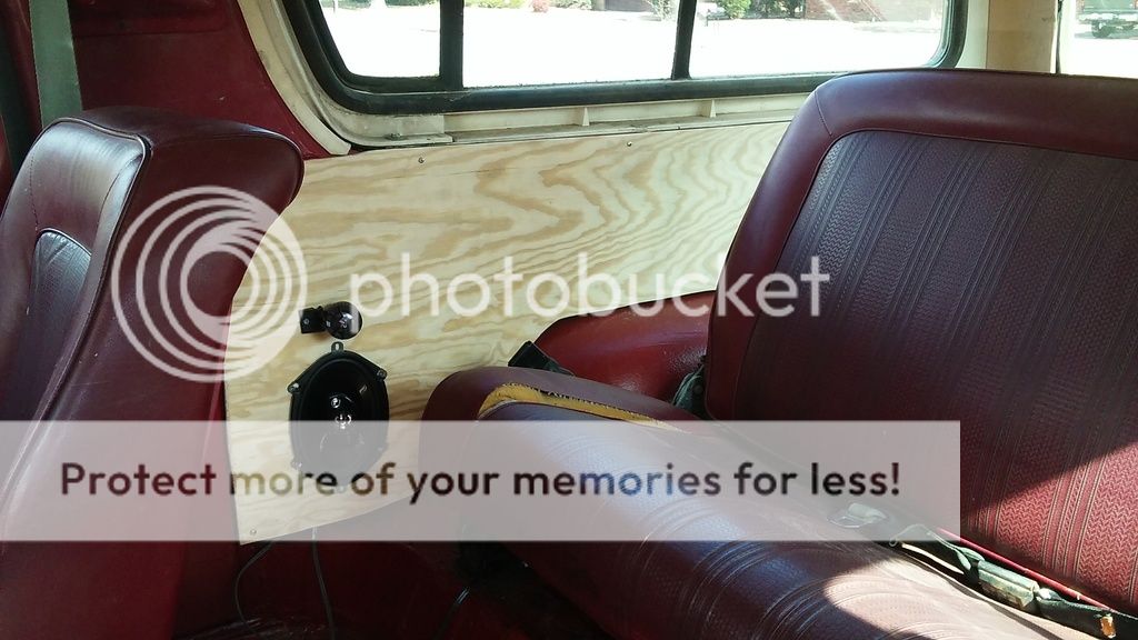

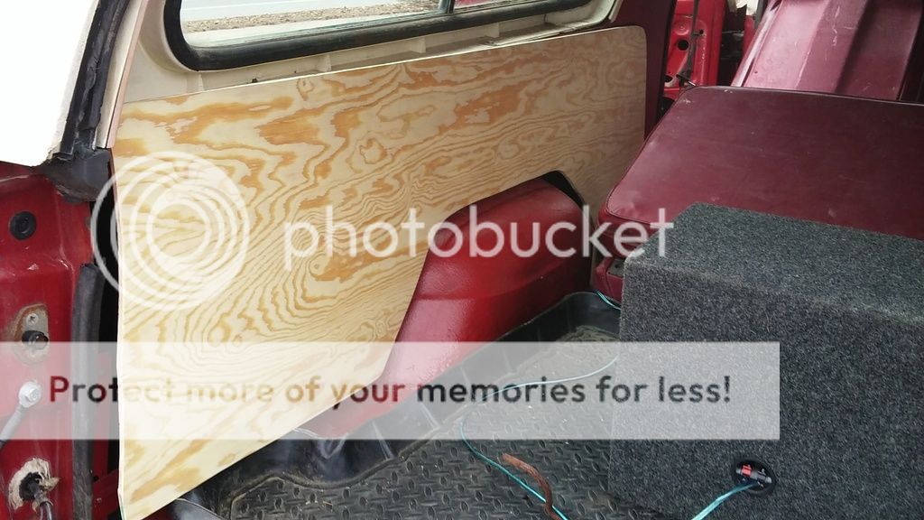

Been another busy few weeks. Had to find a job since I'm finishing school in May. With that taken care of, I was able to get back to the truck this past weekend.

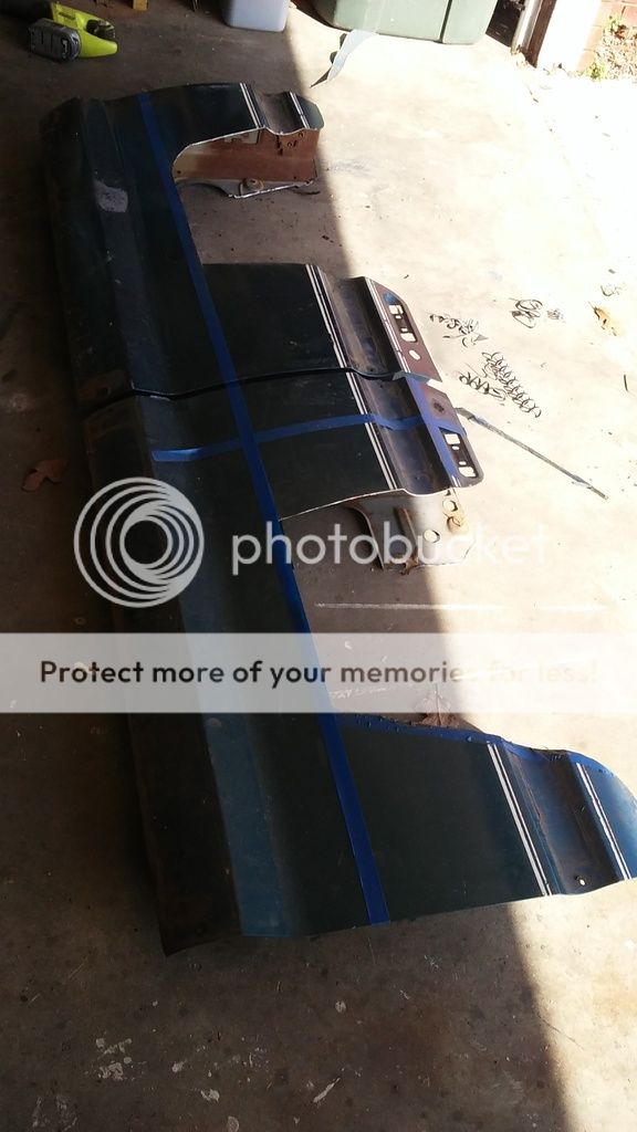

Two main projects- rear bed-side panels and half doors.

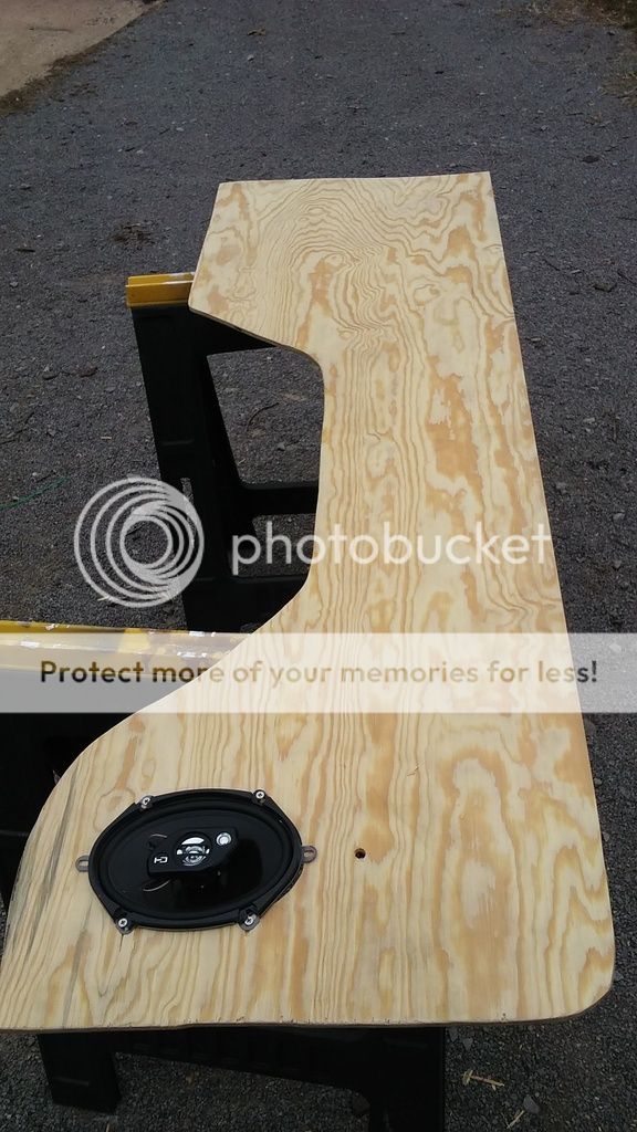

For the rear panels, I started with some posterboard and cut it to shape as closely as I could. I know that there are templates available on here, but I figured after I had spent the time and money to have them printed I could have just made some myself.
Used those templates to cut out both panels in 3/8" plywood, did plenty of test-fits and trims as needed (jigsaw came in very handy here). Then cut out holes for the speakers, which are little too low but they work, and did my best to drill holes in the panels that matched to the holes that held in the old cardboard panels.
All in all I'm happy with it, but I have to decide if I want to now use these wood panels as templates and create more permanent metal panels or just stick with the wood and risk breaking them or something.

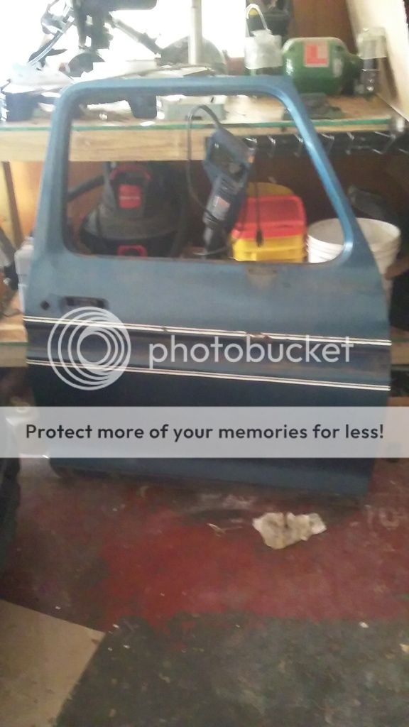

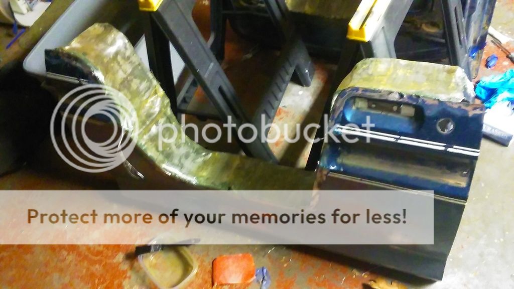

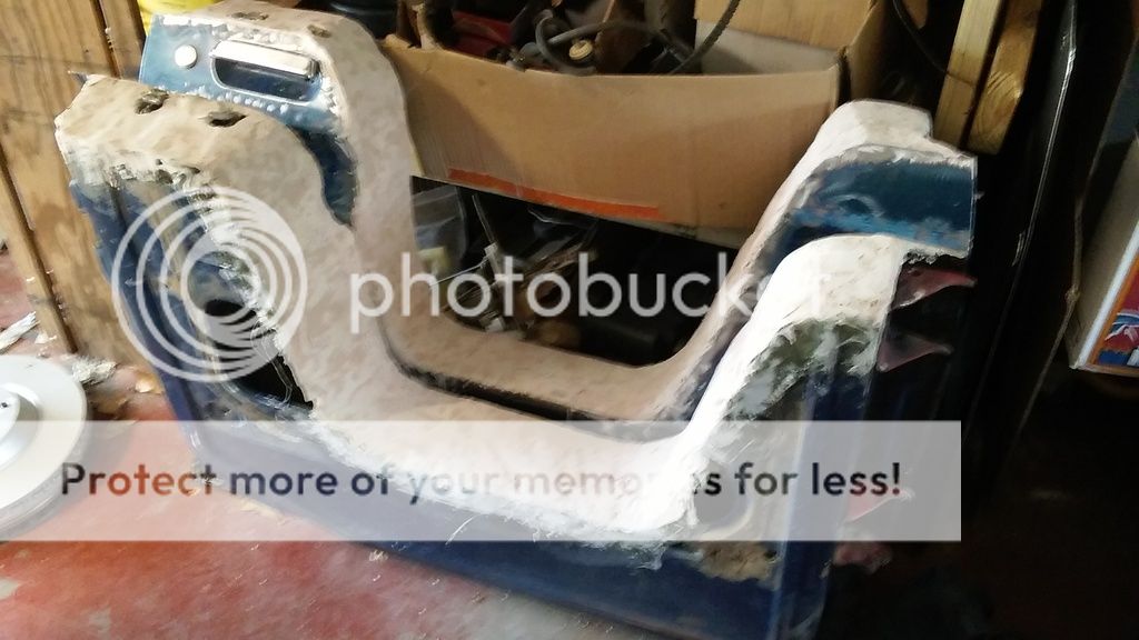

2nd project- half doors. Only got started on this project this weekend.
Took my extra set of doors and pulled everything out/off of them.
I marked them with tape and then pretty much started cutting. It was pretty straightfoward, and the angle grinder did a great job. I'll need to do a lot of cleaning on the edges, but it's not too bad, and I'm going to round out the corners to make it look cleaner. I'm using half doors by a short-lived member named Seve (you can find pics here) for inspiration.
Next step is to pick up some angle-iron and then weld in some supports since they're flimsy without the top half. After that I'll either fiberglass or weld in the top portion and put them back together! More to come as I find the time.

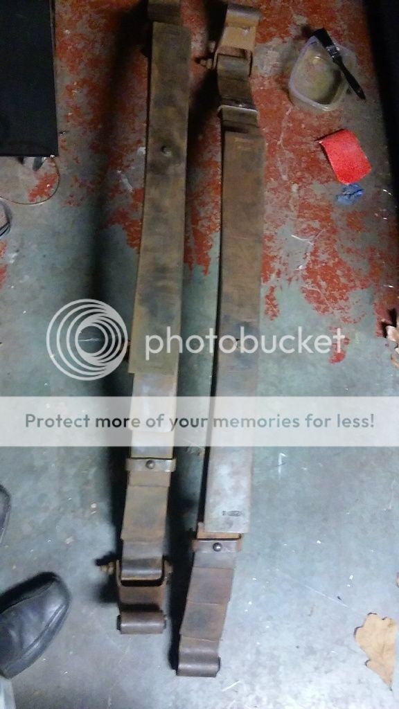

Slow progress- not sure the doors are going to turn out as well as I'd hoped. The fiberglass is a lot more of a pain than I expected- probably would've been easier to use some 18 gauge metal and bend it into shape then spot weld it. If this doesn't work, then I'll start over and do that.
Found a set of replacement leaf springs (I have a broken leaf in each of my current springs) in a yard nearby and am going to be replacing them soon. Also planning to order a set of Rancho 9000's (on rebate now, plus they're not too bad at RockAuto) unless I change my mind and downgrade. Any thing else I should change while I'm under there? Any tricky issues with the shocks? I've pulled leaves and shocks at a yard before, but obviously I'll be much more careful on my own truck.

Look over the wedge real good. Did you grab the wedges with the yard leafs? These tend to break easily especially if you drop them or apply too much pressure in the dimple. Bushings for the leafs?
Ah, I didn't grab the wedges. The yard actually pulled them for me- it's one of those types of places. Should've asked them to. I've looked over the bushings and they look pretty decent, but I'll probably order some new ones and have them pressed in just in case. Thanks!

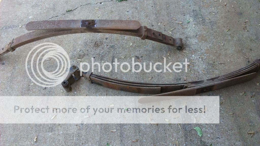

Spent most of the weekend doing yard work to prepare for spring, but managed to get a couple things done.
Cleaned up the new springs with a wire brush, they look pretty good and seem to be in good shape. Planning to coat them with chassis saver and see how long that protects them.
Also finished fiberglassing the half doors. The results were... disappointing. I definitely saw this coming, but I was hoping for better. I should've realized the cloth wouldn't hold a flat shape, the gap is just too large for something like this, so the surface is all wavy and it would take a couple gallons of bondo to smooth it out. Luckily the doors are still salvageable- I can either cut out all the fiberglass and start over with metal, or, what I might experiment with, is putting foam over the top part where it's fiberglassed and wrapping that in some marine vinyl that I have that matches the cream color on the truck. Might be nice to have it cushioned to use as an arm rest. We'll see.
I would cut the fiberglass out and start over. You can use glued in foam to gap the area you are fiberglassing. Shape the foam with a hot knife or sand paper. When you have the shape you want paint the exposed foam with a water-based latex house paint. This seals the foam and allows you to fiberglass over the foam. Once the fiberglass has cured you can go back and melt the foam out with lacquer thinner or just leave the foam in place.
rossisnow likes this.
Dang. That's a much better idea- wish I had thought of that! I'm going to experiment to see what I come up with, but that will certainly be my backup. Luckily all the fiberglass stuff only cost like $25 dollars and really didn't take that long, so I'm not out too much either way. Thanks Scoop!

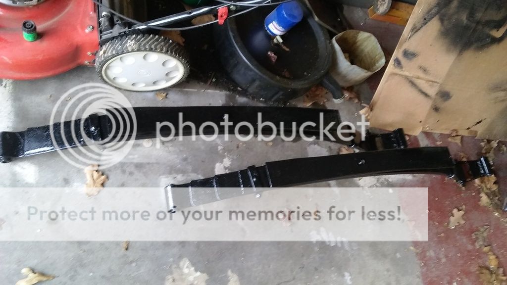

Bronco Info: 1979 Custom 351m
Time is short but planning a few things this weekend. Have to change out the front brakes and rotors on my DD as well as change the belt tensioner, but I've done it all before on my wife's car so I hope it doesn't take very long. With what time is left I hope to replace the leaf springs and the shocks, and then sometime soon replace my fuel filler hoses and parking brake cables.
Here are my cleaned up springs (painted with Chassis Saver).

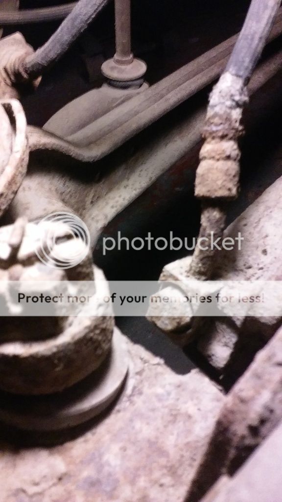

Woke up Friday morning at 3:30am thanks to my 1 y.o., couldn't go back to sleep so I thought I'd get to work. Replaced the brakes and rotors on my DD (toyota matrix). That didn't take long then buttoned all that up by 5. Pulled the truck into the garage and started on the front shocks. They came out easily enough and got the new ones in, but the passenger's side seems way too compressed- there's probably 2-3" of compression left at most.
I double checked the model numbers and all, and it's the one that both RockAuto and the Rancho site recommend... so I'm not sure about that. As soon as Lowe's opened I ran over there and grabbed some new lower bolts since they were crusty.
Very crusty front brake calipers- putting that on the list.

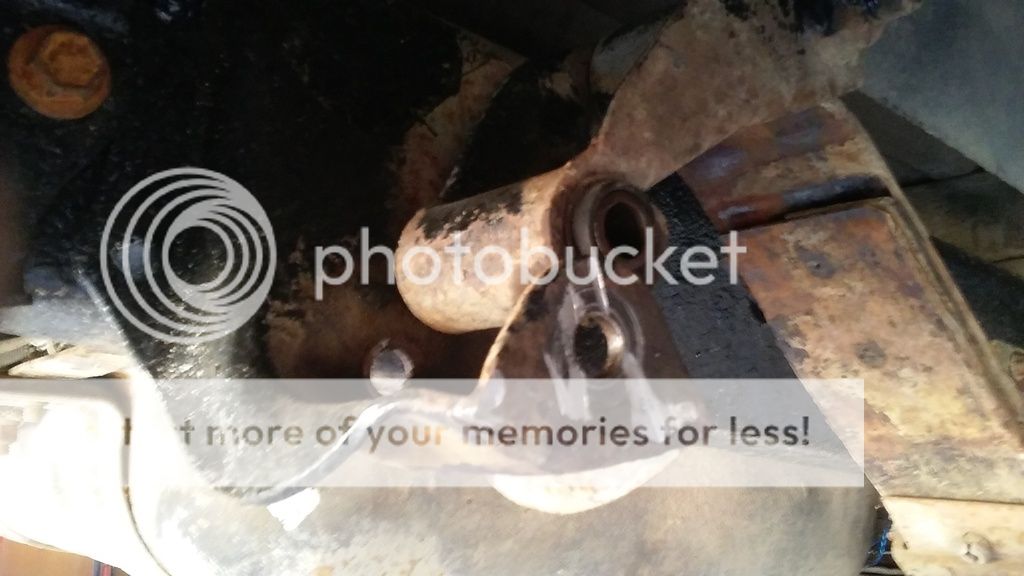

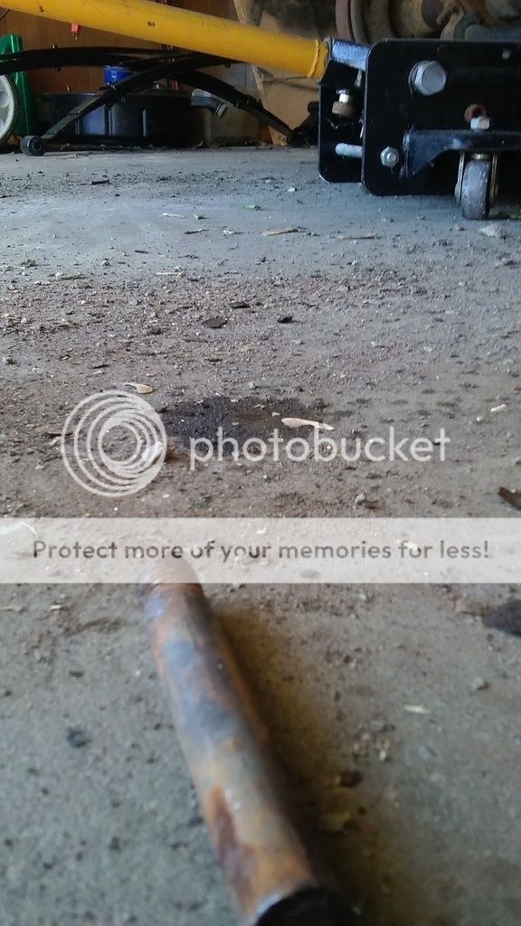

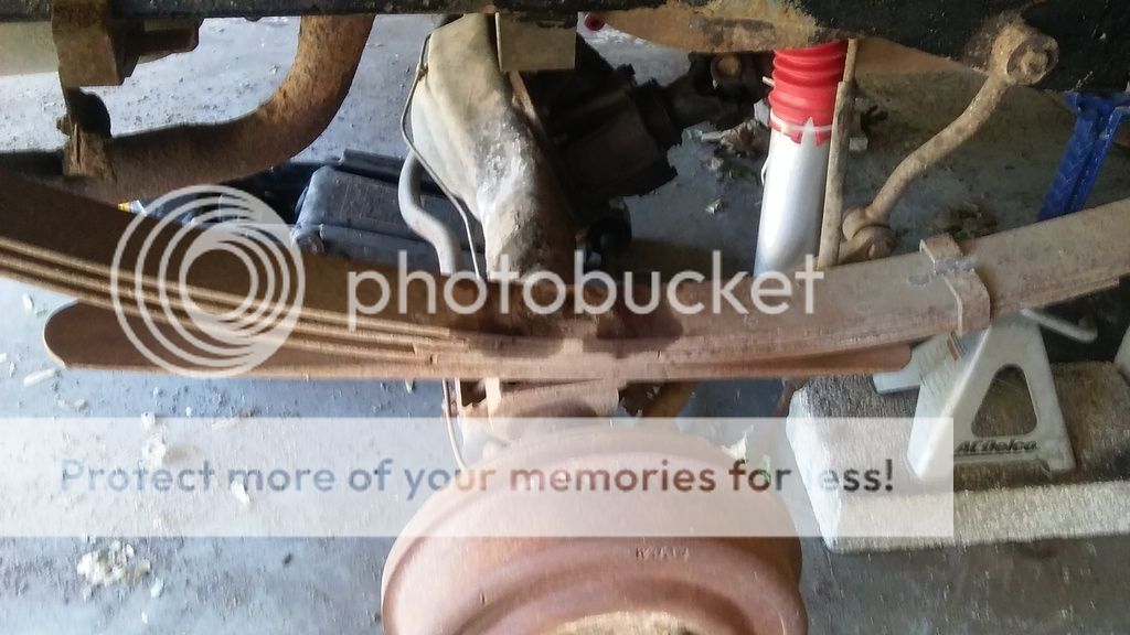

Got home and started on the rear, when things got real fun. All of the bolts were extremely rusty and my impact gun was useless. I broke my strongest breaker bar (1/2" drive) so I returned it to O'Reilly's. Shoutout to them- they did a great job of honoring the Power Torque lifetime warranty. Upgraded to a 3/4" 24" or so rachet that ended up doing the trick on all the u-bolt nuts, but with a lot of labor. My back is killing me today.
Success- ubolts off.
Supported the axle on a jack (before doing the ujoints) and then started on the spring bolts. Two came out with relative ease, but two I had to cut out. That took forever too.
Had to cut off the shackle bolt on the passenger side and the front spring bolt on the drivers side. This the shackle bolt- it looks worse than it is. I managed to cut off very little material from the perch.
Some of the crap that fell out of the bottom of the truck as I wrenched/hammered/cut on it.
Finally got the springs out. The passenger side actually had two broken leaves- I thought it was only one like the driver's side. I measured before removal and the driver's side fender was 5" above the tire and the passenger's was 4", so that explains that.
Had to go to Fastenal to replace all of the leaf spring bolts- ended up paying $40 since they wouldn't open the packages and sell them individually, so I have a few extra. Oh well. Got home and worked to get the springs in. That was also frustrating as I forgot to take into account the extra lift of the new springs (without broken leaves) so the axle was in the way and I had all my jacks in position already. After a lot of maneuvering I got the springs to line up and got the bolts in to hold them in place. Wanted to get the axle mounted to them but I was exhausted and frustrated and it was about 3pm, so I started to position them and gave up.
Resumed this morning at 5:30am and was able to line up the springs and attach the ubolts, but I had to disconnect the rear sway bar first so I could move it around and adjust the axle. At this point I'm in class all day, but when I get home I'll torque all the bolts correctly, put it back together, and take it for a drive. Pretty excited, but very tired and sore.

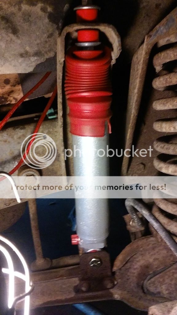

That's a lot of work. Be curious to see what you find out about that shock.
79BroncoSpringTx is offline
post #98 of 101 (permalink) Old 04-08-2017, 04:20 PM
Resident Nice Guy
schwim's Avatar
Join Date: Oct 2015
Location: Western NC, US
Posts: 1,140
The new rancho in the pass front of mine is squished as well(4 in lift). Mechanic had to about reverse the spin if the planet to get rancho to commit to a part number for it and that's what I ended up with as a result.
I take it easy so I've not blown it yet but I keep my eye on it.

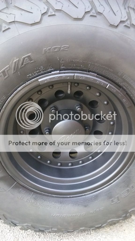

No news on the shocks- no issues so far, so I might change out the really thick bushing on the underside of the top mount to give the the shock another 1/2" of length.
