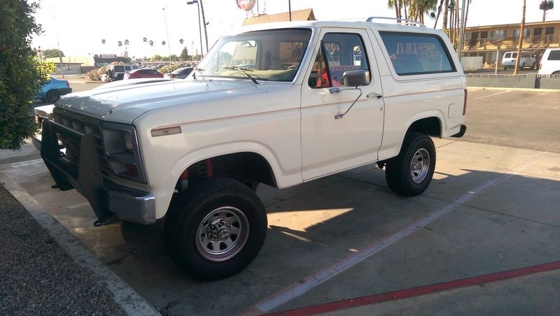

budget 84 i6 daily driver. Amateur hour has arrived

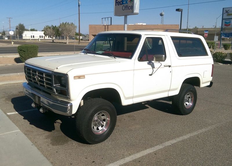

I got an 84 i6 4x4 because that's what I wanted. My search for the right rig with the 4.9 and Ac ... well it was exhaustive, I don't know if they had automatic transmission with the 4.9 but I didn't want it. I didn't want anything too nice because I will tow with it, camp, do some trailing but nothing too crazy. I wanted a base model bullnose. After months of not finding what I wanted this beat old white bronco popped up and I overpaid for it but it literally was exactly what I wanted
Fairly shot interior, hardly any clear coat and dirty. Every accessory I wouldn't want was on her but she was the right girl in the wrong dress.
I bought her in March. Slowly I have been doing little things to her that she needed, I'll post some pics of my steps thus far but she has a ways to go. I've put 3k on her without a hiccup thus far but there are some issues to address.
Interior- The panels are present but beat and need reconditioned. The rubber floor is shot. The windows need tinting and it needs a headliner. Im in AZ and it's hot. Needs stereo, needs dash but I'm sporting a very 80s oxblood dash mat now to improve my view while driving.
It needs a new steering wheel and front seats. It needs a glove box lock and center console repaired. My windshield doesn't leak but it's all ****ed up around the seal and outer bezel.
Mechanical - I need an exhaust of some sort. The stock one has hot spo ts and stinks. I have either a small rear main or oil pan leak. The source of which I can't determine. She doesn't really eat much oil, but, over the course of a few minutes parked I'll see the first of a slow drip until she cools and pressures down. My stock head lights are super weak, the air filter and breather are a strange set up, I don't know what they look like stock but mines missing a bunch of stuff. The feedback carb stuff is removed I guess. The computer is all unplugged and the distributor is aftermarket. I don't have any real frame of reference as to what the previous owner had done to her, but she runs well enough so other than some maintenance and sanitary type things I'm not sure I'll mess with it too much. I have a power steering leak but not bad,
Looks wise I don't want anything too aggressive. I need tires and have 31 Yokohama geolanders now and want 33s but I think they are too wide for my stock 7 inch wheels. 32s maybe I dunno. It's got a lift. I see it says super lift but I don't know how high it is. Anybody with familiarity can chime in. I don't know.
I probably won't paint her. It's a truck. It's a driver
So I'm not a mechanic and don't have anything radical in mind but would like to tackle some of this stuff.....oh and I'm cheap so it's all going to be cheap too.

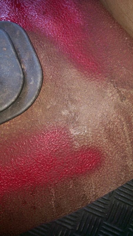

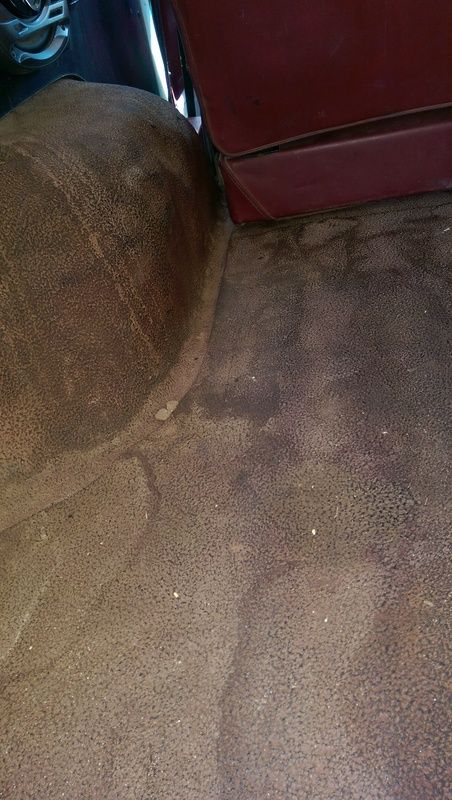

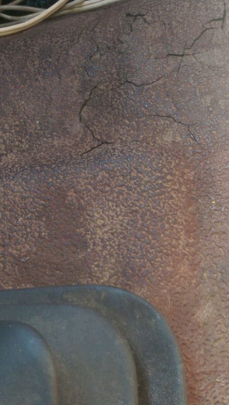

The floor is gross but my cheapness won't let me buy a carpet kit so I pulled it up, no rust<be> I super 77 it back down and am using 3m under waiting to cover the cracks. I'm almost done cleaning and repainting it with vinyl paint I already had in a similar color to the OG red
Test spot here. It looks okay.

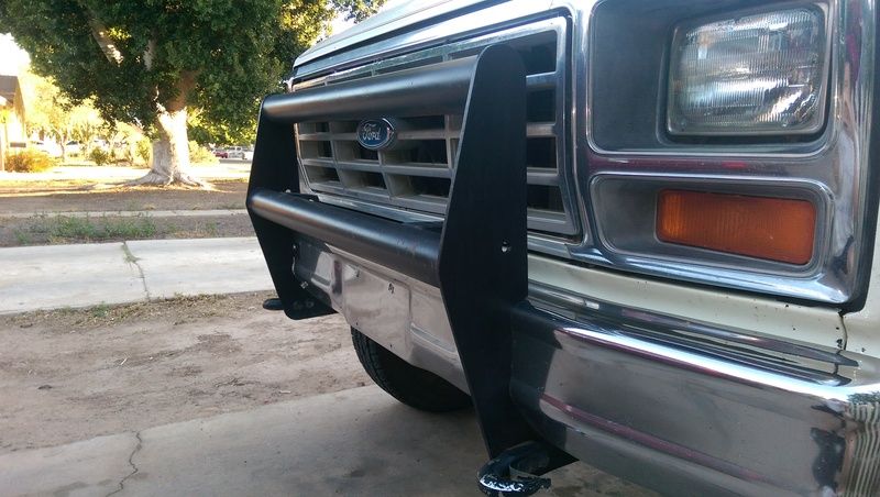

I already pulled all the 80s jc Whitney accessories off.
Goodbye push bar and tow hooks.
<BR>
It was tough looking. Bit ugly though
No more spare holder either
<BR>

I actually like the push bar. That truck looks brand new if you ask me! I'll be following this one.

Cool truck! It's very close to being my 84's twin! Only factory differences I see are mine has black trim on the rockers and a bench seat and I don't have a tach. Same base Bronco version with vinyl floor mats. You'll like it - I'm having a blast with mine.

Very nice find disturbio! I like it. Thanks for sharing 'er with us and keep us posted on your progress.

Good looking rig, I like the push bar! 20 years ago I would have tossed it, but love period correct bolt ons now...

I don't hate it, if it were a little less massive. I know I'm probably alone on the subject but I always preferred 80-86 ford front and the push bar certainly hides a bit of it.
[URL=http://s8.photobucket.com/user/CTMALES/media/IMAG3335_zpsi1wxiqdl.jpg.html][/URL
VS.
I prefer the cleaner look

I prefer the cleaner look too!

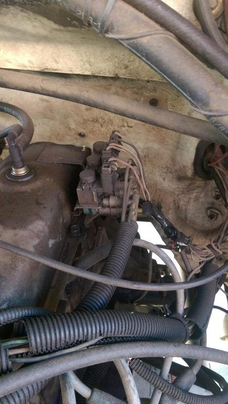

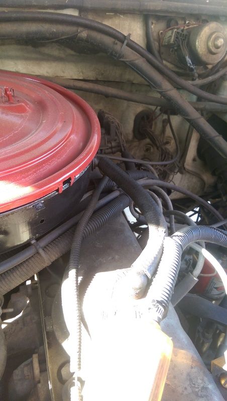

Mine doesn't show good with the air cleaner on it. Here's one I swiped off the net. It's an earlier version, but I think it will give you an idea what to look for. Where the blue hose comes off the top left side of the valve cover is where the PCV valve is. This one is straight metal where mine and probably yours is a plastic 90 degree ell (mine has a smaller connection also). You can see where it ties into the manifold for vacuum. On the other end of the valve cover is the breather cap. You can see the 90 degree fitting on it. That should have a hose connected to it that connects to the breather element in the air cleaner housing. If you have an aftermarket air cleaner, you could use an aftermarket breather cap without the hose connection that has holes on the bottom side where it would draw air in.
It's hard to see, but if you follow the hose from the PCV valve, you can see where mine was originally connected below the carb.
HTH, if not I can take my air cleaner off and get a couple better pics. Or if someone else has some, please share!

I think mine may be all hooked up but I don't know what the PO cut off. Lots of Rigery here. Something went on the air filter to the snorkel too. I haven't seen a stock set up bit I have empty holes and cut wiring everywhere. My brother said I needed a duraspark set up, bit when he saw the truck he said what the PO did was similar. I know the carb is a stock 1 Barrell because I can see the part number on it... who knows really
She runs well.... makes me apprehensive and scared to mess with it

I can certainly agree on the 80-86 front. By far the best bodystyle for the Bronco IMO. I have a love of period correct mods, but seeing both pics, I kinda have to agree it looks a little better without it.
