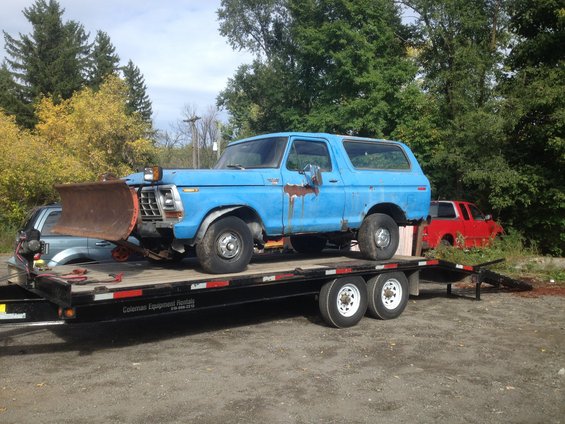

Here we are hauling it out and dropping it off.

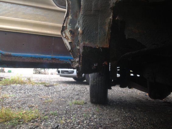

Now we begin to assess the depth of this undertaking. Below you will see the tailgate :)
This is only the beginning, but we will get back to the tailgate at a later time.....I haven't even tried to drop the glass and open it yet.

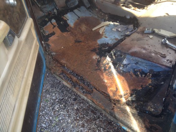

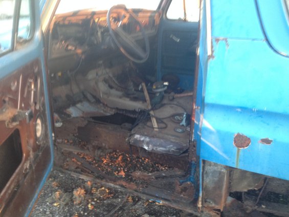

I pulled up some of the carpet behind the front seats at the foot of the back bench.
Pulled up more.
Some of the rot on the door frame:

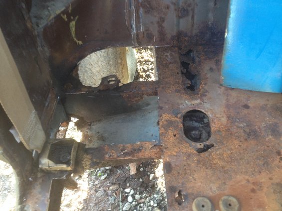

Pulled up the rest of the carpet to find this:
It looks as though there has been some slight repairs to the floor in its past life. And if you notice the rockers on the drivers side.....oh yeah you cant because there is nothing there!!!
The drivers side seems to be the worst of it all.

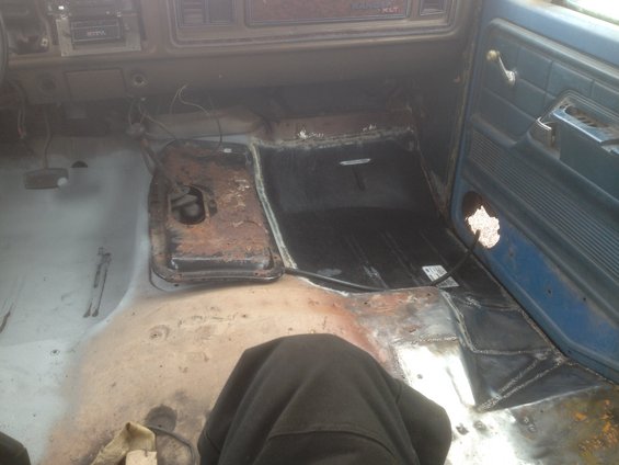

After seeing this lack of rocker on the drivers side I decided to open up the bondo ridden fender, just behind the cab and looked down what was supposed to be the inner rocker. This exposed the fact that the cab support rails out to the rockers were rotted as well.
So I decided to open the floor on the passenger side to expose those support rails. By doing this I was able to verify proper dimensions to fabricate new ones for all four extensions.

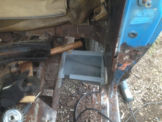

Before I continue, I would like to explain that I am doing the following repairs before removing the tub in order to maintain proper support of the cab structure. I had feared that trying to remove it off of the frame while in this current status would result in unwanted twisting of the tub.
I did not get any pics of the fabrication process other than this one of the inner rocker panel:
In the picture below you will notice that once the rusty old repairs were removed there really was nothing to work with or from:
I was certainly glad I had the passenger side to work from, I was able to do this:
and this:

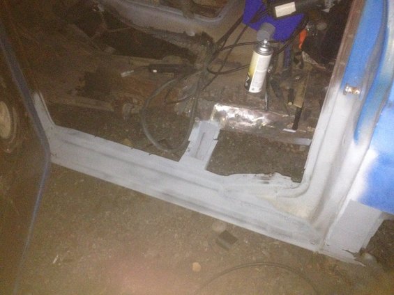

From there I had slapped a few pieces of sheet metal together, somehow it formed this:
And after a few more hours.....quite a few more hours, it turned out like this:

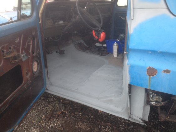

And that is the drivers side done in respect to structure. There is still a lot of cosmetic blending and filling before it gets its final prep and prime and paint!
One foot in front of the other. Every day is a new task, and the final result inching closer.

The passenger side is complete:

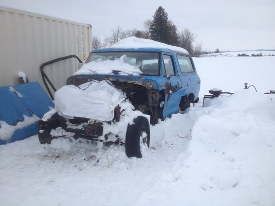

Some time before Christmas and before the snow flew I decided to get the Bronco ready for tub removal. I had a bit to go from where this was last left off and decided to start with the fender removal:
1979 Ford Bronco 5.8l 351M Currently Under Construction

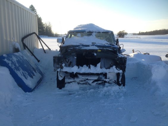

Well, I am not sure if you can tell from the clouds in the last picture, I did not have much time before the snow came. I had spent a day or two (coffee and lunch breaks) digging it out and got to removing a few more things:
As you can see the hood and inner fenders were removed, along with the GT bar. The GT bar was actually dismantled a long while back, it was just sitting in the rear of the Bronco while the front metal was being redone. I have someone trying to talk me out of re-installing it, but I'm kinda stuck on it, It gives me extra piece of mind when one of the kiddos is back there.
