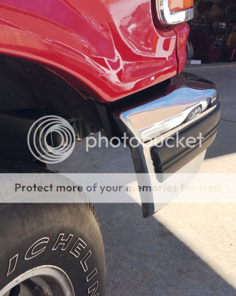

Installed some Moog824 front springs and it raised the front up 2 1/2"s. See picture.

only because you asked, i think the red grille looks odd with the chrome headlight bezels. should have painted the bezels or have the grille and bezels chrome.
Looking good, of course im partial to red, it reminds me of when my 92 got painted a few years ago. Have you got the valence for the bottom of the front bumper?
Mine didn't have one, once I installed it the front end looked alot sleeker IMO. :thumbup
