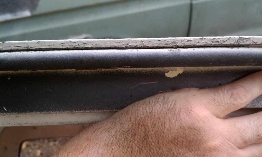

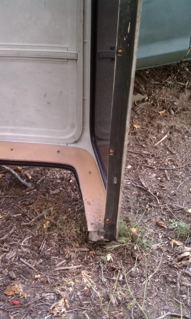

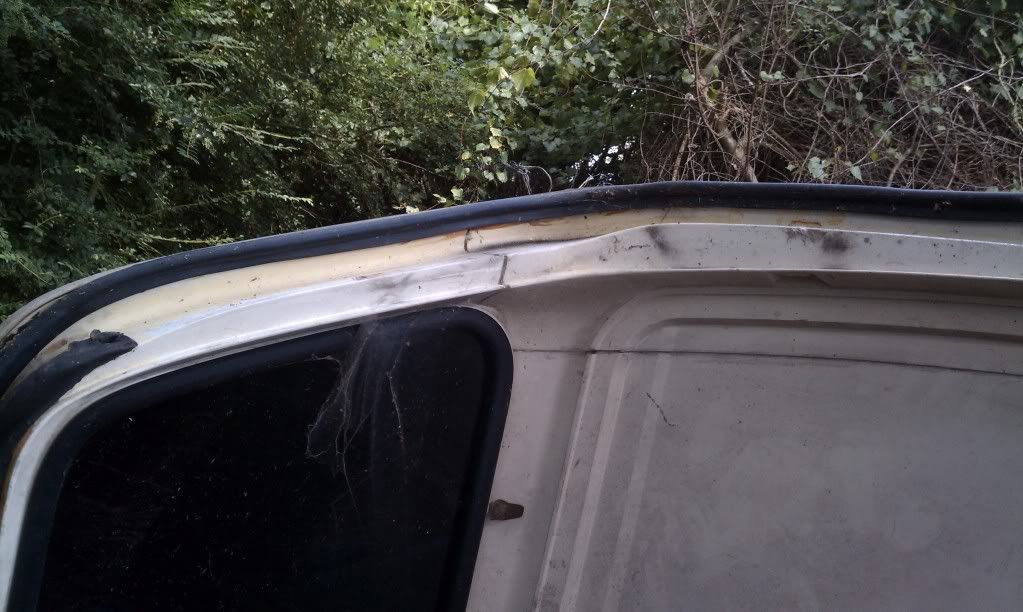

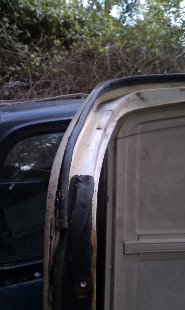

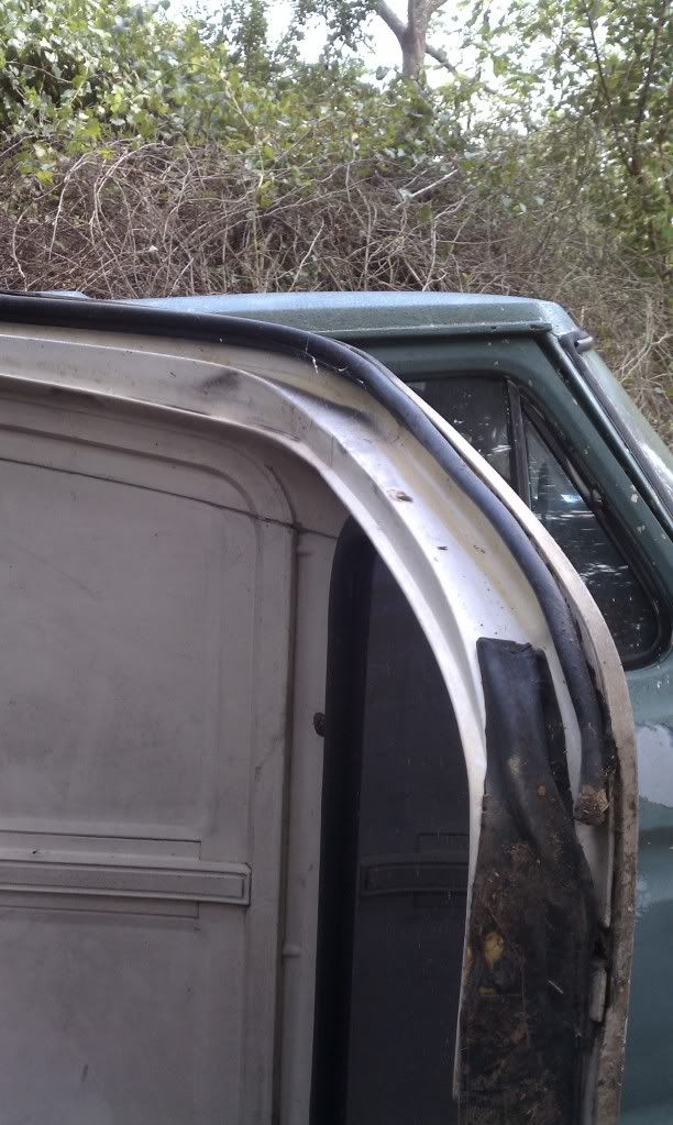

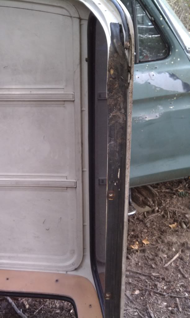

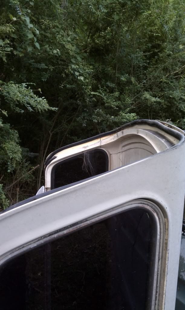

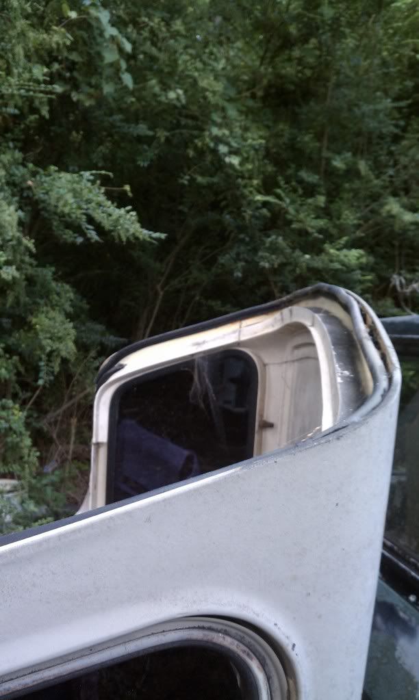

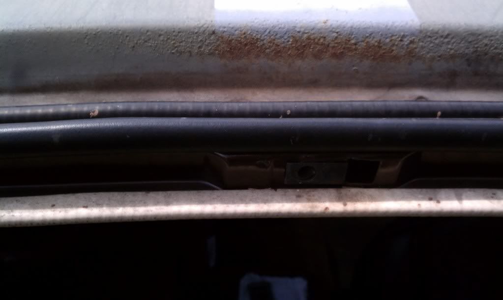

I've searched and haven't found any information, does anyone have any photos of how the weatherstripping for the top is installed?
The long quarter panel to top pieces are self explanatory, it's the two pieces along the front leading edge I'm having trouble with. It appears one piece is attached to the body of the Bronco, and the other is glued to the top itself. I'm having a hard time figuring out the proper orientation.

I've got the top off of mine right now Lance and will try and get you some pics to go off of. Weatherstripping was in place on mine when I got new ones so I had a reference to go off of. However I'm not 100% sure it was factory installed obviously.

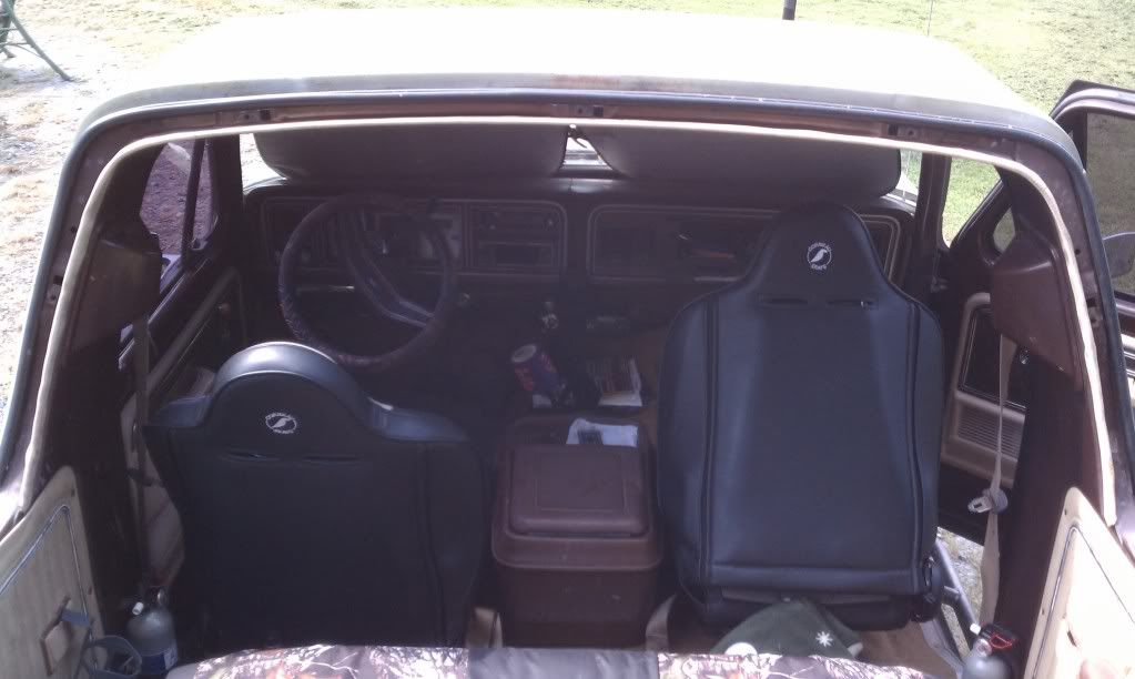

Pictures as requested. Good sticky adhesive is required for this stuff. I've found that every year I take this thing off I always have to reglue a section or two. Of course when you leave on the ground like I did this year certainly doesn't make it any better
Truck
I hope these help.
Rick

Trade you seats?
And I think you can probably lose the windshield shades now. They're probably not doing a whole lot anymore.

Keeps the seats cooler. That black is smoking hot this time of year. Those seats are awesome let me tell ya.

Fantastic, thank you very much! That answers all of my questions perfectly, and also reveals that I'm still missing one piece: I don't have the vinyl that slips over the inner seam on the top opening (white, in your case). I'll have to source some of that.
Now that I know which body seam that double piece goes on, and the correct orientation, I can get that one installed tonight.
