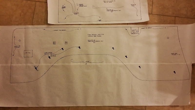

Originally Posted by speedyweasel View Post
Finished... check this out.
I put a scale on them since I don't have a flexible measuring tape. You have to remember that the scanner they're going to use is a slit-scanner, not a platen scanner so the measuring tape would have to "feed" through it like the top of a copy machine.
Anyway -- I had a factory Ford door panel with the P/N D5TB-1023890-AW-RH.6 molded into the back, so I used that. The mounting holes in the plastic were shot to hell so I drilled clear through the panel where the original holes were and made a mark where the screw hole should be on your panels. The window crank hole was a bitch to make round, so I made a mark dead center and noted beside it the correct hole diameter since the drawing was wavy.
I also had a lower door panel that isn't found on every truck, but that one had lots of holes in it that were almost certainly not factory. I marked the ones I could tell were original and put dots where the extra(?) holes were.
All drawings have a scale indicator on them, as well as notes on what holes do what... except the two perfectly round ~1" holes on the rear panel -- anybody know why those are there? They were upholstered over at the factory, never punched so I don't know what they are.
Did what I have the tools to do. Hope it works out for you guys. I'll go get them scanned tomorrow or Friday. Spent the better part of 4 hours on these three little templates between stripping the upholstery off and making my notes all over them.
Oh well. It's for a good cause. The first guy to use them owes me pictures of his handiwork.

I just emailed the DXF file to my laser-cutter. I'll post pics once they're done, (and likely donate), and show pics from the install.

Another update, they will be done with the laser cutting tomorrow or Friday. I will Post pics once I have them. Came to $70 for them to be custom cut out of aluminum.

What thickness aluminum did you use?
Hillbilly Heaven is offline
post #160 of 161 (permalink) Old 02-08-2017, 02:55 PM
Join Date: Jan 2017
Posts: 17
16Ga.
I figure it's so cheap, if it doesn't work, I'll tweak it and have them re-cut it.
