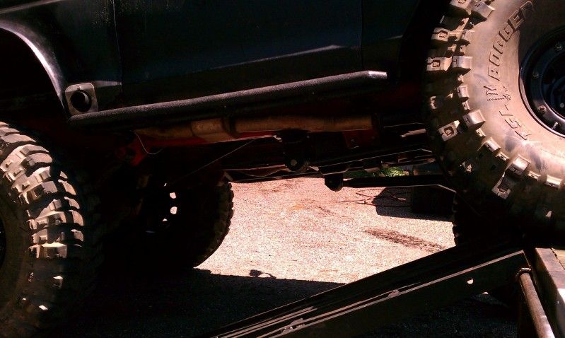

Join Date: Jan 2017
Posts: 17
Dumped in front of the rear tires. Flowmaster 40s. Sound great.
sk1nw4lk3r is offline

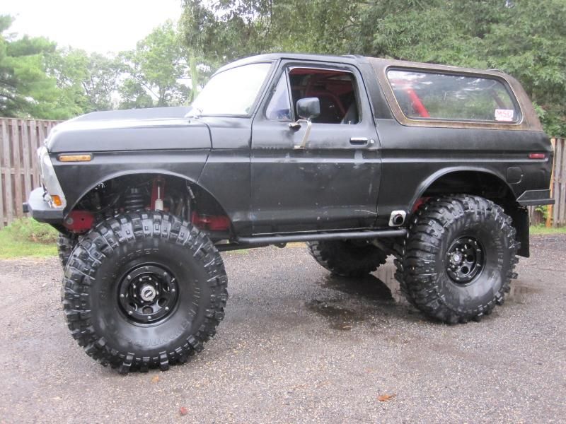

post #12 of 30 (permalink) Old 01-31-2017, 05:25 AM
bonsai dave's Avatar
Join Date: Nov 2006
Location: Odenton Md.
Posts: 611
Bronco Info: 79 with a 460 dana 60's rear 35 spline full spool. front welded with hidro asst. 9" of lift on 44 bo
Fender well exit headers makes it pretty easy to dump the exhaust in front of the back tires.
Sorry to break the line of discussion but wow. The paint looks great. is spray on bedliner or rolled on or what.
