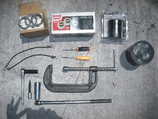

Tools Needed:
[IMG][/IMG]
1. Warn Premium Hubs
2. warn auto-manual install kit
3. T25 Torx bit
4. Lug wrench (I use a 1/2" breaker bar and socket)
5. 90 degree pick
6. 4wd wheel bearing locknut removal socket (performance tool w1269)
7. small bungees
8. 11mm socket and driver
9. ford bearing grease
10. Flathead screwdriver( not pictured)
11. snap ring pliers (not pictured)
12. small pry bar (I used factory tire iron)
13. Large C clamp

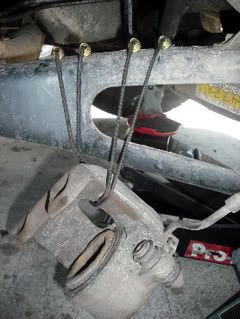

You'll need to secure the caliper out of the way. I used bungees and the radius arm.

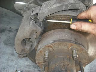

if the caliper gives you trouble coming off use a flathead to gently pry between the pad and rotor. This compresses the caliper a bit. you wont need to compress it far to free it.

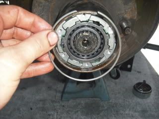

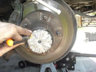

You will need to locate the the outer hub assembly retaining ring and pop it out of place. This can take a min. I used a 90 degree pick. sliding it under one of the edges and then working it around till the ring popped out.
[IMG][/IMG]

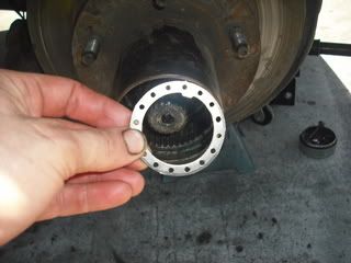

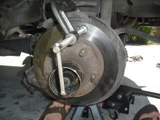

Next slide the outer hub out (the torx screws make great handles for this.) exposing the inner part of the hub assembly. you'll have to remove another retaining ring, and a washer. now the inner part of the hub assembly should slide right out.
Theres one more retaining ring behind that and it secures the top hat lock nut in place. remove that. i used the the same locknut tool to remove the stock locknut. it worked though its not the proper one for this type locknut.
once you remove that now is a good time to check and repack your bearings. if you use the locknut tool as a punch and lightly tap the inner bearing out the back, you can reuse the seal. heres a pic of what i mean
[IMG][/IMG]

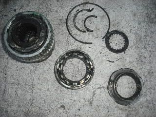

Heres everything removed

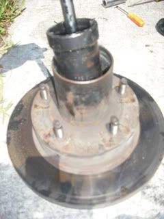

I found that when reinstalling the hub and bearings it helps to hold the rotor in place with a large c-clamp with only light pressure.
[IMG][/IMG]

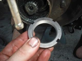

Start with the locknut that has the pin on it. screw that on the spindle, pin facing out. youll want to torque it down to 50ft lbs while rotating the rotor back and forth to seat the bearings. once tight, back it off a 1/4 turn
[IMG][/IMG]

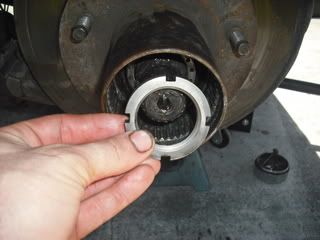

Next will be the lock washer. it is keyed to match the grove in the spindle. it is important to line it up properly on the pin. flip it over if it doesnt match up. this will change the offset allowing it to line up
[IMG][/IMG]

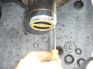

Making sure the hub dial is in the free position install the cover and test to be sure its working properly
[IMG][/IMG]
