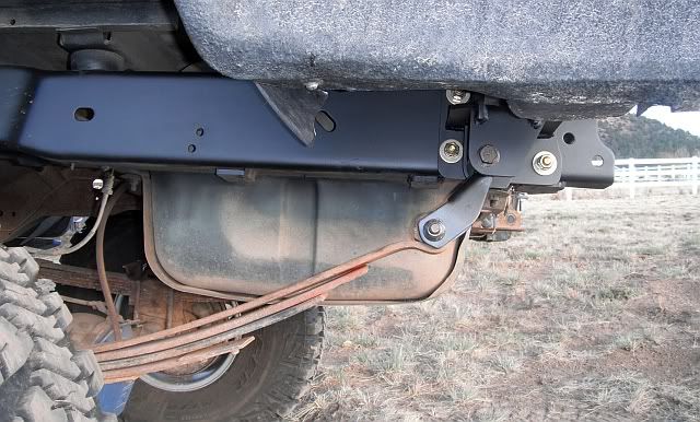

The Brackets from Hefty seem very well made. I wanted something else in the picture for reference.

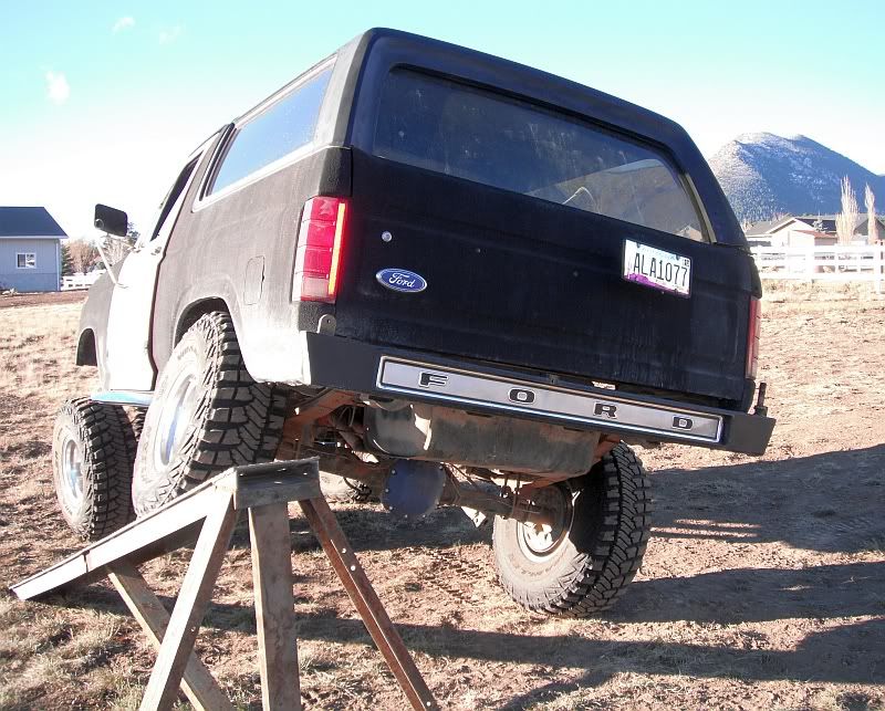

Here is my truck on the ramp before I built my coil retainers. You can see the driver's coil out of its bucket in the first pic. It sure helped with flexing though!

Here is a pic of the driver's rear, my best result:
I can't help but think that I have some binding going on limiting my rear droop. Here is a crappy pic of the drivers side shackle binding against the hanger on the ramp. I was hoping to fix this with the kit:

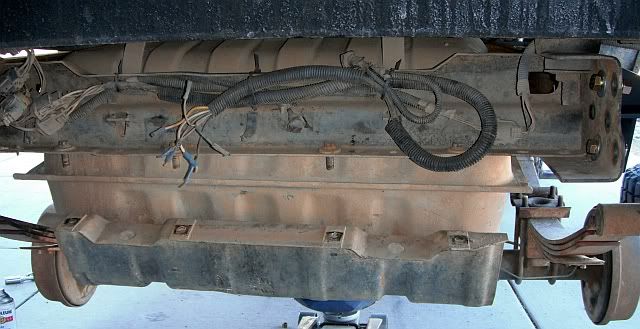

Another word of advice I have is to lower your gas tank. I read many threads on here where people got creative and didn't need to do this to mount the brackets but I don't get it, it was 4 bolts. I don't know, maybe not all Broncos are the same but I took 5 mins loosened these 4 bolts and was able to lower the tank a good 4". I am a medium / large size guy and this gave me the room I needed to sneak my hands in and push the bolts through the frame from the inside. It is just my opinion but the 5 mins was well worth avoiding frustration.

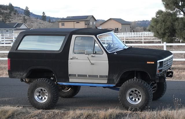

Here is the stance now:
Overall I am happy with the height although I do want to lose about 2" in the rear when I am all done. The disappointing part is that there was really no change on the ramp.

3rd pic from the bottom, your shackle angle looks off...
The shackle is inline with the spring and just has nothing more to give. I didn't gain any droop. I am hoping that removing the block and / or leaves could help with compression on one side but I doubt droop will improve unless I add more length to the system .... longer shackles. What do you tink?
in this pic, if you look closely you can see the shackle is actually angled forward. figure out the difference in inches between where it's at now and what it needs to get to about 45* back. then move the front spring hanger back that far. that'll give you more droop and flex.

Yeah, you guys are both right on. I had read where people were moving the front hanger back in order to recenter the wheel and didn't plan to do that. But, it is clear now that there is more to it then re-centering, there just isn't enough 'slack' in the system.
Tonight I plan to pull the block and remeasure everything, I will move the hanger too but that will likely be Thursday while I wait for the bird to cook! I am still contemplating the longer shackles in the near future. Any thoughts on removing a leaf? This Bronco is only a weekend warrior and I don't tow anything with it, I kind of like the idea of a softer more plush ride.

Yup, fix the shackle angle and a little bit longer shackle will allow for more travel.
