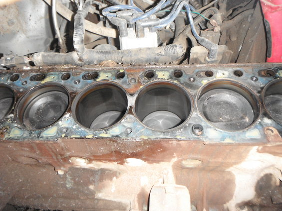

see any head gasket issue here???
no doubt there was a problem here.

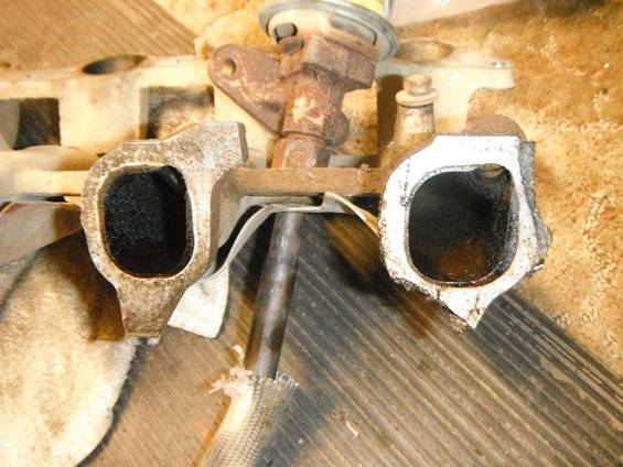

pulling the lower intake discovered two hold down tabs on cly 6 to be broken. Going to see if I can get it welded reasonably. but I do have an out if that fails or is cost prohibitive.

well I got that intake welded up and it was only $50. I can get a photo later of it. the head is waiting to be picked up on Monday afternoon and while there I had a valve job done on it just because it was off and at the shop. There is time for motor mounts and other little junk to get done in the meantime waiting for its delivery.

picked up the head at the shop. Know why the gasket failed...warped head. Valves were great, but still put in the new seals and lapped them. So I'm glad I didn't get impatient and throw it back together.

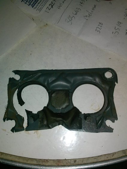

since I'm dragging my feet to go to the garage tonight...I think I "may have" discovered a potential air leak that could possibly led to the high idle.
Never seen a Throttle body gasket look like this. Or any gasket look this buggered up.

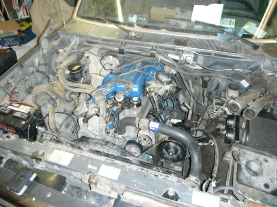

Then there were some random photos from the repair and of repairs during the repairs...
Afters
Before

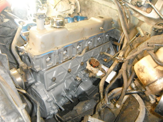

side cover gasket replaced...and painted since I wasn't at it and it was clear.

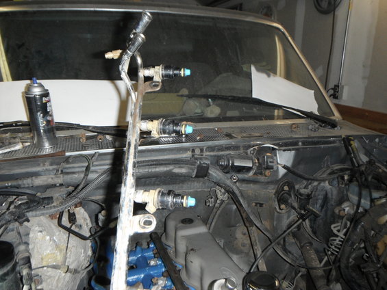

did the injectors...cleaned and resealed. not overly difficult or time consuming.
Yeah....painted most of the engine stuff while I was in there. Looks better, even if it doesn't run. Complete except for the hood install.
Just figured to update the photos to this thread because I had them.
