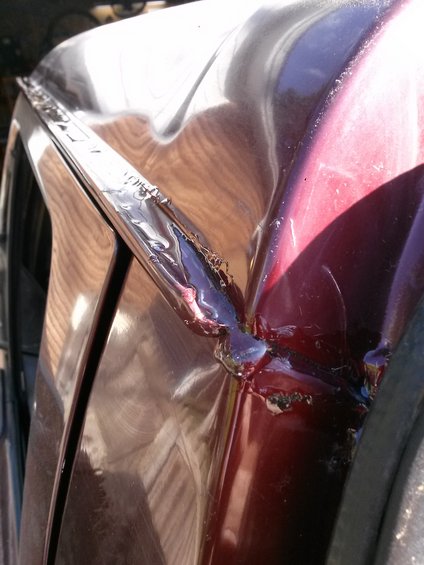

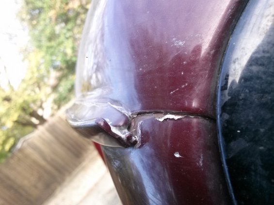

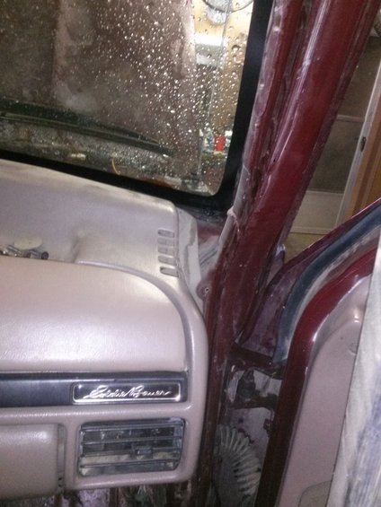

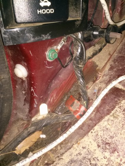

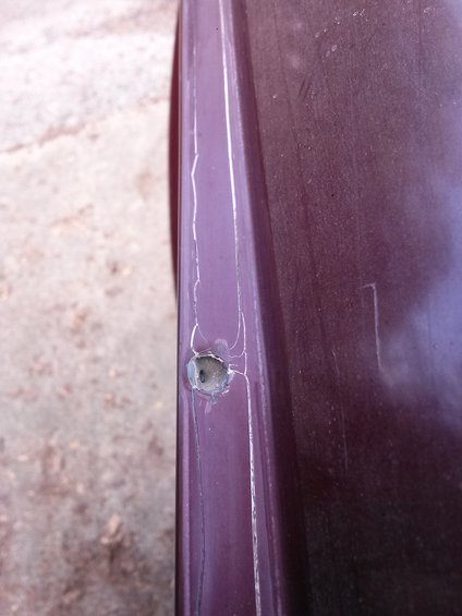

i've had my bronco close to 2 years now and have had leaks the entire time. since i live in texas we don't get THAT much rain usually, so i just park in the garage when it rains and i remember.
the leak would manifest itself as water in the door sill. what threw me off, though, was that it usually took a pretty good rain to leak. and sometimes it would leak towards the front of the cab and others it would be towards the back. i still don't rule out my windshield leaking but i think it varied because maybe the way i was parked (the angle of the bronco when it rained)
for a good while now, i've had the interior panels stripped trying to see where it was leaking. over the summer with the top off, i noticed a pretty good tear/hole on the drive side window drip rail. today i had some time and removed the interior panel behind the seat belt. it was an "ah-ha moment" for sure. and for the record, i'd looked at the drip rail before but hadn't seen the worst part because it was covered by the camper shell. and, really, i didn't think it looked that bad. but, obviously i was wrong.
i have researched and seen a couple options.
1) permanent fix - cut apart the body, do some welding, reinforcing, and painting.
2) semi-permanent/long temporary - silicone, rtv, or some other flexible sealing agent.
i prefer a permanent fix but don't have the time to do it before winter. so, i'm hoping for a very temporary solution that will last a few months. then, in the spring/summer, i'll either go with the semi-permanent fix or (hopefully) the permanent fix. i used 1" wide gorilla tape.
here are the pics.

well... it should buy you some time anyway. I'd bet my white '90 has similar cracks. damn floors always wet and obviously led to the cancer spot at the bottom corner of the body, by the rear of the pass. door. at least you caught it.

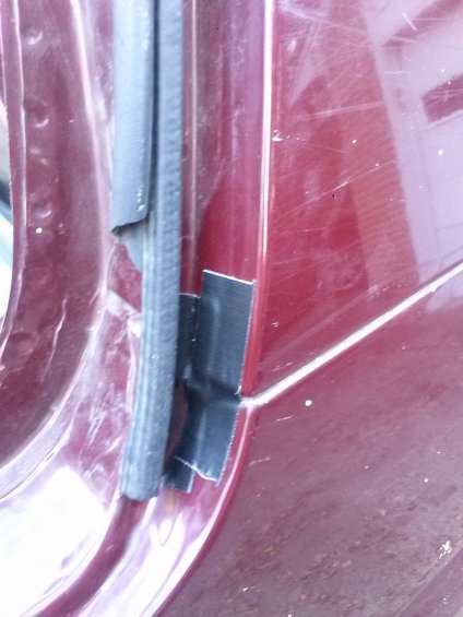

I dig the gorilla tape fix...you'd fit right in down here...
yours isn't all that bad, now, but you're still going to have to dig into to it to fix it right. will mean pulling the trim from the inside cutting holes and reinforcing the corners of the drip rail from the inside. you're going to need to grind out all the old seam sealer, weld up any holes, then re-seal it..
it's time consuming to do it right. I've got a bunch of pics on supermotors that detailed my work..granted I wasn't overly concerned about the quality of the paint..just wanted to stop any further rust. that wa a little over two years ago and I'm getting ready to have to do it again..
If you're not running a soft top it should last longer..
1992 Ford Bronco Body Work and Rust Repair including drip rail R&R pictures, videos, and sounds | SuperMotors.net

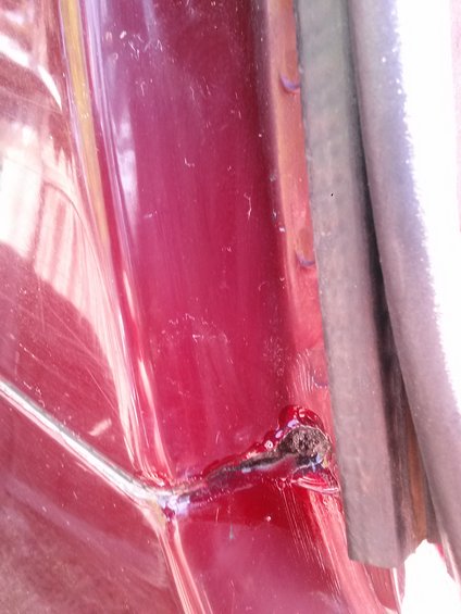

alright, well i gave up hope of getting these rails repaired properly in the near future. with that in mind i broke down and bought the 3M clear auto sealer - 08551. i did the drip rails and where i saw cracks in the sheet metal at the end of the seams. i took a couple other pictures but they didn't come out properly.
the 3M stuff went on great. not too runny except a couple spots. i did it yesterday afternoon. this morning the seams were pretty firm. i am going to touch up a couple spots in a day or two.
one note - i did notice that there were air bubbles along all of the cracks. it's particularly noticeable on the drip rail. is that normal?

looks like that will do the trick until you can get around to a more permanent fix..as far as the air bubbles on the drip rail I think that's pretty common, as long as it's not rust. If I remember correctly mine had them too..I'm sure that sealer was slapped on there when they were on the line and no one worried how it looked..

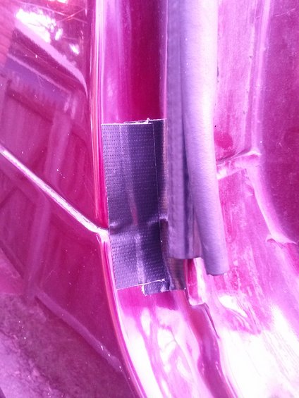

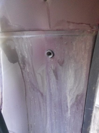

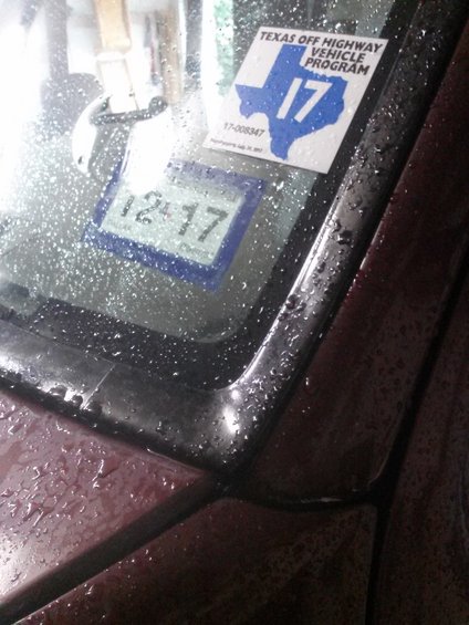

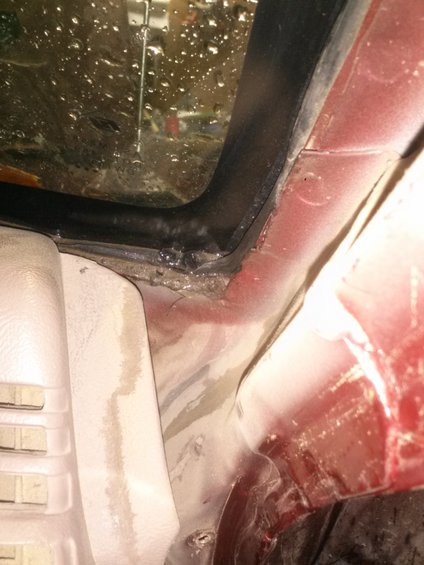

well...a little update here. the truck still leaks on both sides. i knew the windshield on the driver side leaked. i determined this weekend that the passenger side also leaks. i took some pics to show you what i'm dealing with.
because i've FINALLY confirmed that the windshield is leaking on both sides, i decided to go ahead and reinstall all my interior trim. i've had the kick panels in my attic for probably a year and the pieces behind my seat belt were off since last fall.
for now i'm just gonna let it ride since it's not a huge issue. however, i think i want to get the windshield professionally removed and reinstalled. there are no chips or cracks in it, so no need to replace it. i have called a few folks and it looks like it'd be about $100. i'm just reluctant to gob more sealant on it. it just seems like it'll go right back to leaking in no time.
this is the passenger side
and then the driver side
