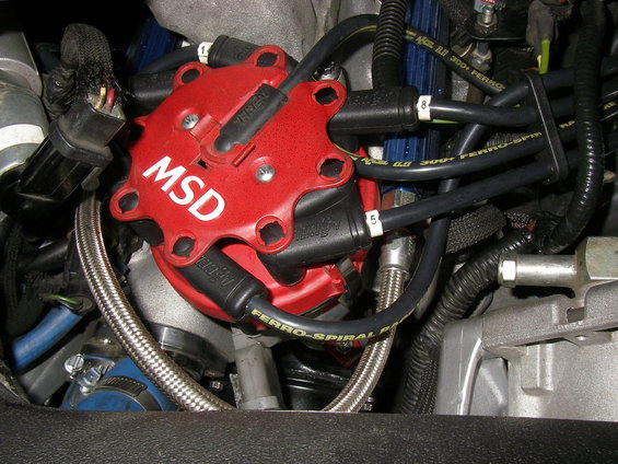

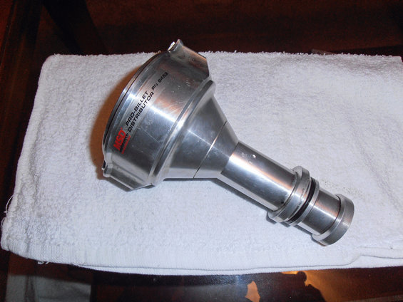

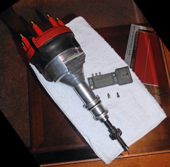

Bronco Info: 1990 EB FSB, MAF, 6.7L, E4OD, 4" Rancho, 4.56, 33" on 15x10 Alcoa's
The engineering and milling of the MSD Distributor body and shaft are excellent. This has proven to be a positive performance upgrade in my roller cammed 408 6.7L. I even have one in my stock F250 5.8L. The only questionable components that I have found is the MSD supplied TFI ICM and the MSD Coil, which I replace with a Motorcraft parts.
Mechanically, I think the MSD Distributor is well engineered and constructed. I am pleased with their caps and rotors as well. Also, I have returned old damaged MSD Distributors and received a complete rebuild for a minimal fee. Came back like new for a fraction of the cost.
