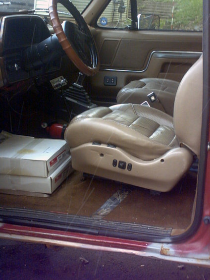

Another Explorer seat convert here! Hardest part was drilling the holes and leveling the seats so there was no binding.
i got a set of those seats as well waiting to be installed. any tips on instillation and to get them to work correcty? its for a 92 eb but i do not think that will matter.
Only one hole lined up for me, so I had to drill the other three. I did bend the front bracket a little to get it to contour a little better to the floor. Also, I would attach the front two bolts first, then drill the rear and shim level as needed. Other than that, it was pretty simple. I also put in a separate fuse block for the seats and my CB so I didn't have to run too much wire or tap into another source.
