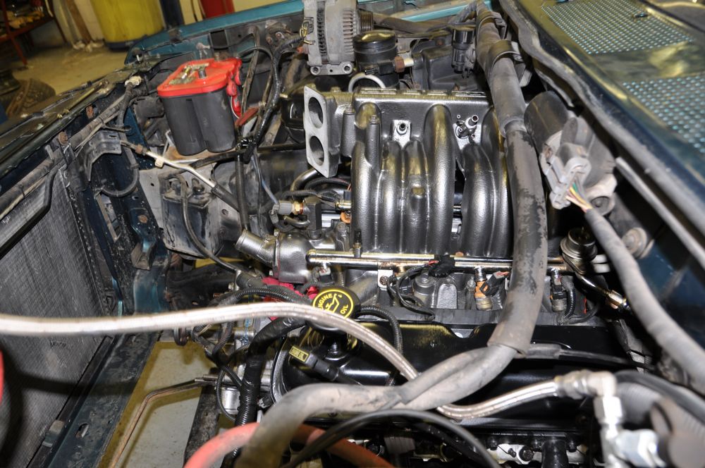

Bought this fuel rail from Summit for 13bucks, going to use it for my oil gauges - the factory sensor and the aftermarket gauge.
Going to place it some wheres in this area on the right there, using a braided line with AN4 fittings to go from the engine block.

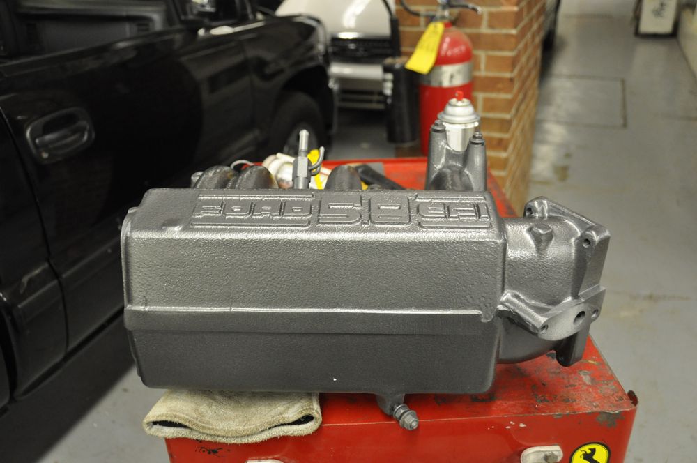

Cleaned the upper intake and gave it a coat of paint, nothing fancy just to help clean it up.

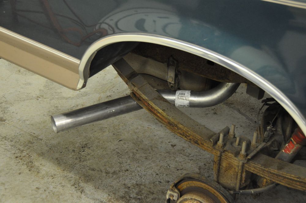

Installed the M30001 tailpipe, decided to go new instead of reusing the rusty old one.

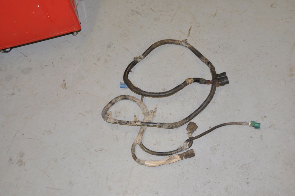

had to change some harness for the O2 sensors, on the 5.0 the sensor hookup for the left and right O2s are on the engine harness, on the 5.8L they are in 2 different harness. This harness controls the transmission and picks up the left 02 sensor and the rear O2.
Took me a while to figure out where the right O2 sensor hooked up to, must have picked up the battery cable a dozen times in my search till I noticed it.
Left of the picture is the hookup for the right O2 sensor, and yes to the right is the start hookup. Pretty wild isn't it?

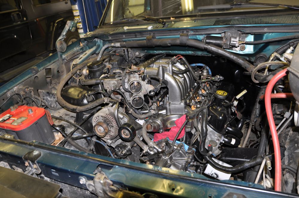

This is where I started this morning, the upper intake was on but not tighten.
Little more progress, I used the throttle off of my old engine as I knew it worked good and needed little cleaning.
Heater hose runs differently on the 5.8 and I had to shorten one, no biggie.
We primed the engine oil with a drill, 70 PSI! wooo
Here she is out side running!!!!
Rockers and lifters didn't sound all that great when I first started her, and she started right up to, I could not have had the timing any better - lucky. One she ran for a bit she quiet right down. The roller rockers are a bit loud, kind of a sewing machine sound.
Engine does site higher with those mounts and I'll have to raise the shroud a 1/4" - kind of got it rigged with zip ties right now.
