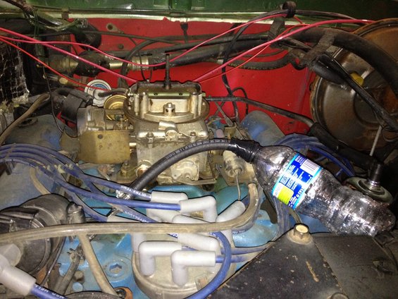

Put the pickup line into a container of fuel and crank it over, checking to see if the pump is actually working. If it is, you may need to run the engine by pouring fuel down the carb long enough for the pump to build up a fuel supply from the tank.
However if it's been sitting for THAT long, stop wasting time and just drop the tank. Clean the tank and sender. Blow the lines out with compressed air and put it all back together. It's not that hard. just a few bolts and some wire connectors.

odds are sitting for many years the fuel pump is bad, you could try putting a ballon on the end of the hose to see if the pump is pumping air, if there is no movement, then you need to replace the fuel pump

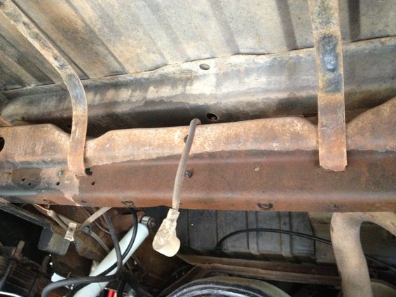

Stunk up me and the garage. I took a pic of the two lines going to the tank. I'm assuming I will need to remove the fuel sender line using the special disconnect tool? The return line has a rubber hose that i can just cut? I removed the filler neck too. Now, can I just remove the bolts to the skid plate and drop the tank with the fuel sender line still connected or do I need to do that before I drop it?
grovermyson is offline   Reply With Quote
Old 02-16-2013, 05:24 PM   #9
huck2080
huck2080's Avatar
Join Date: May 2011
Location: norfolk va
Posts: 194
Bronco Info: 79 bronco 460 c6
supply line and that wire is for the sending unit , no special tools needed unplug the sender pigtail , undo that hose clamp , work hose off or if replacing cut it , undo filler hose on the tank side , take out all the skid plate bolts , and lower it down slowly and even so fuel doesnt get all over the place ,

So that fuel connection on the left (solid red arrow- above pic) how do you disconnect that?

It just pops off. Grab ahold of the top and lift up. The tricky part will be getting it back on. I just did this last saturday had to use my left hand to line it up place it back on (I'm right handed). I would replace that line under the white arrow.

OK thanks. I thought that was a rubber line like the one on the right because everything was covered with dirt and grime. Ill remove it tomorrow before i drop the tank.

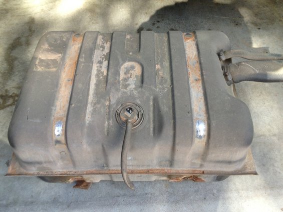

Took my time today and got the tank dropped. Incredible amount of rust between the bottom of tank and skid plate. I think the lower straps completely rusted away- if there are lower straps. Question about the straps, I see there are upper straps but don't understand the purpose of the lower straps since the skid plate holds the tank up. What do the lower straps connect to? There should be rubber insulators between the skid plate and bottom of tank - correct?.

Not necessarily... I drained a customer's tank just because she wanted new gas after leaving the car for ~3 years. So I used her in-tank pump & old filter to dump it from her car (on the lift) into my CV (which I drove in under hers). I changed her filter, refilled her tank, and both cars ran fine. Yes, the gas reeked.
Newer skidplates (which fit your truck) have more drain holes down there. Either add holes, or find a '92-96 plate.
I think the lower straps completely rusted away- if there are lower straps. ... What do the lower straps connect to? There should be rubber insulators between the skid plate and bottom of tank - correct?.
There are no bottom straps with the skidplate - the insulators are what look like rusted straps in the last pic. I prefer to replace them with camper shell mounting tape, but almost anything will work. Someone (maybe Al or Malcolm) used a bath mat.

I've dropped 3 tanks on 78/79 Bronco's and only one had the straps. That was the one with the 25 gallon tank. Other two had skids so no lower straps. You should be able to use straps to hold it up and then skid it. Or do like Steve said and put something in there to act as a bushing. So you don't feel all alone in the world of tank dropping here are pics from mine last week (post 1983). http://www.fullsizebronco.com/forum/...00225&page=100

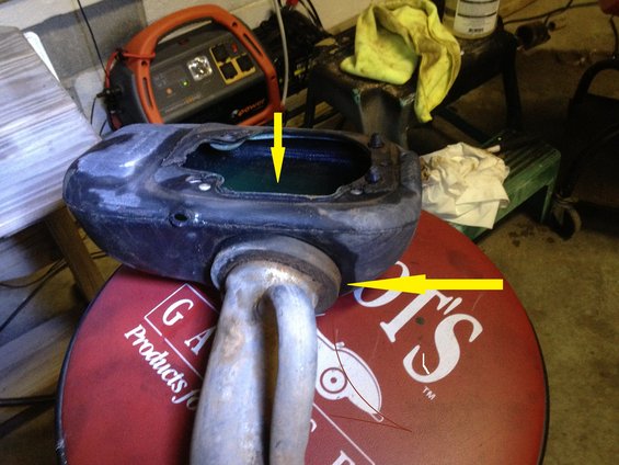

Really appreciate the helpful comments! Just one last question before ordering part's. That plastic housing on the body for the filler neck-I want to replace the inner and outer rubber grommets. They are really dry and cracking. Has anyone done this?

Never replaced either one, BGY has the the one grommet (http://broncograveyard.com/bronco/i-...alve-seal.html) you will probably have to make the other one.
